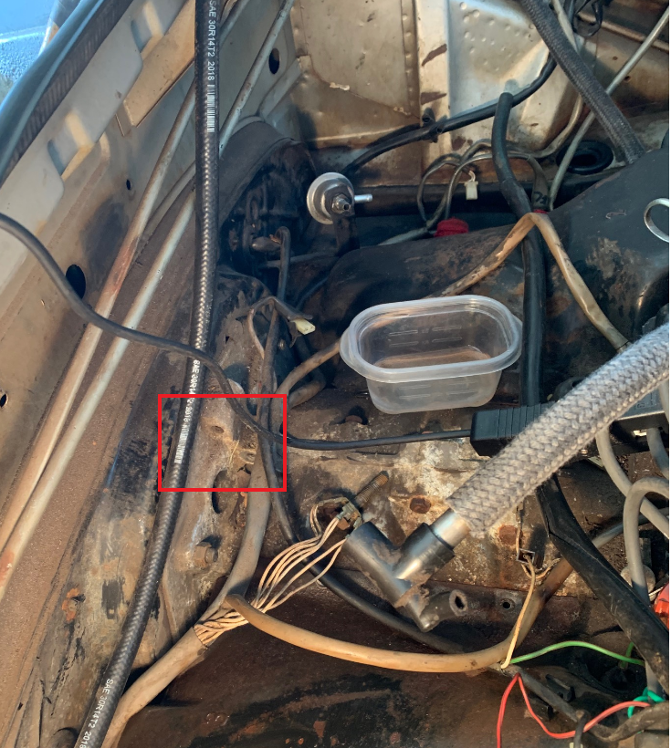

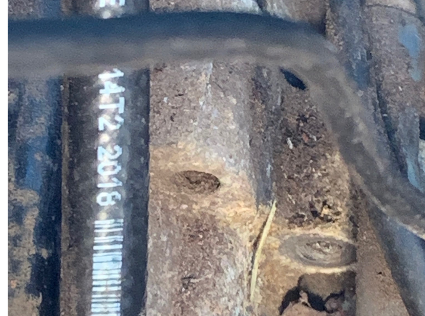

Hi,
As I was chasing a vacuum leak I found a seemingly important hole without a bolt? Is this be design? The bottom hole is where the ground wires are attached - the hole above will assist in holding the Engine Together, could it hurt to add one there?????? ![]() ![]() |
ctc911ctc Bolt Hole Empty? Apr 13 2019, 05:02 PM
Chi-town All the engines I've had there was no bolt. Apr 13 2019, 05:12 PM
jcd914 There would have been a bolt there from the factor... Apr 13 2019, 07:24 PM
bbrock None of the 5 engines I've owned had a bolt th... Apr 13 2019, 07:29 PM
wndsrfr
None of the 5 engines I've owned had a bolt t... Apr 14 2019, 07:21 AM
Mark Henry I've seen some 914 don't have it, but buse... Apr 14 2019, 07:38 AM
ctc911ctc Thanks Mark, I am engineering a small crane for my... Apr 14 2019, 02:41 PM
Mark Henry
Thanks Mark, I am engineering a small crane for m... Apr 14 2019, 03:38 PM
914_teener The gathered white bundle of wire are grounds for ... Apr 14 2019, 12:34 PM
ctc911ctc Great advice - will do - wires are in good shape, ... Apr 14 2019, 02:40 PM
Al Meredith I believe the tophole without the bolt is used by ... Apr 14 2019, 01:00 PM![]() ![]() |
