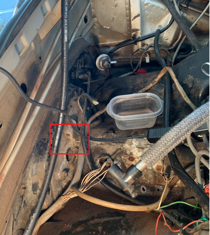

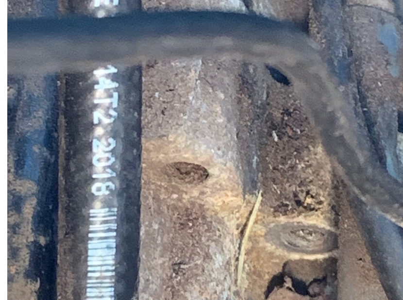

Hi,
As I was chasing a vacuum leak I found a seemingly important hole without a bolt? Is this be design?
The bottom hole is where the ground wires are attached - the hole above will assist in holding the Engine Together, could it hurt to add one there??????

All the engines I've had there was no bolt.
jcd914
There would have been a bolt there from the factory.
Probably not a big deal if it is not there but putting a bolt there will do no harm.
Jim
bbrock
None of the 5 engines I've owned had a bolt there and it always bugged me. The PET doesn't show one there either. I just installed a CSP carb linkage bracket which uses that hole, and the one below for mounts. It doesn't bug me anymore. beer.gif

QUOTE(bbrock @ Apr 13 2019, 05:29 PM) *
Also helpful if you want to suspend the rear of the engine from a crossbar when dropping the trans ....

I've seen some 914 don't have it, but buses do.
I have a bolt in hook for this spot, how I lift engines onto my engine stand with my shop crane.

I believe the tophole without the bolt is used by the factory to put a hook through for transport in the factory.

Just looking at a late 1.7 and it definitely has the bolt, the air cleaner stand is bolted to it.
