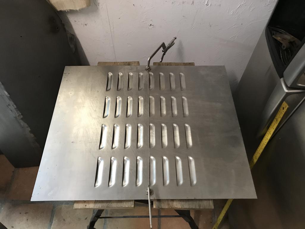

I’ve been meaning to share these pics as a small how to on installing this panel from Patrick Motorsports. https://patrickmotorsports.com/collections/...9146l-vrpan-pmp
A friend and neighbor has a 914 and I installed one in his car and he told a friend about it, except his friend wanted to add more lovers, so sure, let’s do it. Attached Image

The spacing of the louvers is 42mm’s. I cut the front and back panel to weld them together to maintain the 42mm spacing so it would look like one panel. I also joined them this way to reduce the amount of TIG welding required.

TIG welded in. At this point you can either sand down the weld bead with some 80 grit or leave as is and undercoat. If anyone has any questions please ask. I’m all about using forums to share information!
