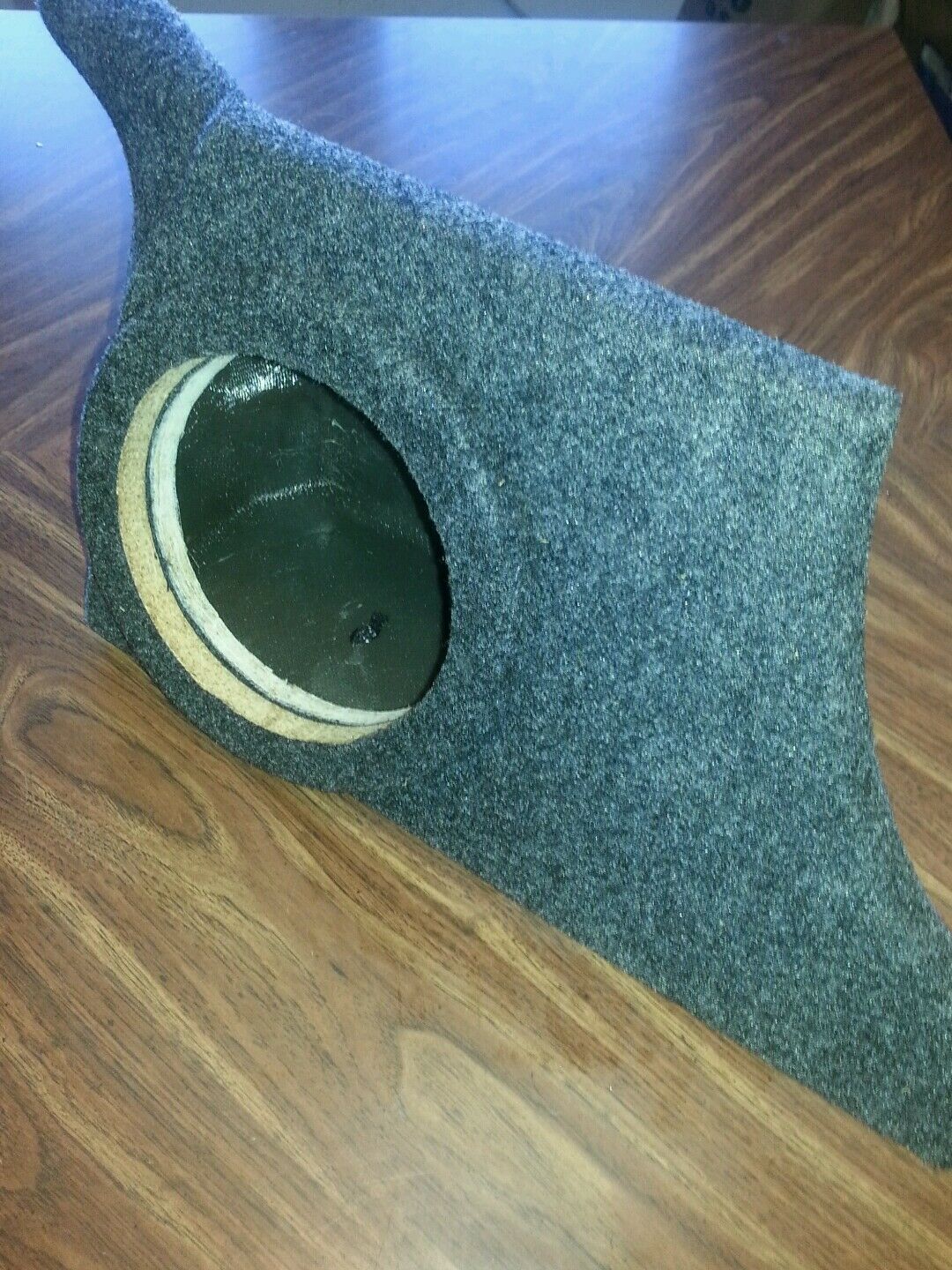

currently have this 8" Polk DVC https://www.amazon.com/gp/product/B073JX8NP...=UTF8&psc=1 ready to go in this enclosure for the front footwell Attached Image

Check that it actually is DVC, 2 pairs of terminals. If so then you will want an amp that can do 1 channel @ 2 ohms as both coils will need to feed from the same signal.
* Not many amps will state they are 2 ohm stable bridged, but my experience has been it works to a point... as in some amps would overload sooner than expected. But then I was minitrucker in a past life so I was pushing harder than an normal person would want to go anyways. (IMG:style_emoticons/default/aktion035.gif)
