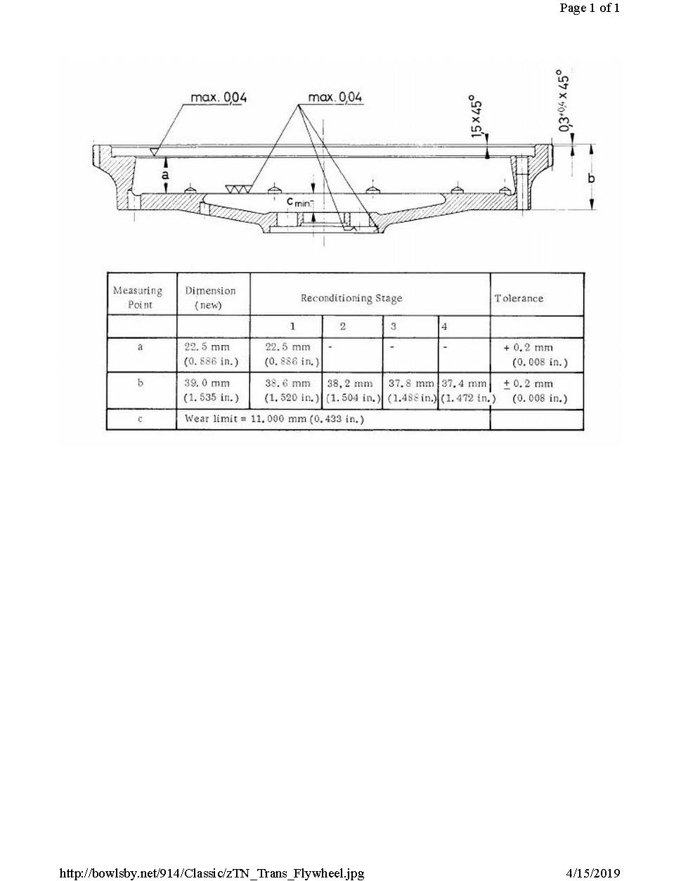

QUOTE(Mblizzard @ May 2 2019, 06:59 AM) *
Not surfacing pressure plate mounting surface the same amount as the clutch surface.
Is grinding the ridges off the flywheel bolts a suitable work around for this? When I had my flywheel resurfaced decades ago, I asked them to surface the mounting hub to match but I don't think they did it. I decided to grind the bolts to be sure I have clearance but haven't run the engine yet. Is that going to bite me in the butt?
Also, it's been a long time, but it seemed like installing the distributor gear was a little tricky.

QUOTE(bbrock @ May 2 2019, 05:35 AM) *
I have seen that done but I think that is due to the removal of too much material from the surface and the bolts extend above the flywheel surface.
If you fail to machine both surfaces clutch slippage will be a problem. If so much material was removed that you had to grind the bolts you might want to look at it again. I grade on a good bad scale. Anytime you have to modify bolts to fit stock parts it is likely bad!

QUOTE(Mblizzard @ May 2 2019, 08:00 AM) *
Whoops! Looks like a misread what you were saying. Yes, when my flywheel was surfaced, they took .027 off the friction surface and a matching amount off the outer ring where the pressure plate mounts. I mistakenly thought you were talking about the center hub where the flywheel bolts to the crank. That's what may not have been surfaced so I ground the ridges on the bolts just to make sure they don't hit the friction disc.
Disregard my question. Carry on. (IMG:style_emoticons/default/smile.gif)

QUOTE(bbrock @ May 2 2019, 07:21 AM) *
This is not something that should be machined down when the flywheel is surfaced.
It is a structural part of the flywheel and should be left alone.
If enough material has been removed from the clutch surface of the flywheel the clutch disc can contact the flywheel bolts.
Really that means the flywheel is past its wear limit and should be replaced but I have seem many the have had the ridges on the flywheel bold ground down to add clearance. I have not seen a failure related to the specific modification.
There is a diagram with the machining specs for the 914/6 flywheel that seems to be the accepted standard for the 4cly flywheel as well. I don't think the bolts need to be ground if the flywheel is kept within the limits in the diagram.
I don't have a copy of the diagram handy or I would post it here.
Jim

QUOTE(jcd914 @ May 2 2019, 08:12 AM) *
Jim

QUOTE(jcd914 @ May 2 2019, 10:12 AM) *
Jim
Ah, Mike beat me to it.
Is this the diagram you reference? It's the one I gave the machinist who resurfaced my flywheel anyway.
(IMG:http://www.914world.com/bbs2/uploads_offsite/uploads.tapatalk-cdn.com-20845-1556818732.1.jpg)
Looking at it again, I may have been misinterpreting all these years. I took it to mean you would have to machine the center hub to maintain dimension C, but now I see it is probably just saying if machining the other two surfaces puts C out of tolerance, your flywheel is no good. I guess the machinists followed the diagram I gave them after all. (IMG:style_emoticons/default/cheer.gif)

is it just me misreading? I don't think dimension "b" is changing with machining. It would amount to taking material off the ring gear.
material would be taken off the friction surface and an equal amount off the ledge that is below b. This dimension is show as "a".
This maintains the same relationship between the friction surface and the ledge surface that the pressure plate mounts. Again this is dimension 'a'.
I see no reason dimension b would ever change. What am I missing?

I was under the impression that 'C' is the minimum. Dependent what C is on a new one there might be room for dressing it down. Do I have that correctly Jeff?

@bbrock
To Brent's point, as long as the 11mm dimension 'C' doesn't go below 11mm you'll have room for the flywheel bolt heads.
I just measured a bolt head and it is 9.2mm from shoulder to top of the head.
