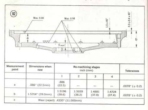

Is this the diagram you reference? It's the one I gave the machinist who resurfaced my flywheel anyway.
Looking at it again, I may have been misinterpreting all these years. I took it to mean you would have to machine the center hub to maintain dimension C, but now I see it is probably just saying if machining the other two surfaces puts C out of tolerance, your flywheel is no good. I guess the machinists followed the diagram I gave them after all.
May 2 2019, 11:59 AM
is it just me misreading? I don't think dimension "b" is changing with machining. It would amount to taking material off the ring gear.
material would be taken off the friction surface and an equal amount off the ledge that is below b. This dimension is show as "a".
This maintains the same relationship between the friction surface and the ledge surface that the pressure plate mounts. Again this is dimension 'a'.
I see no reason dimension b would ever change. What am I missing?
rhodyguy
May 2 2019, 12:01 PM
I was under the impression that 'C' is the minimum. Dependent what C is on a new one there might be room for dressing it down. Do I have that correctly Jeff?
May 2 2019, 12:03 PM
@bbrock To Brent's point, as long as the 11mm dimension 'C' doesn't go below 11mm you'll have room for the flywheel bolt heads.

May 2 2019, 01:45 PM
QUOTE(rhodyguy @ May 2 2019, 12:01 PM)
Seems clear that is correct. I was 30 years dumber when I first read that diagram and simply missed the "Wear (reject)" part of that dimension. Makes perfect sense to me now.

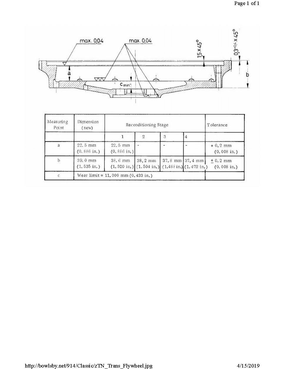

Tbrown4x4
May 2 2019, 06:33 PM
I'm also confused by that diagram. Always thought it had a typo.
I have an NOS 4 cyl flywheel I need to get the dimensions from. I see no reason to grind the ring gear, and the only critical dimension should be "C".
Mark Henry
May 2 2019, 07:18 PM
IIRC That diagram is for a 914/6 flywheel and isn't correct for a /4.
I've had brand new NOS flywheel and compared to those specs it failed.
May 2 2019, 07:31 PM
QUOTE(Tbrown4x4 @ May 2 2019, 06:33 PM)
"A" is also critical but sounds like the number doesn't apply to a Type 4. Sounds like the important things when resurfacing are to take the same amount of material off the pressure plate mounting surface as is removed from the friction surface, and make sure "C" is sufficient to clear the flywheel bolts.
Tbrown4x4
May 3 2019, 04:55 AM
I agree. ^^^^
My machinist was all hung up on the measurements (that he couldn't find) so he wouldn't cut my flywheel. I have 4 or 5 flywheels now, and the only one I know is junk for sure has the ring gear teeth all chewed up.
And I guess the only one I hope is good is the NOS. haha
May 3 2019, 05:22 AM
QUOTE(Mark Henry @ May 2 2019, 09:18 PM)
That would make sense because when I measured mine (used & has some wear) I measured C as 10mm with a machinist scale. Not precision for sure but I also don't see any evidence that it started much higher at one point.
I also have two other flywheels - I'll take a quick look at those this weekend.
Is there any sort of diagram or spec in the Factory manual for the four cylinder flywheel?
May 3 2019, 09:32 AM
yup, there is a thread,,
For reference my 914-4 flywheel uncut measured "A"22.5 and "C" 9.5.
