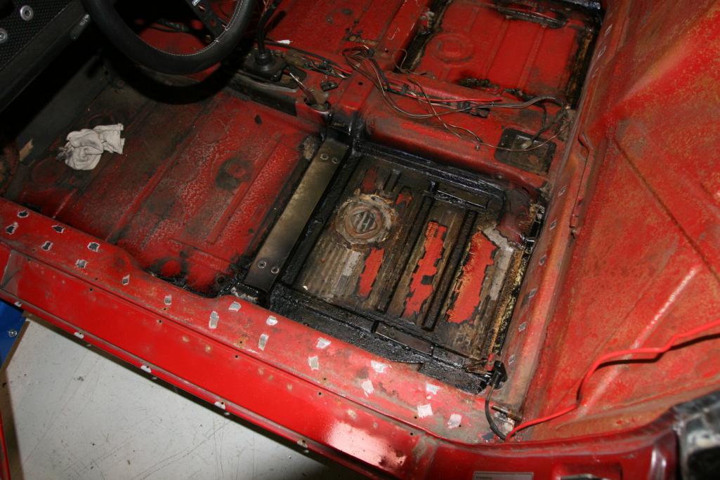

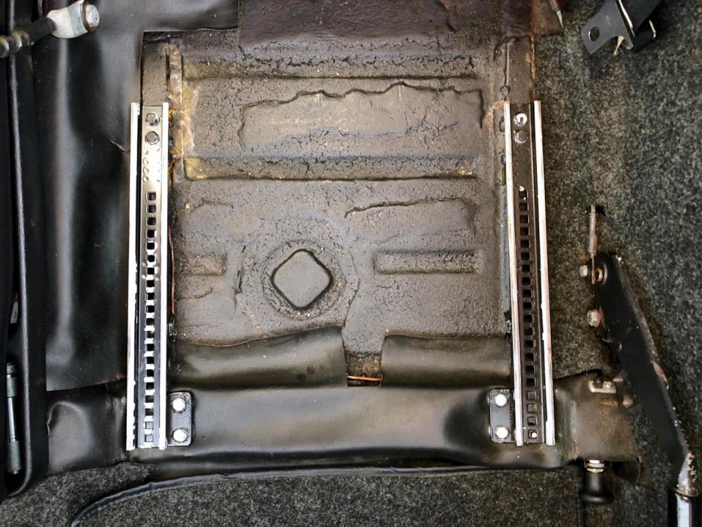

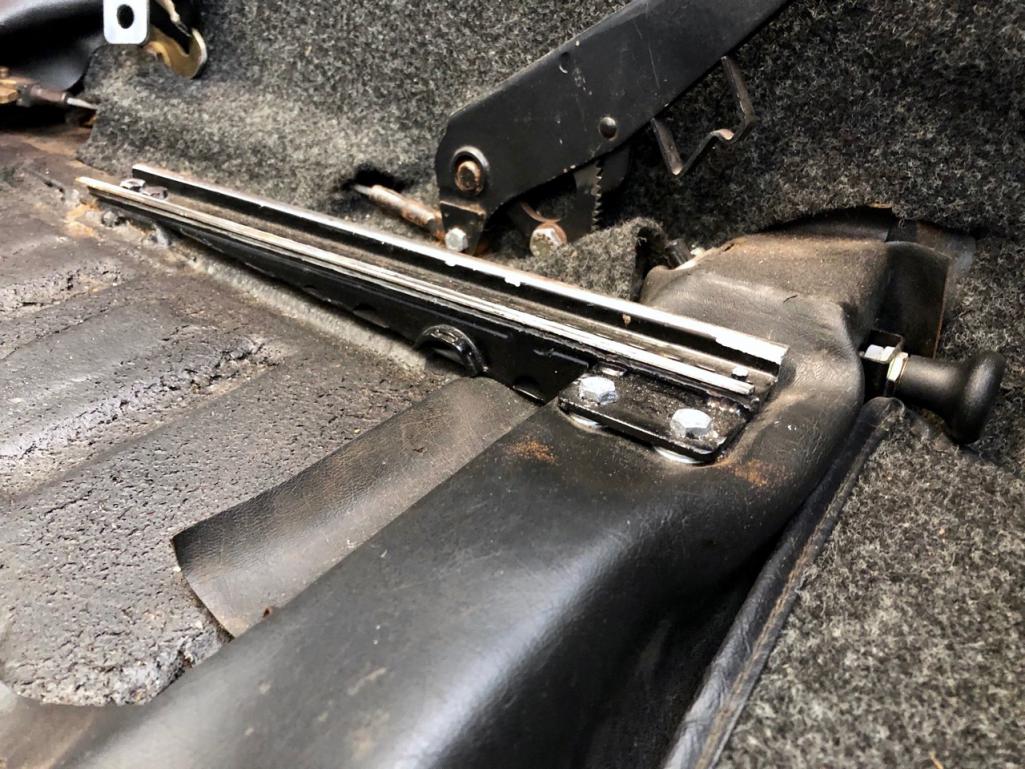

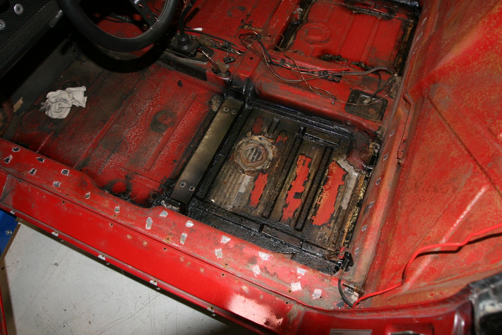

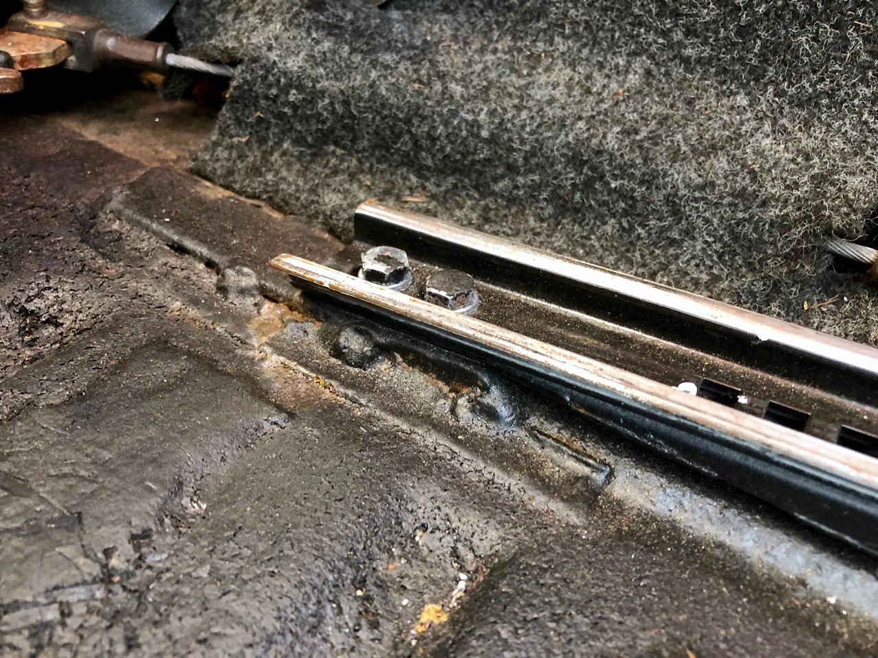

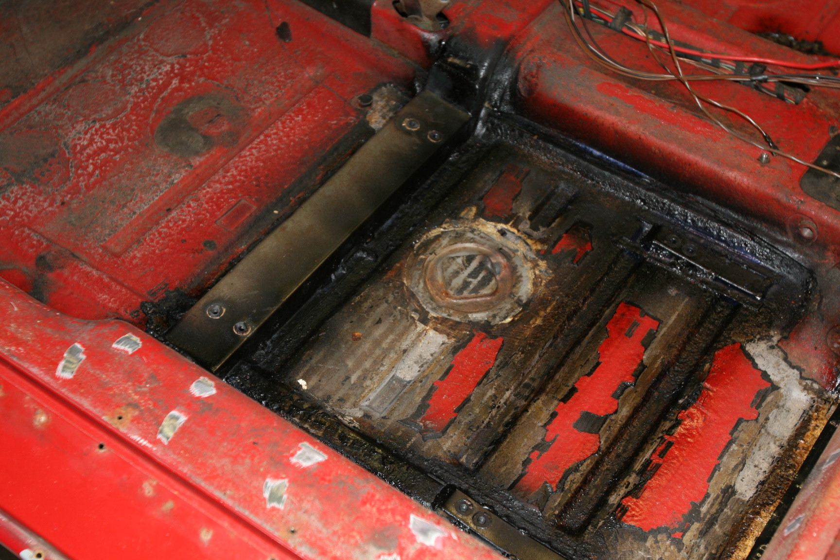

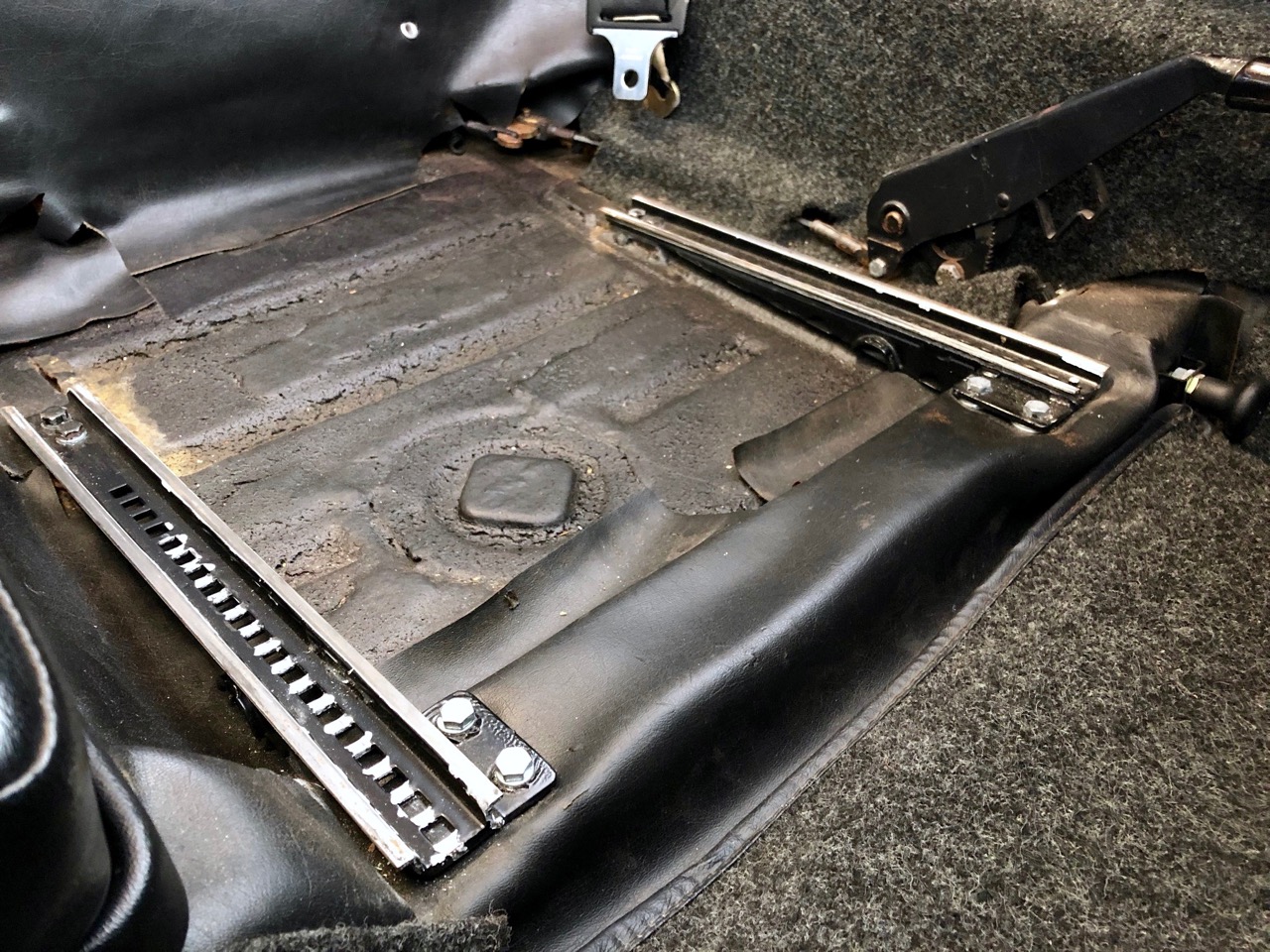

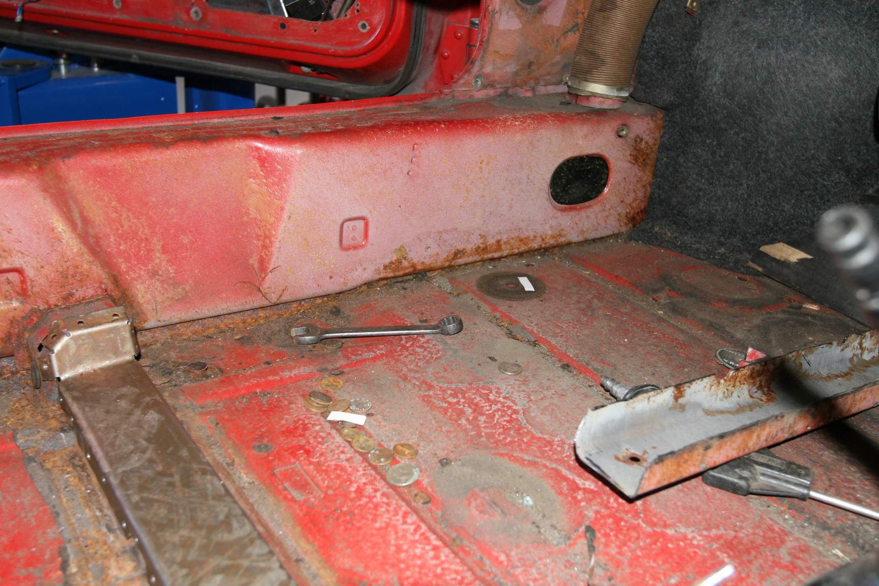

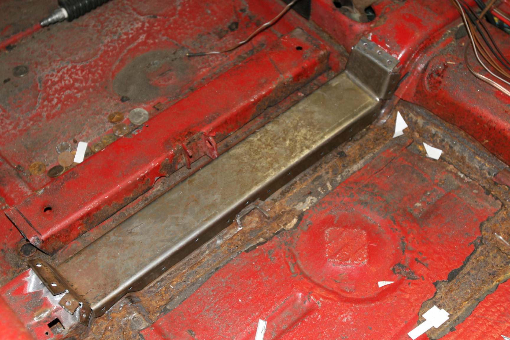

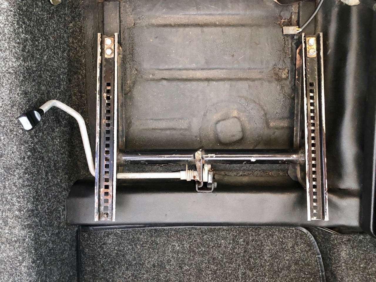

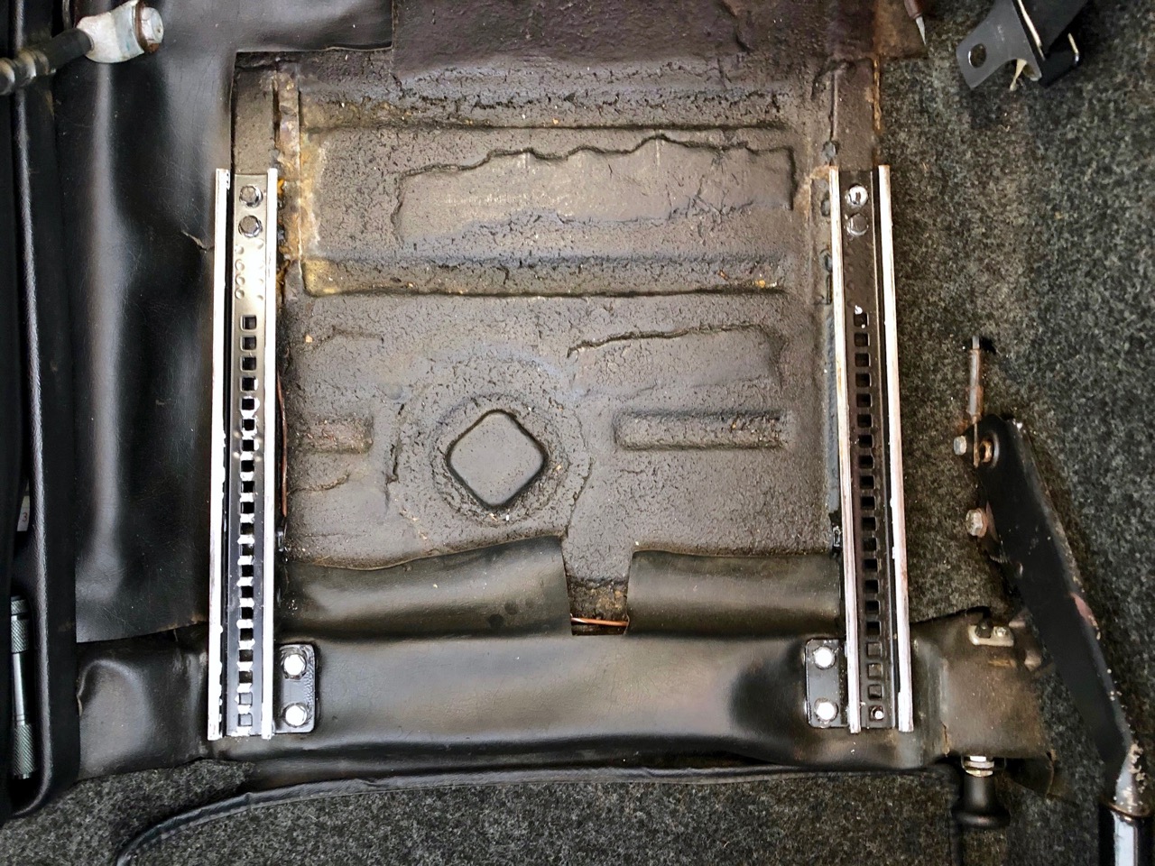

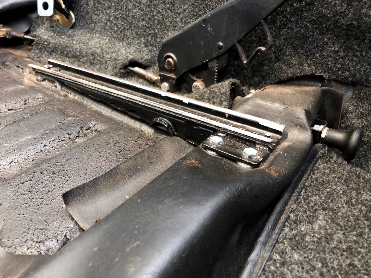

Many moons ago, someone asked for photos of how my driver's seat was lowered. Getting the last pair of seats out wasn't fun, as I didn't take the time to get the rails aligned as well as they could be, but I took the opportunity to grab some photos of the setup today.
You can see that the cross bar under the front of the seat was cut out and "stepped down" with thicker metal. This was done at Genoa Racing in Novato, CA at the same time that the Engman chassis stiffening kit was added. I lost the ability to change the seat angle (which doesn't bother me, as it's pretty limited in the 914, and not bad as is), but dropped about 0.8 inch. Well worth it, imo...
First pic is the stock seat mount, with angle adjuster. The rest are the modded setup, which was made from a stock setup plus a bit of fab work.
Attached Image Attached Image Attached Image Attached Image Attached Image Attached Image Attached Image Attached Image Attached Image Attached Image
