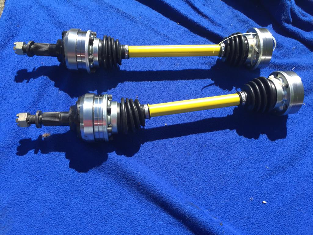

Ok my opinion is worth crap. But I have these in my big 4. Overkill? Without a doubt. But with these you just don’t have to worry about anything breaking. To me it was wortgythe money.

flmont
post May 8 2019, 03:41 PM
Posts: 881
Joined: 21-October 08
From: Tucson,Az
Member No.: 9,676
which company did those yellow axle's Mblizzard

Looks like renegade adapters
Mblizzard
post May 8 2019, 05:47 PM
Posts: 3,033
Joined: 28-January 13
From: Knoxville Tn
Member No.: 15,438
QUOTE(flmont @ May 8 2019, 01:41 PM) *
Renegade just painted them yellow for effect.
