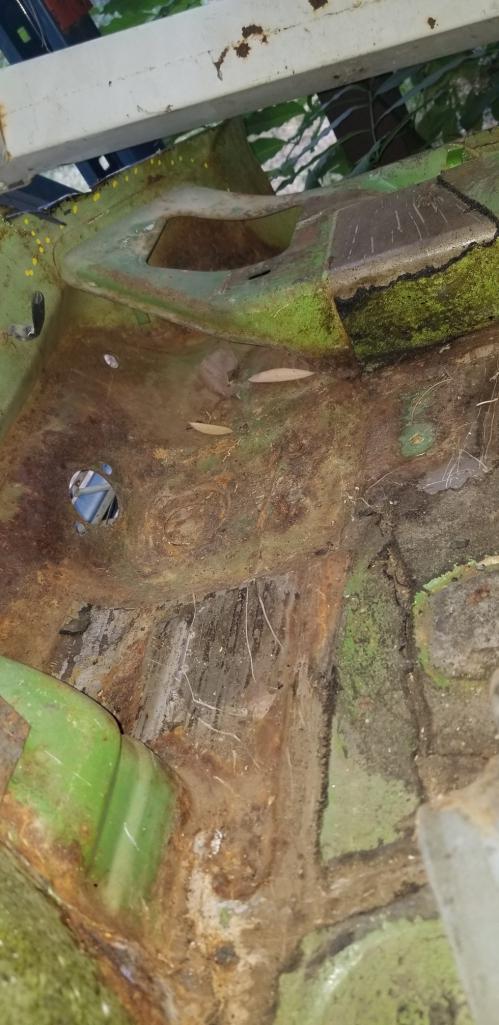

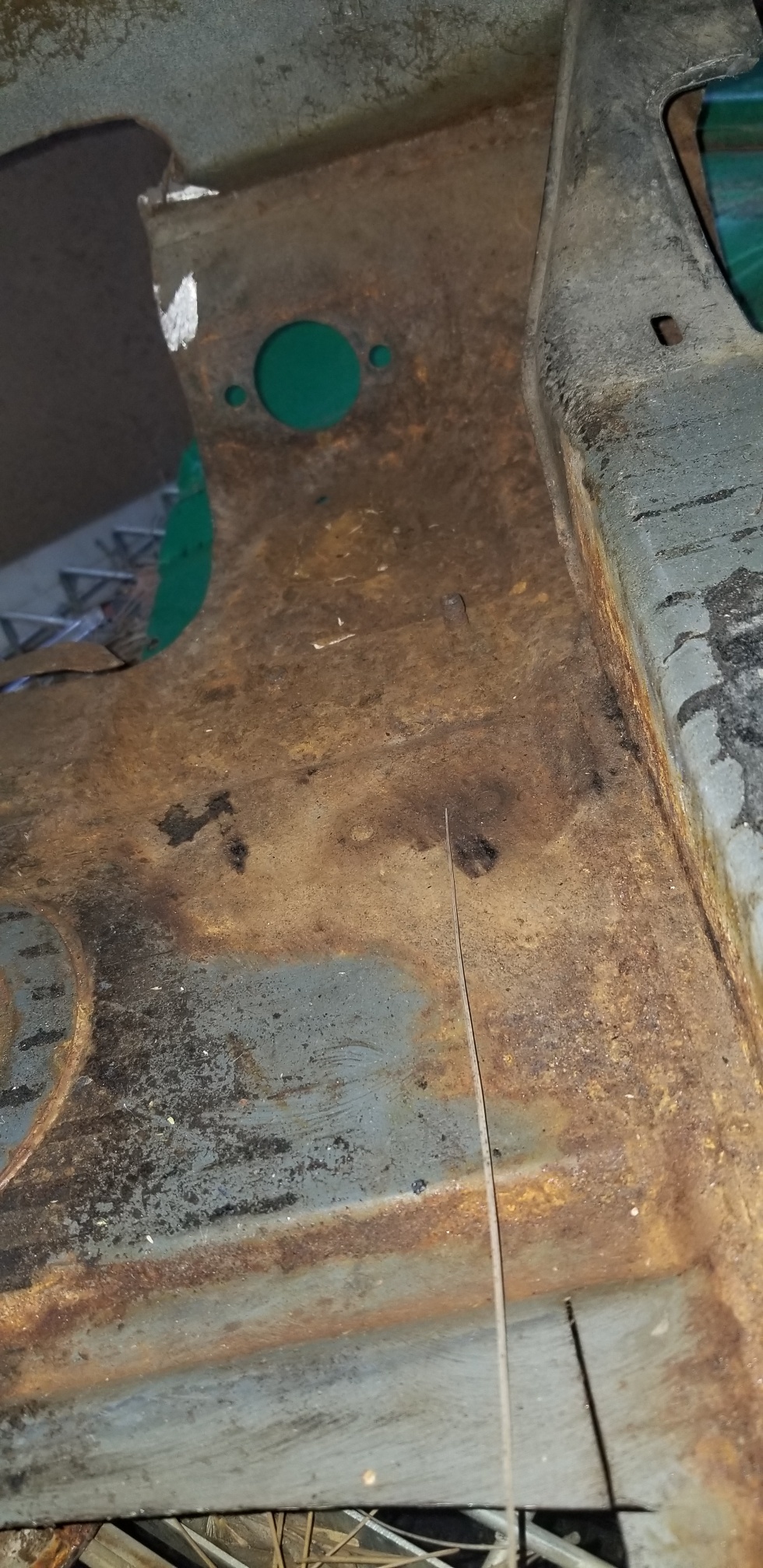

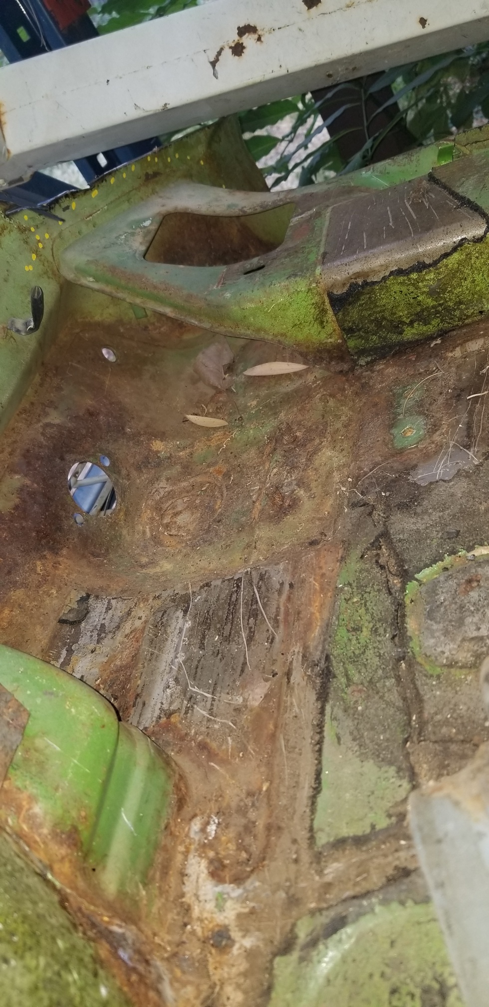

Remove the pedal board and inspect the area. You may find a pool of brake fluid in the pedal set.
Pull the drivers side carpet, pedal pads and remove the two allen head bolts (5mm wrench) from the left and right sides o the pedal board.
Remove the pedal board. It comes out the bottom first and then up and over the pedals.
Pull thee boot on the master cylinder on and press the brakes hard. Watch fo fluid coming out the end of the master cylinder.
You are going to need access to this area to replace the master cylinder.
The area under the pedals is one of the most rust prone spots on the car. See pics below. You will probably want to remove the pedals and clean the area to prevent future rust.
Good luck, have fun.
