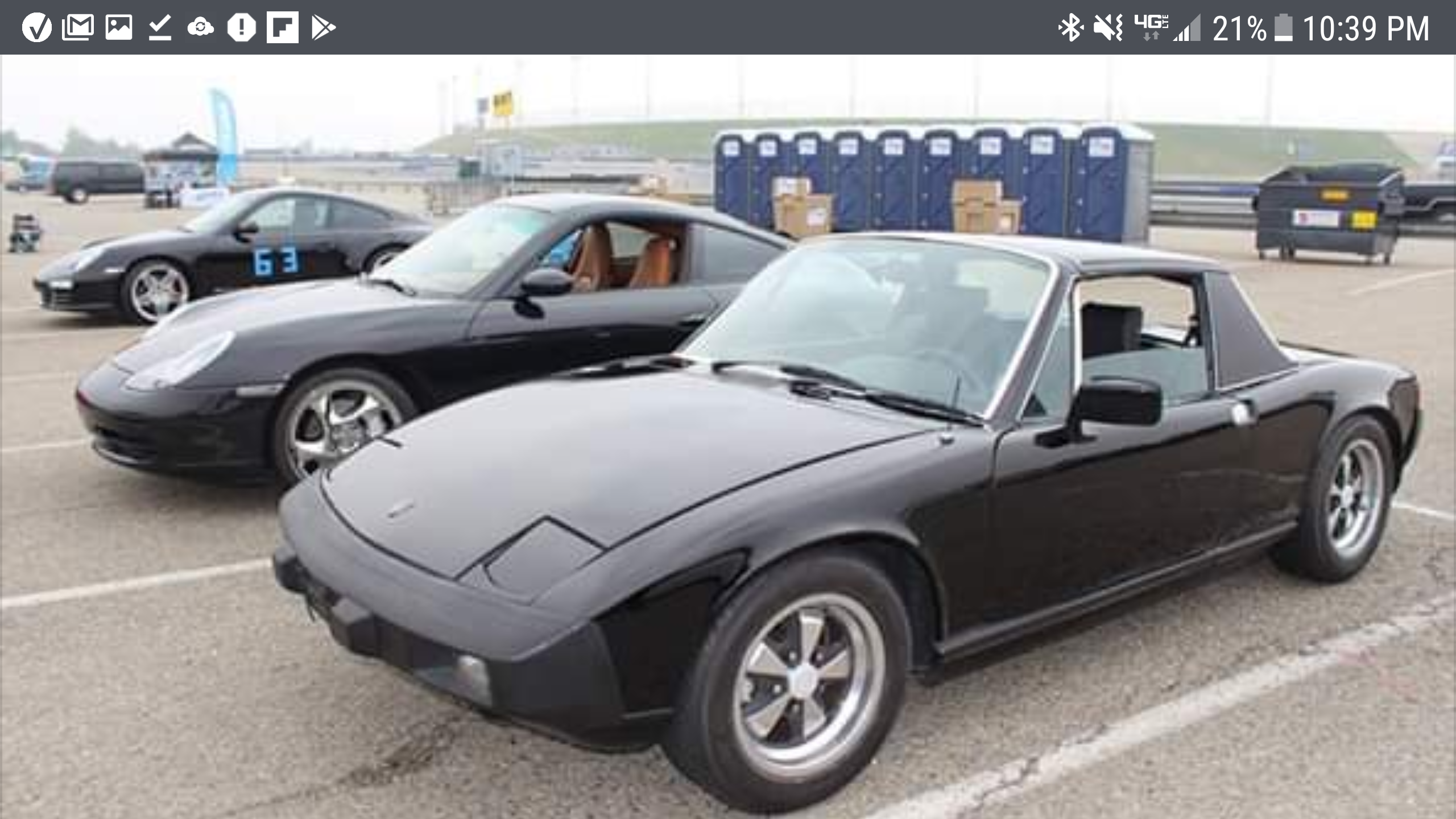

That's a nice looking slant-nose.

Thanks, PO did the slant, fenders and suspension in 1981. I've owned it since 1982.

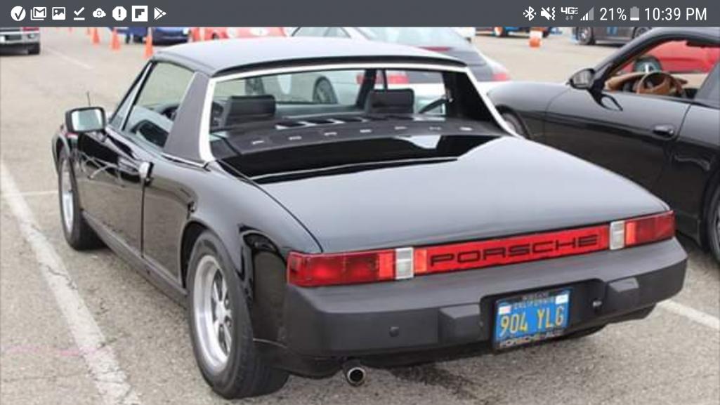

Nice car BTW, I really dig your rear fender flares.
