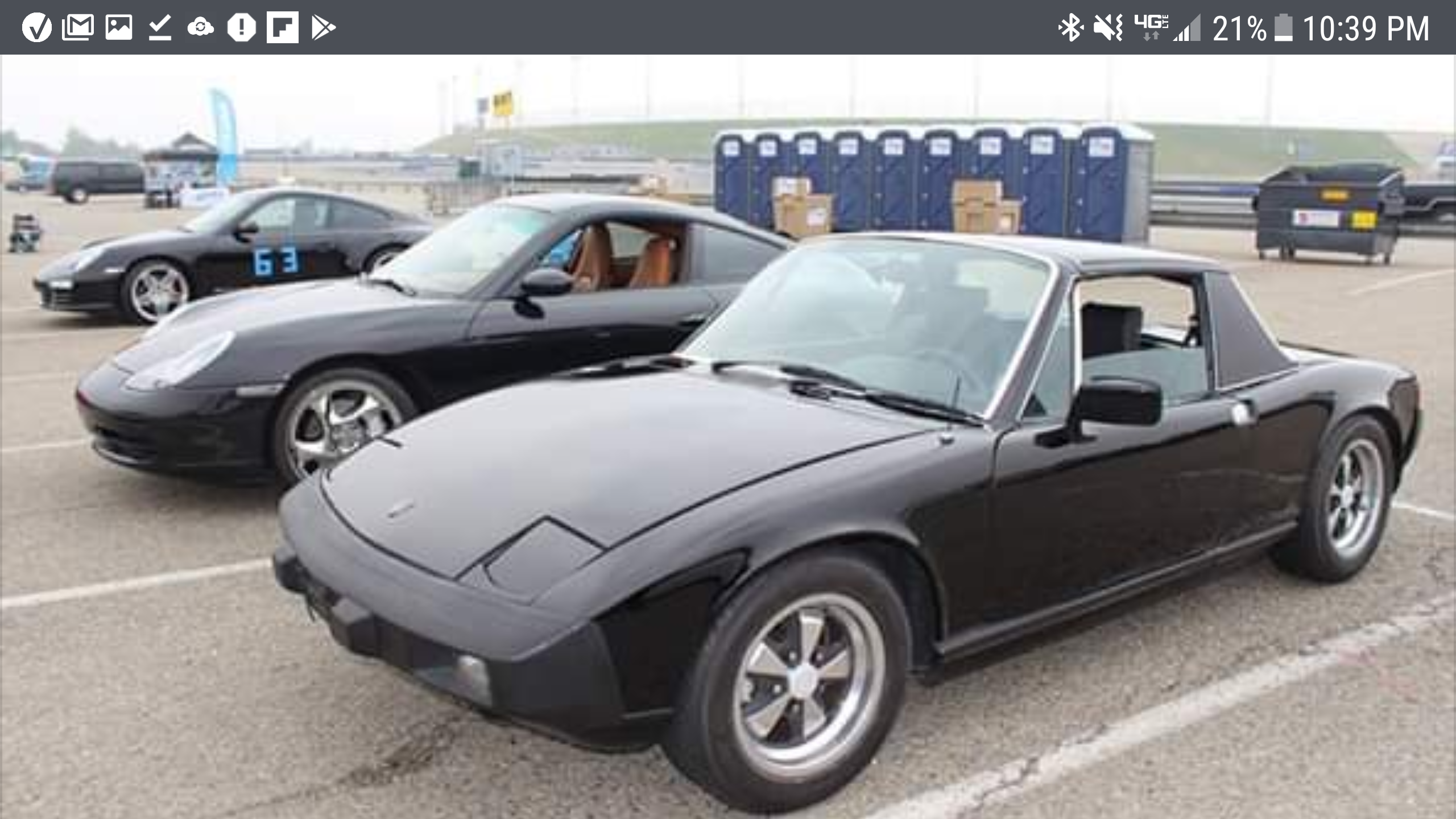

Just got my 75 2.0 back on the road after 24 years in the back of the garage. Last time I drove it back in 94 everything was pretty tight and smooth, now it seems to be all over the place. Was hoping to take it to WCR.
Any suggestions on where to start with the suspension?
Has 76 911S front koni struts, S calipers and sway bar. Rear 914-6 components.
Thanks

That's a nice looking slant-nose.
framos914
May 10 2019, 02:52 PM
QUOTE(mbseto @ May 10 2019, 01:36 PM)
Thanks, PO did the slant, fenders and suspension in 1981. I've owned it since 1982.

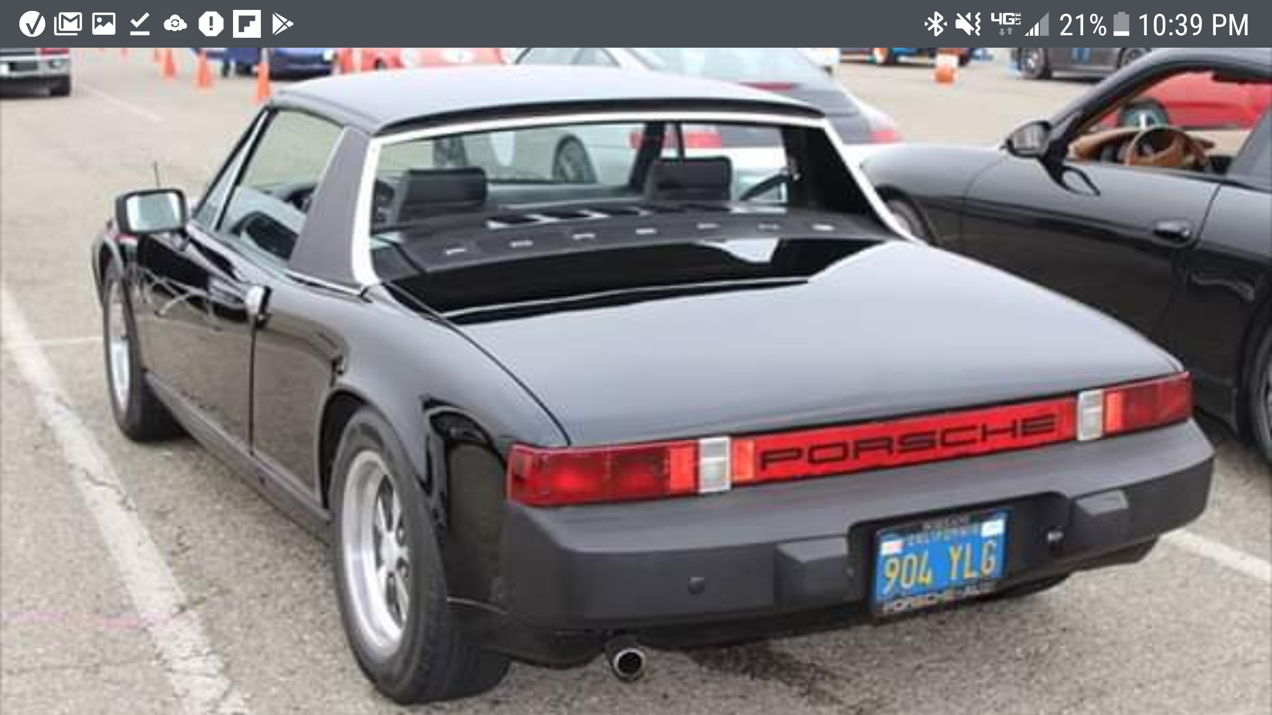

Nice car BTW, I really dig your rear fender flares.
