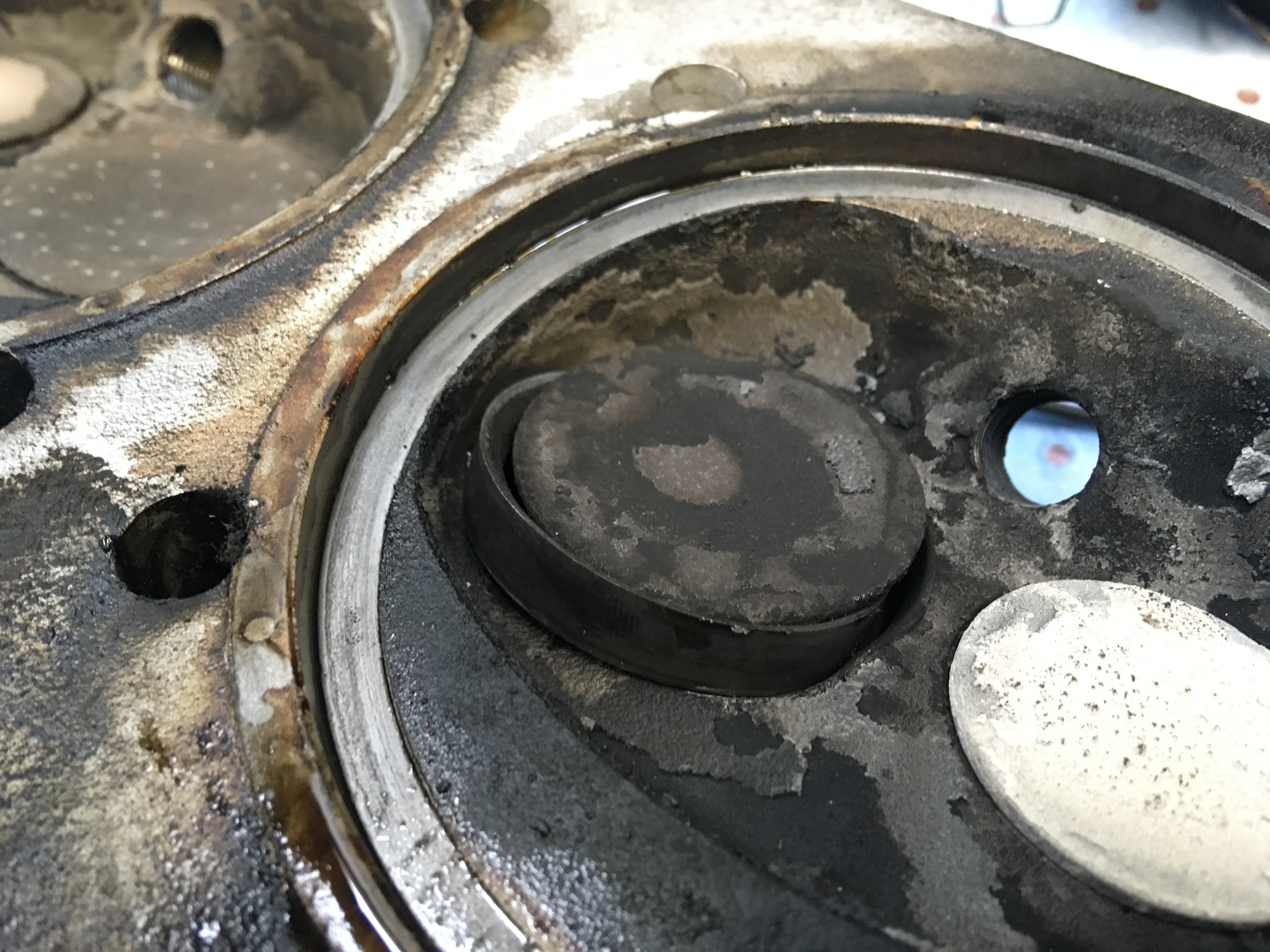

two weeks ago I was in Monthlery near Paris France, for a wagenfest with my 914.
Get some troubles with the engine, a hammer noise and the engine stopped smoothly like out of gas.
here is what I found :

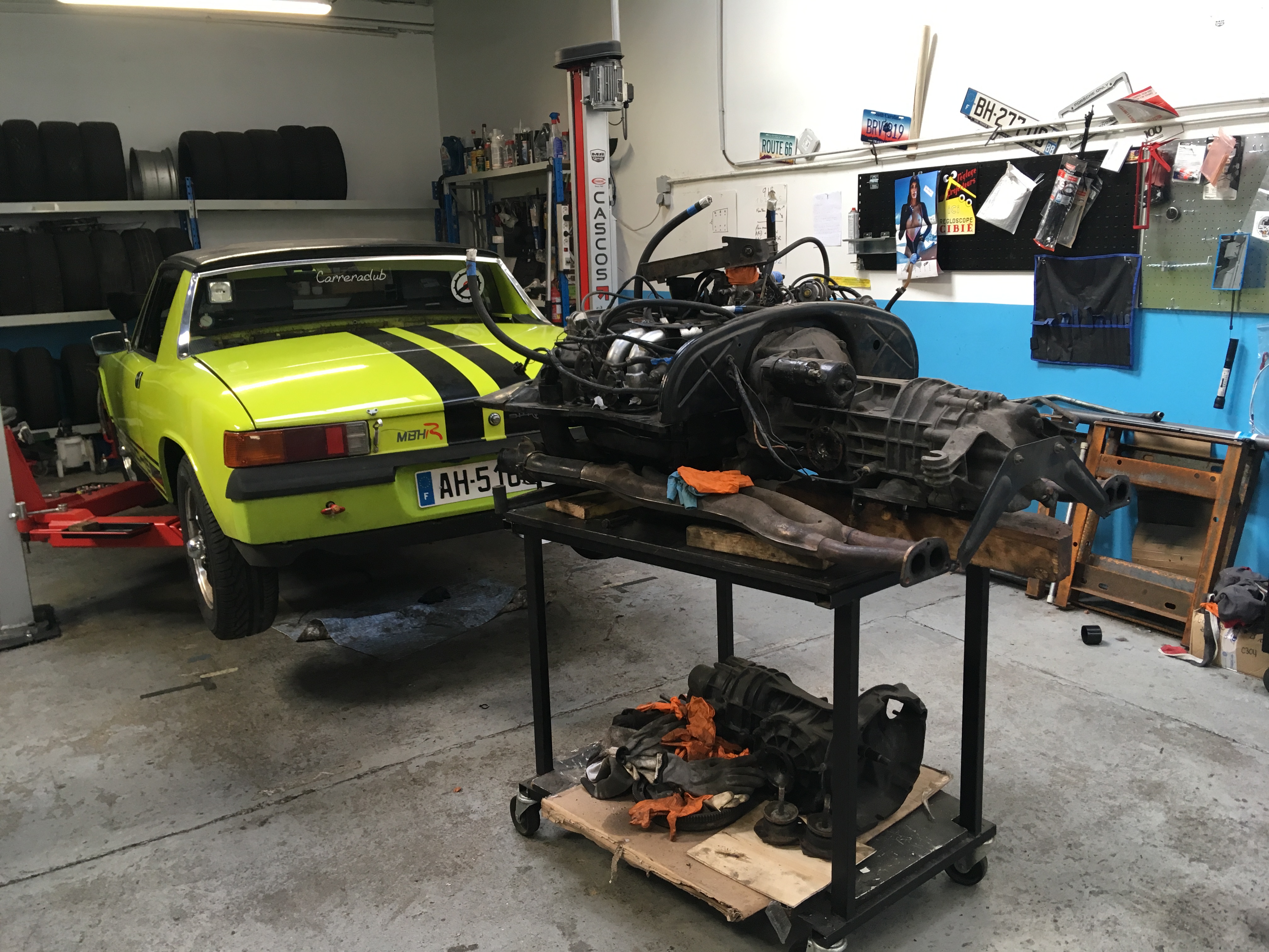

my own workshop, this is a Aircooled specialized self garage

cylinder 3 admission valve stand in open position

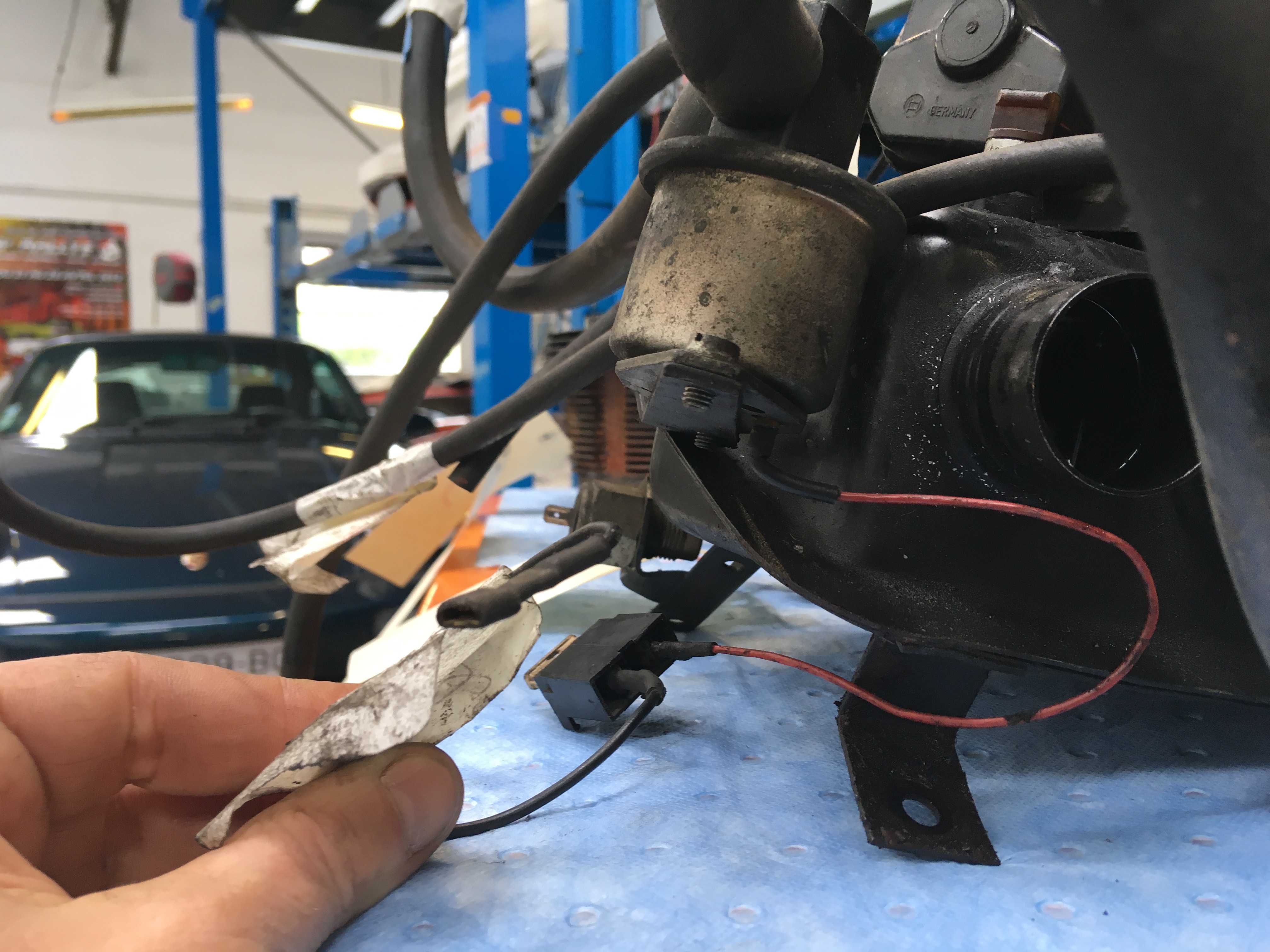

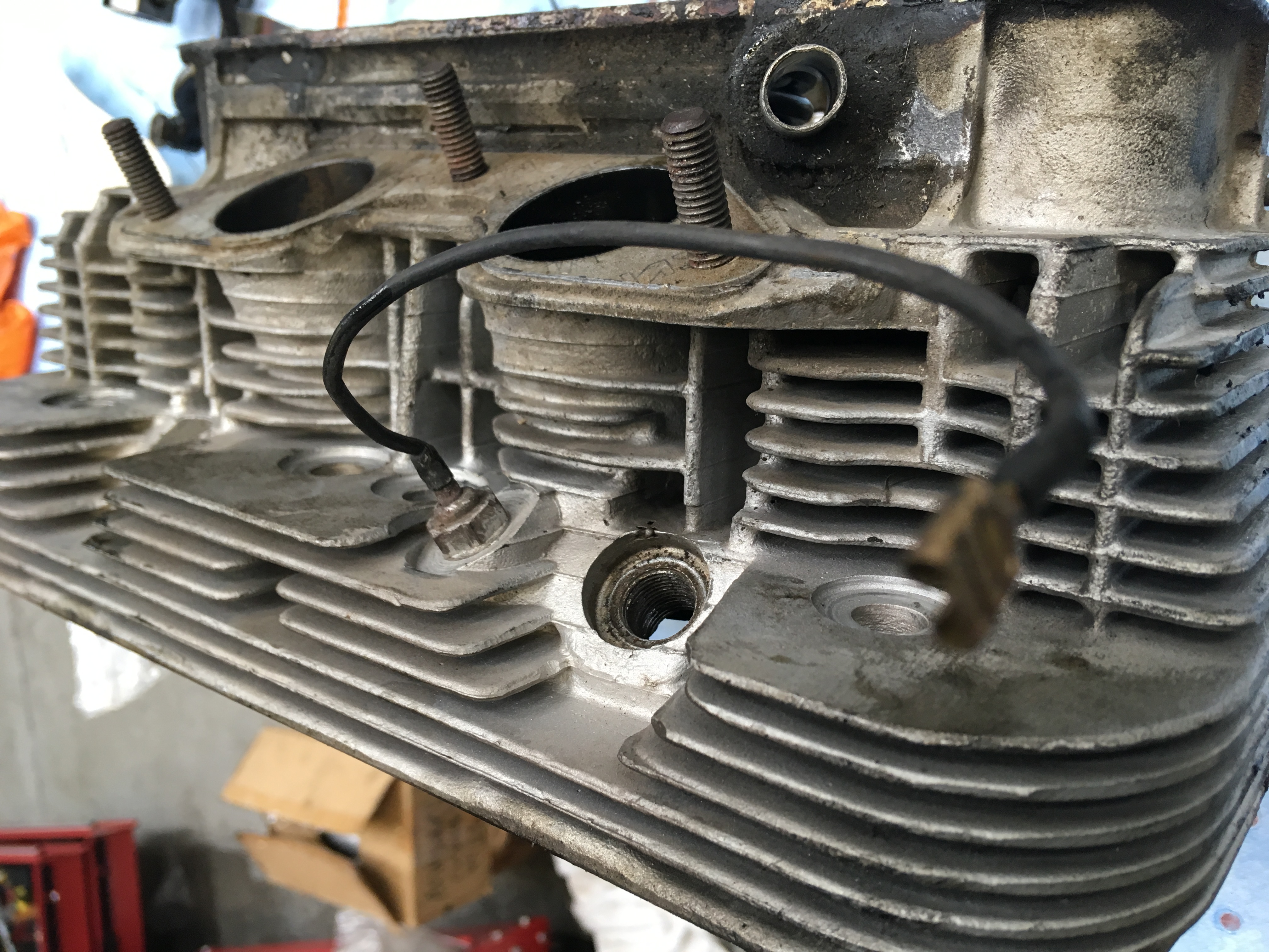

Opening the engine and disassembling the djetronic I found somme stranges things I will like to show you
question #1 :
the head temperature sender was not plugged, perhaps I unplugged it myself by mistake.
where does it plug ?
914_teener
post May 10 2019, 01:30 PM
Posts: 5,268
Joined: 31-August 08
From: So. Cal
Member No.: 9,489
classic dropped valve seat.
Pull the heads and redo them.
914_teener
post May 10 2019, 01:33 PM
Posts: 5,268
From: So. Cal
Member No.: 9,489
QUOTE(CheeRS @ May 10 2019, 12:29 PM) *
question #1 :
Plugs into the ecu wiring harness.

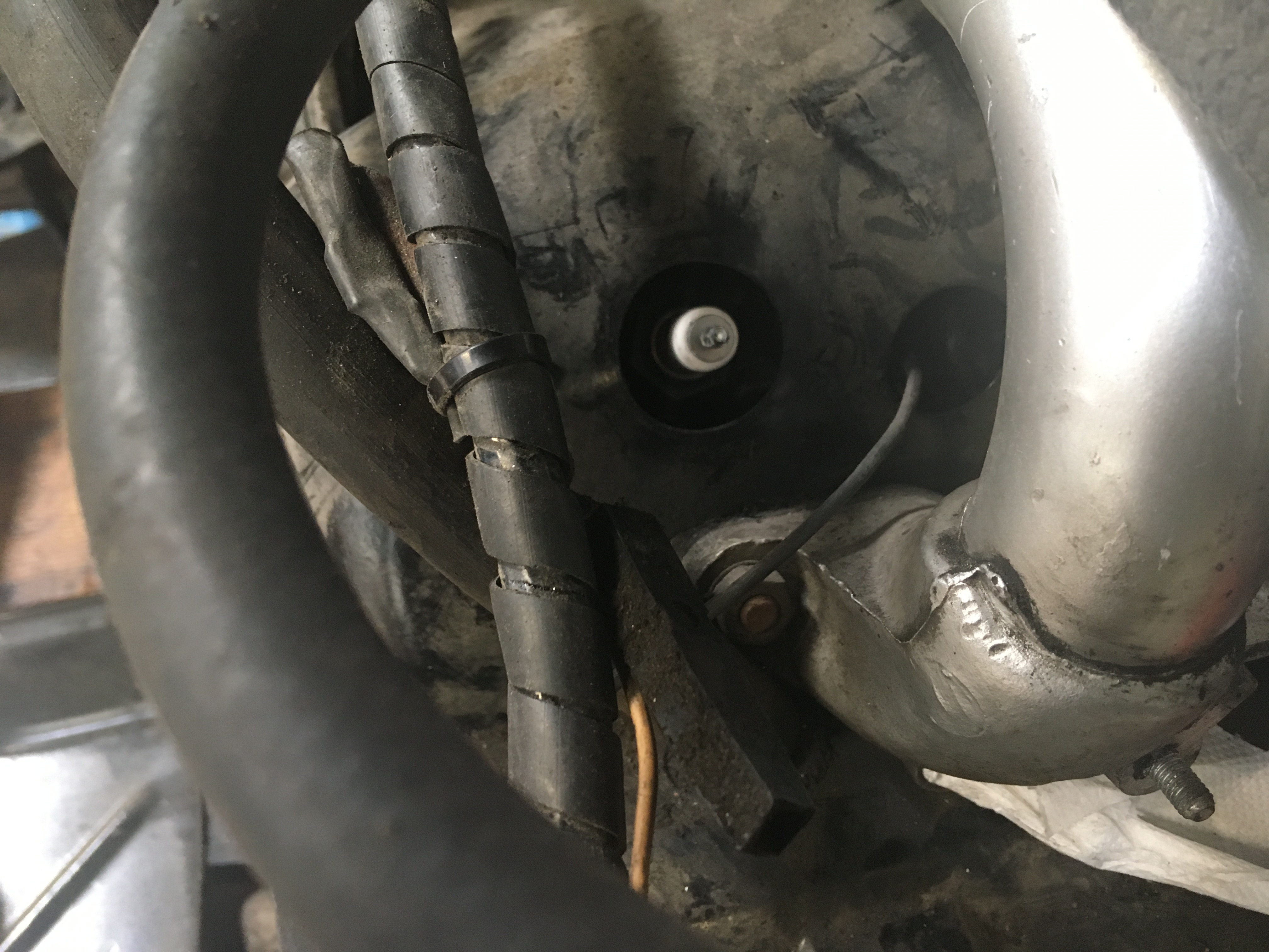

QUOTE(914_teener @ May 10 2019, 01:33 PM) *
question #1 :
I agree but where ?
here ?
914_teener
post May 10 2019, 02:30 PM
Posts: 5,268
From: So. Cal
Member No.: 9,489
Follow the ecu harness back from the ECU...you should see a wire with a plastic connector shield on the end of the lead. Usually the wire is white like the one I see in the picture.
CheeRS
post May 10 2019, 02:55 PM
Posts: 93
Joined: 5-May 19
From: Paris France
Member No.: 23,093
Region Association: France
Thanks, to be sure I will track the wire and the number in the ECU connector.
Another part was not plugged, the additionnal air valve.
GregAmy
post May 10 2019, 06:00 PM
Posts: 2,604
Joined: 22-February 13
From: Middletown CT
Member No.: 15,565
I'd be more worried about the dropped valve seat before where the wires plug in...but that's just me...

Chi-town
post May 10 2019, 07:02 PM
Posts: 851
Joined: 31-August 18
From: Disneyland
Member No.: 22,446
Have the head checked for cracks before you waste time / money in machine work putting a seat back in it.
Look in the exhaust seat to the plug

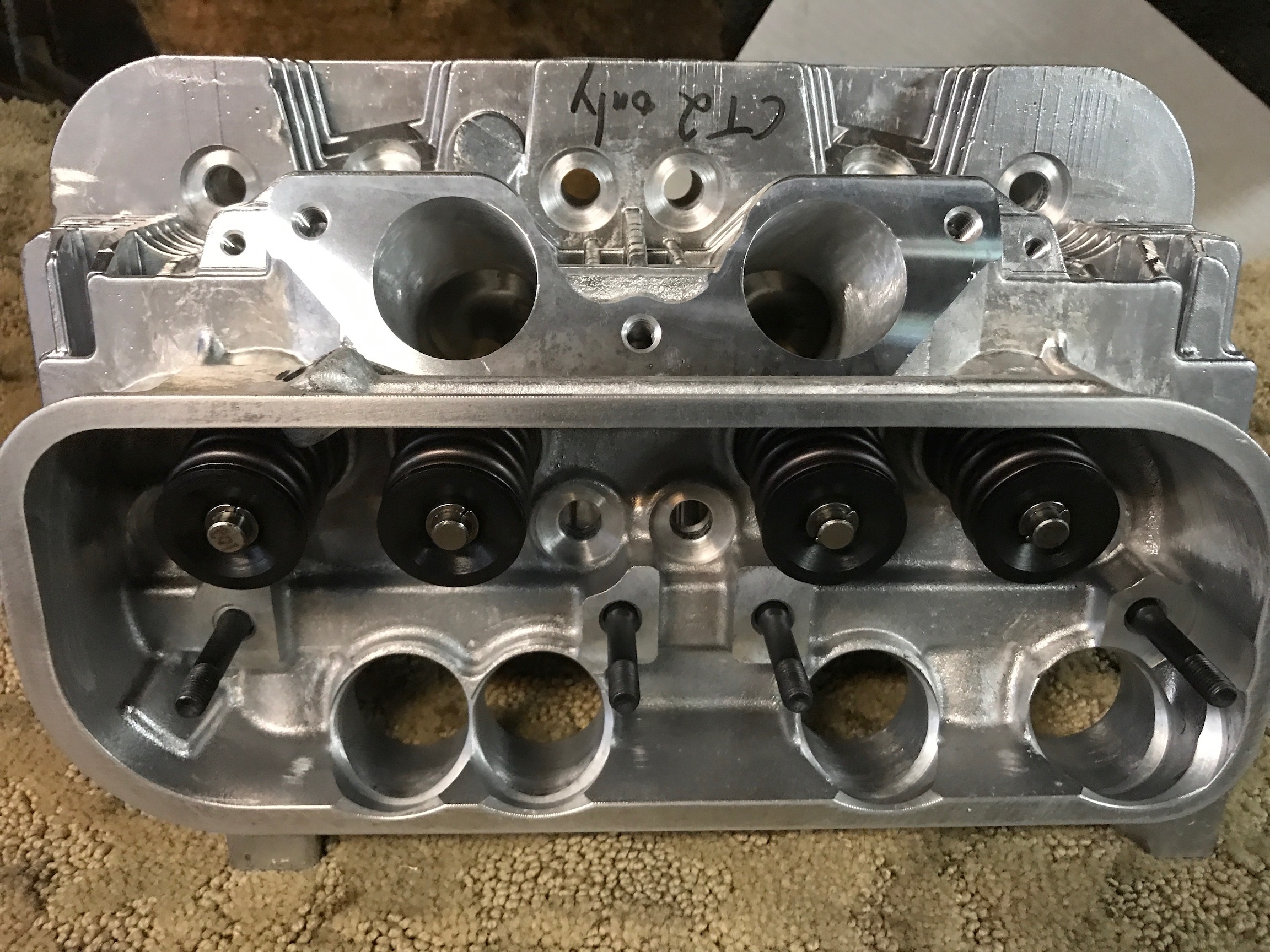

Dave_Darling
post May 10 2019, 08:46 PM
914 Idiot
Posts: 15,298
Joined: 9-January 03
Member No.: 121
After you look at the heads, consider the LN series heads from the Type 4 store, or if you have a good machinist locally consider getting new head castings from AMC in Spain and using them as cores.
It might make more sense to repair yours, but new castings are available.
--DD
CheeRS
post May 11 2019, 12:42 AM
Posts: 93
Joined: 5-May 19
From: Paris France
Member No.: 23,093
QUOTE(GregAmy @ May 10 2019, 06:00 PM) *
Thanks friends, you are right.
I checked the head, saw no scratch, I will check again after cleaning.
Next week, I will give the head to a specialised shop
http://www.rectif2000.com/
This is why I already thinking about the engine reassembly.

A pic of my selfgarage
near Paris named Atelier M8
CheeRS

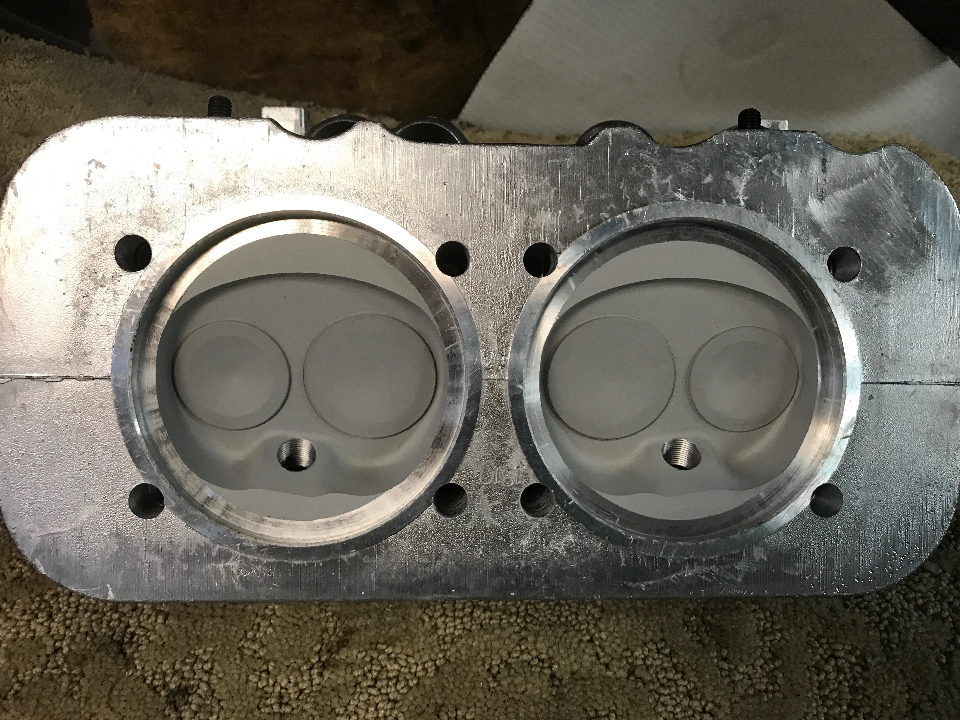

Bleyseng
post May 11 2019, 08:43 AM
Aircooled Baby!
Posts: 13,036
Joined: 27-December 02
Member No.: 24
If I were you I'd order a set of new castings set up by Len at HAM for replacing those. I just did mine with a set from him including having bigger valves installed (44x38). Well worth every penny!
rhodyguy
post May 11 2019, 08:56 AM
Posts: 22,252
Joined: 2-March 03
From: Orion's Bell. The BELL!
Member No.: 378
Do you intend just to do the one head?
Bleyseng
post May 11 2019, 09:57 AM
Aircooled Baby!
Posts: 13,036
Member No.: 24
Buy a set of these with the coating to keep the heat out of the head.
CheeRS
post May 11 2019, 06:36 PM
Posts: 93
Joined: 5-May 19
From: Paris France
Member No.: 23,093
QUOTE(Bleyseng @ May 11 2019, 08:43 AM) *
To keep the race passport available, I need to keep the engine stock specs.
