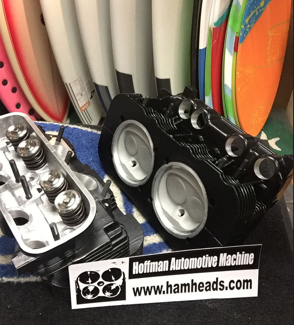

Buy a set of these with the coating to keep the heat out of the head.
A adress to have a quote and check if there is shipping in France ?
BeatNavy
post May 11 2019, 06:47 PM
Post #22
Posts: 2,956
Joined: 26-February 14
From: Easton, MD
Member No.: 17,042
https://newsite.hamheads.com/home/
Contact Len Hoffman using that link.

You can get new bare 914 2.0 cores from AA performance, they come with nothing, no seats, guides hardware etc. IIRC they do come with the exhaust studs.
They would need to be sent to a machine shop, you have to use 8mm stem exhaust valves and guides.

If I were you I'd order a set of new castings set up by Len at HAM for replacing those. I just did mine with a set from him including having bigger valves installed (44x38). Well worth every penny!
This is the route I took with Len to make my set.

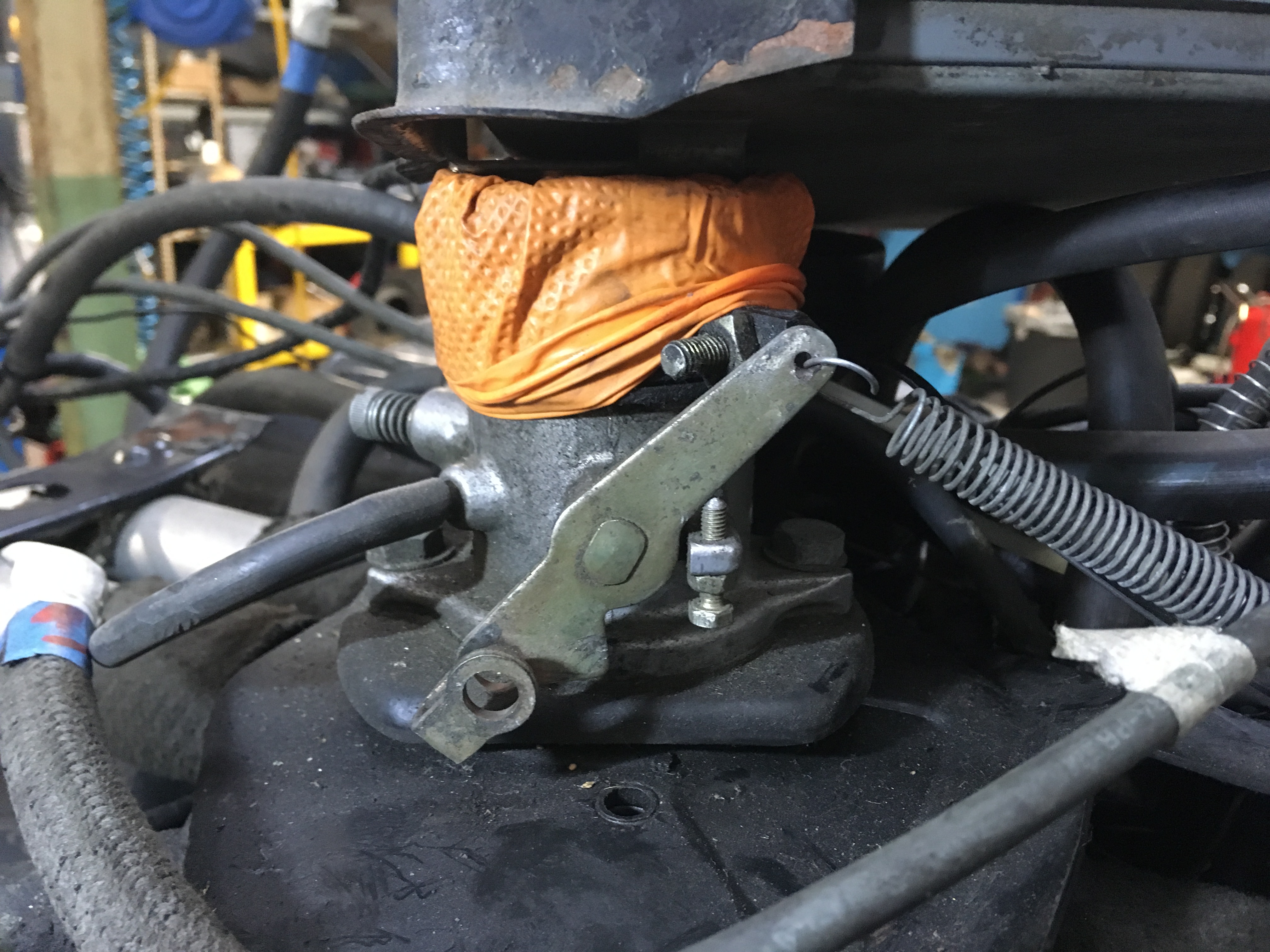

Was surprised to found this modification on my engine
