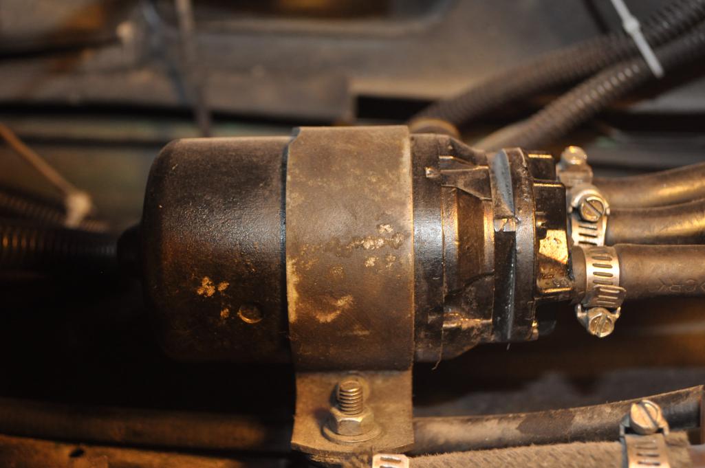

I couldn't get my '74 2.0 FI to start about an hour after driving it. Throughout the day I tried it...no luck. Finally, I hit it with a rock. The car start right away.
Is my fuel pump failing? All my wiring for the FI looks good. Attached is a photo of my fuel pump. If it is failing, is there a better alternative to the one I have. It's located on the fire wall.

Can’t tell by looking. First time that happened to me I didn’t I installed a FP Gauge Never regretted that. One less thing to figure out next time it stops.

QUOTE(dgraves @ May 12 2019, 09:30 AM) *
Doubt its failing ... But its just wayyyy to hot
It's boiling
