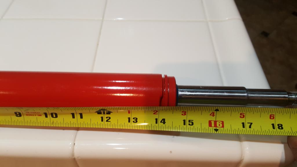

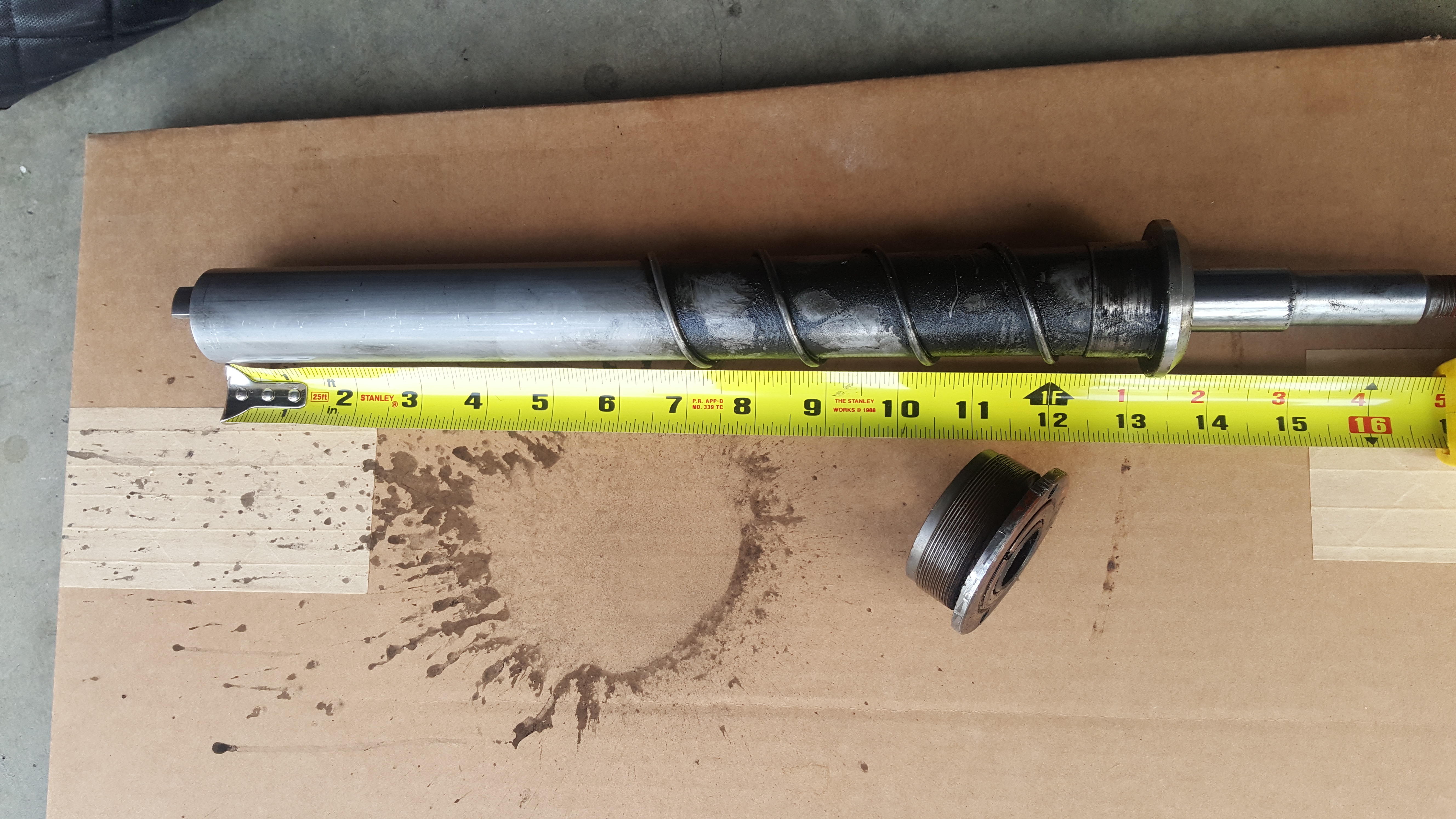

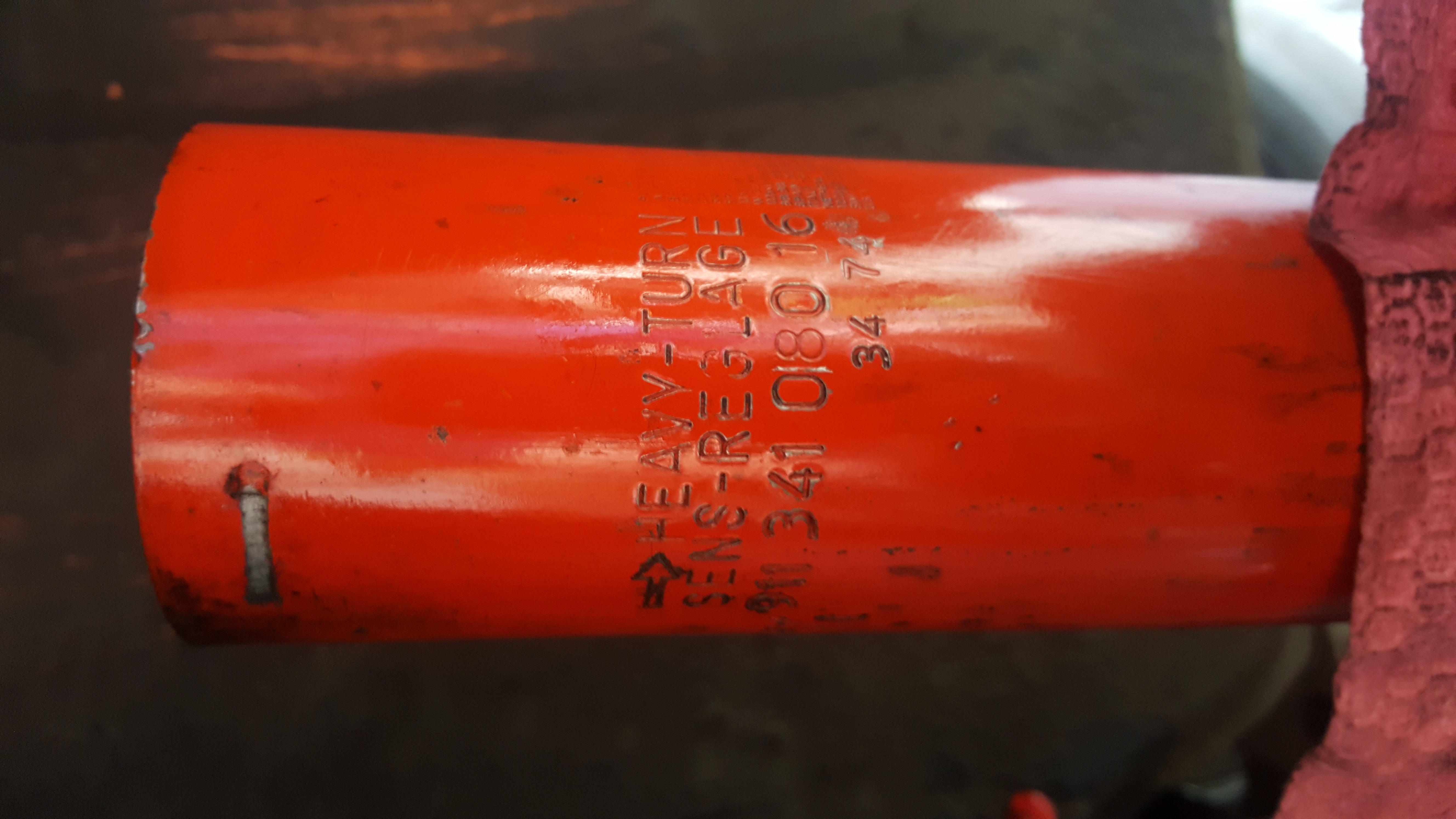

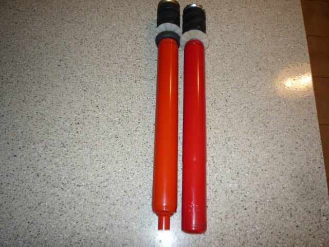

post May 16 2019, 12:02 AM
Posts: 125
Joined: 15-May 14
From: Corona California
Member No.: 17,353
Passenger side strut
framos914
post May 16 2019, 12:03 AM
Posts: 125
Joined: 15-May 14
Member No.: 17,353
framos914
post May 16 2019, 12:05 AM
Posts: 125
Joined: 15-May 14
Member No.: 17,353
Old insert
framos914
post May 16 2019, 12:11 AM
Posts: 125
Joined: 15-May 14
Member No.: 17,353
New 861942 insert
914Sixer
post May 16 2019, 06:12 AM
Posts: 9,472
Joined: 17-January 05
From: San Angelo Texas
Member No.: 3,457
I have never seen that type of Koni insert. The numbers I am seeing says it is 75-up strut. Made week 34 1974. Wondering about spacer in bottom of tube.?
infraredcalvin
post May 16 2019, 07:50 AM
Distracted Member
Posts: 1,743
Joined: 25-August 08
From: Ladera Ranch, CA
Member No.: 9,463
Something has to account for that tab at the bottom of the original insert.

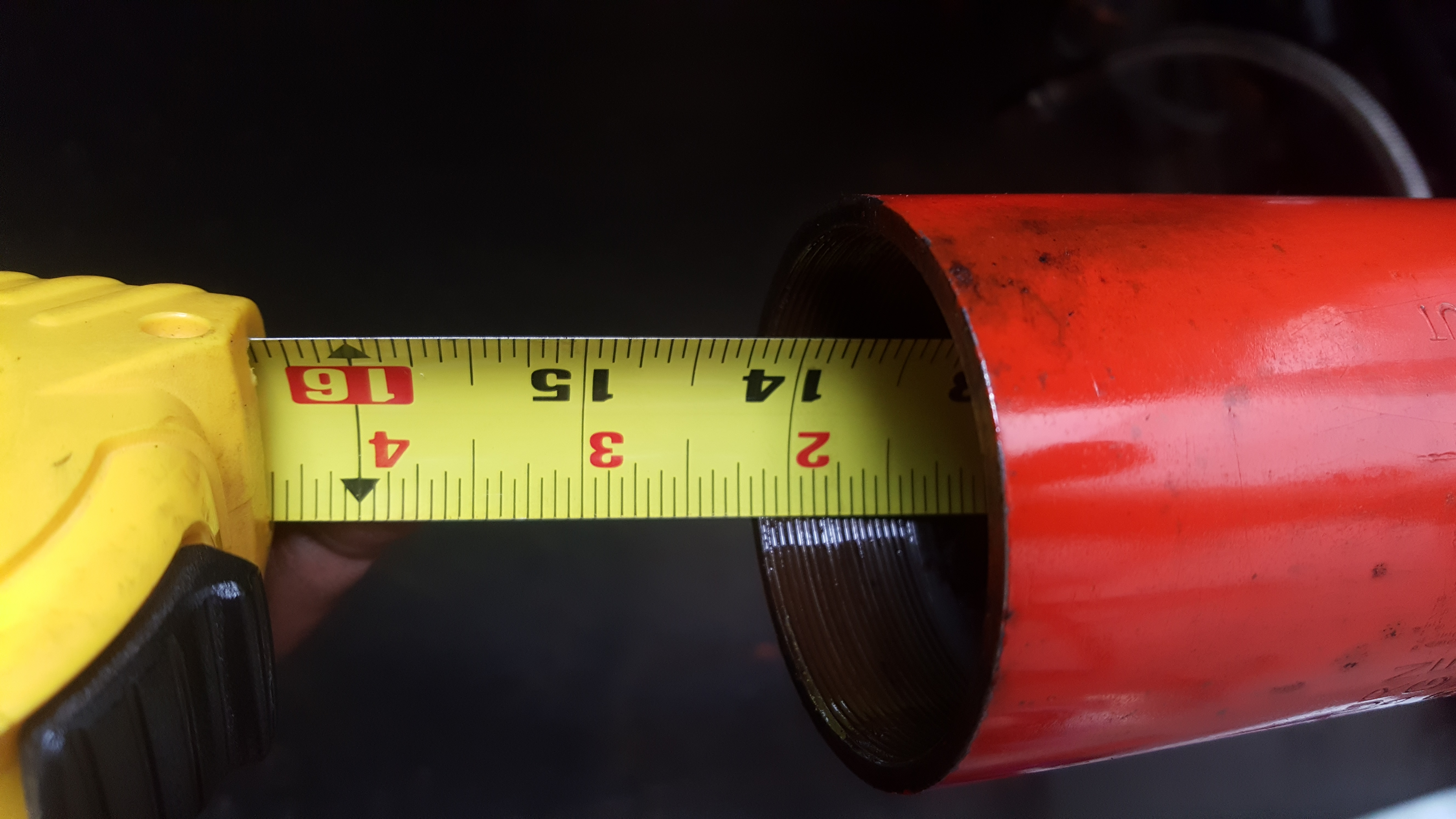

framos914
post May 16 2019, 10:23 AM
Posts: 125
Joined: 15-May 14
Member No.: 17,353
The tab has two sides, I think on the original the shaft gets pushed down manually and catches on something to make ride adjustments. Next I'll take the strut completely out to have a good look in the housing and make there's nothing inside the housing
sixnotfour
post May 16 2019, 01:09 PM
Posts: 11,215
Joined: 12-September 04
Member No.: 2,744
your missing some pieces,,ie still in tube..
