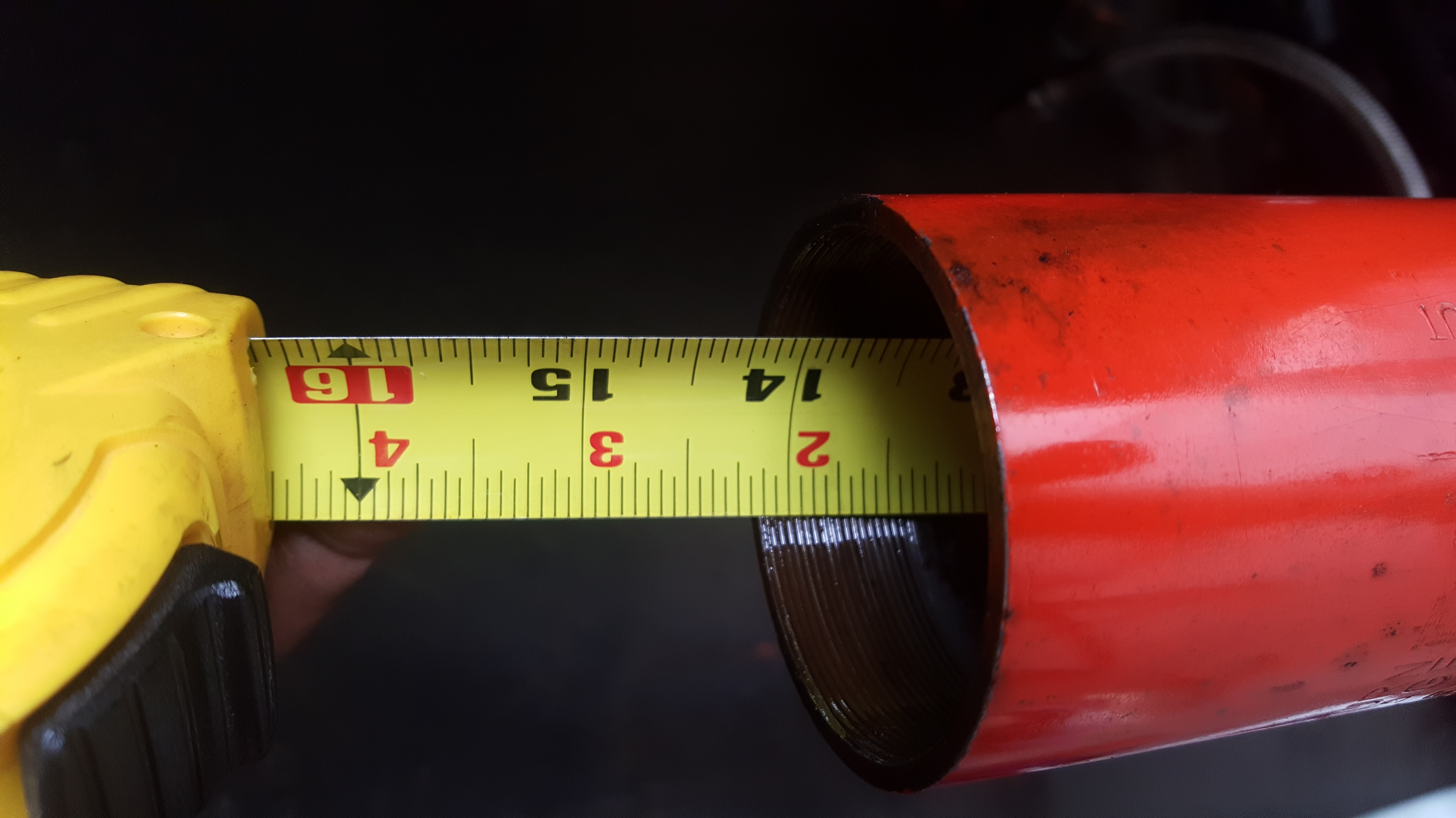

Need help. My 75 2.0 has worn strut inserts, PO replaced front struts with what I believed were 1977 911S Koni struts part #911 341 079 16 stamped on it. Bought inserts Koni 86-1942. Problem is they bottom out before going in far enough to secure them with the round nut.
Could I have 72-74 911S struts? Did they have the same part number? And are those inserts (86-1638) just a little shorter to seat further down. The 1942s seem to be just about 12mm too long, body of the 1942 is 374mm long.

Off the top of my head, it sounds like you are trying to put inserts made for 3 1/2" struts into a 3" strut. The later strut bodies are taller than the earlier ones.
framos914
QUOTE(mepstein @ May 14 2019, 08:47 PM) *
The struts are 3.5 inch, It also has the 911S aluminum calipers not the M calipers which I believe are the 3 inch.Even though the the receipt in the POs documents say 1977 suspension, it could be wrong. These components were installed on this car way back in 1980.

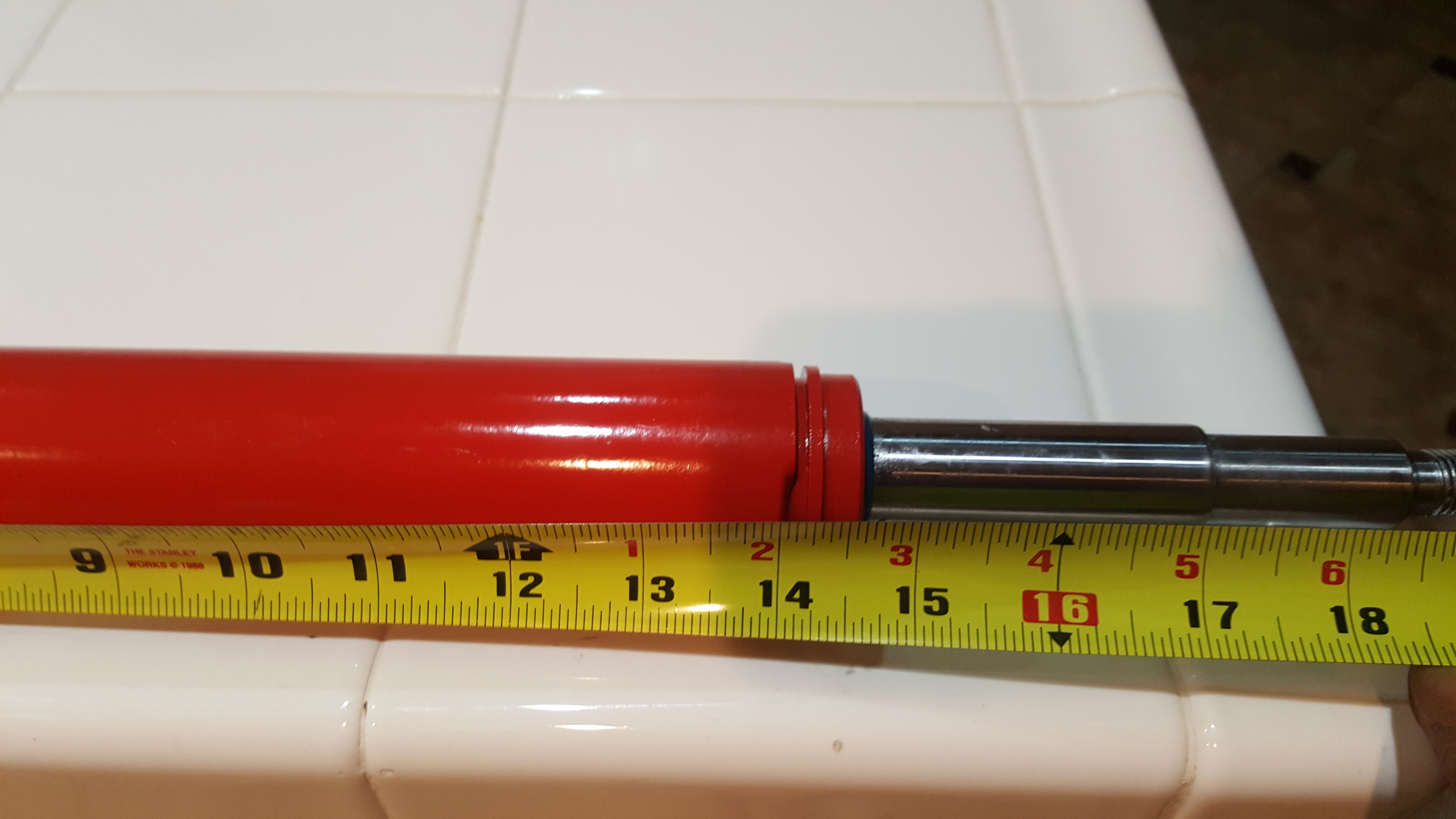

I have a set of Koni 86-1942 and I have test fitted them in stock 73-on Boge Struts. You have to use the Boge nut but they fit. I have a set of 86-1647 which are made different but fit the same.
One on right is the 1942 and left one is 1647. BOTH are the same length. 14 1/2 inces or 37 cm.

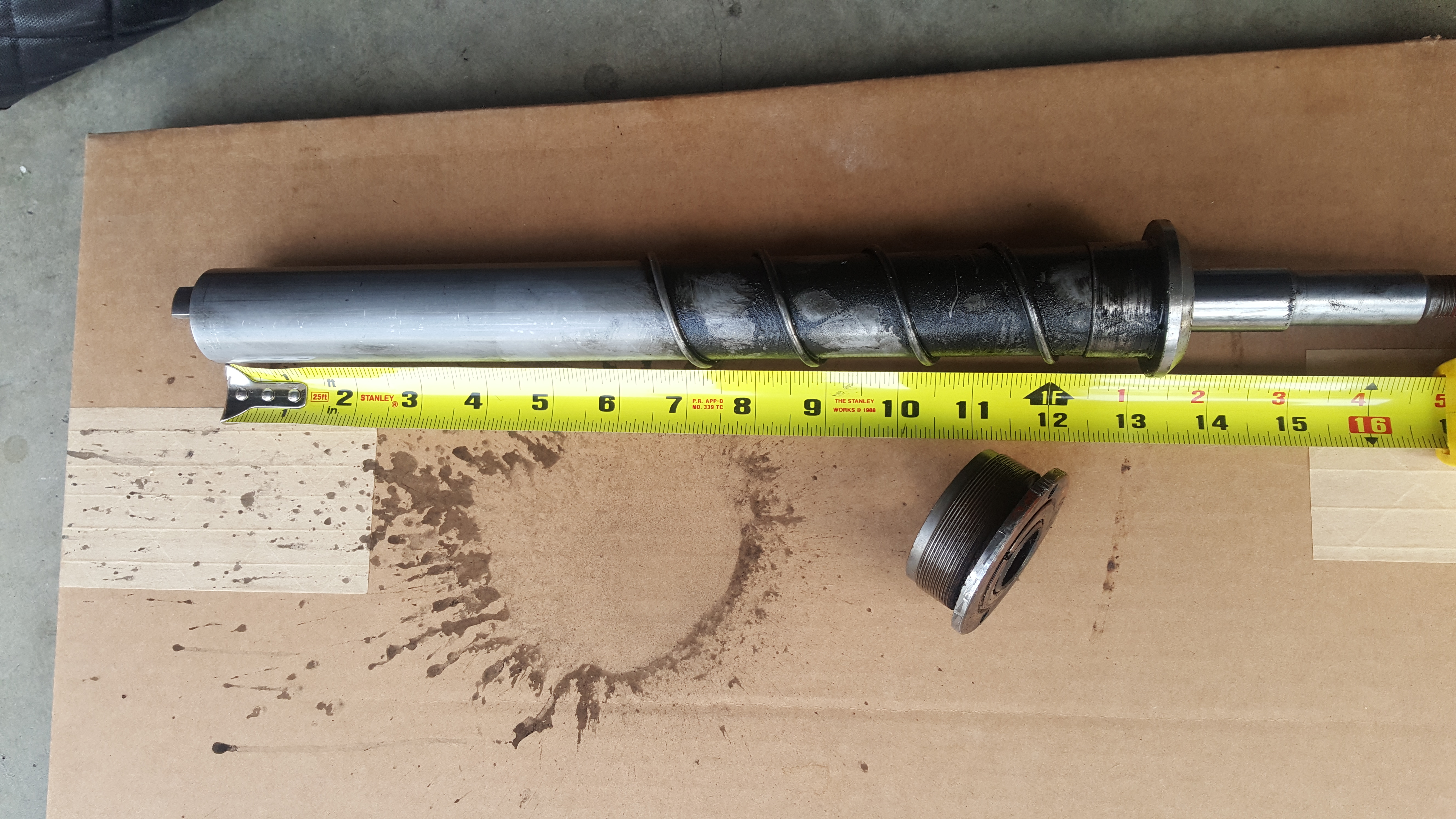

framos914
Passenger side strut
framos914
framos914
Old insert
framos914
New 861942 insert

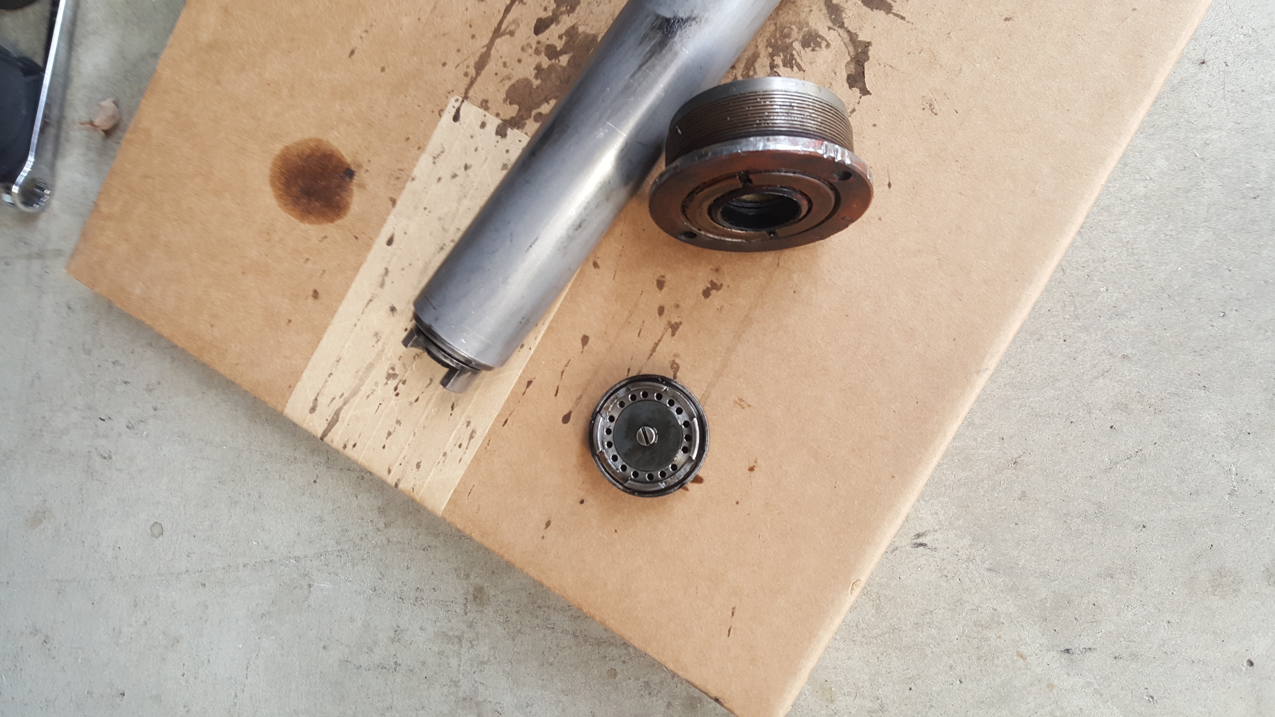

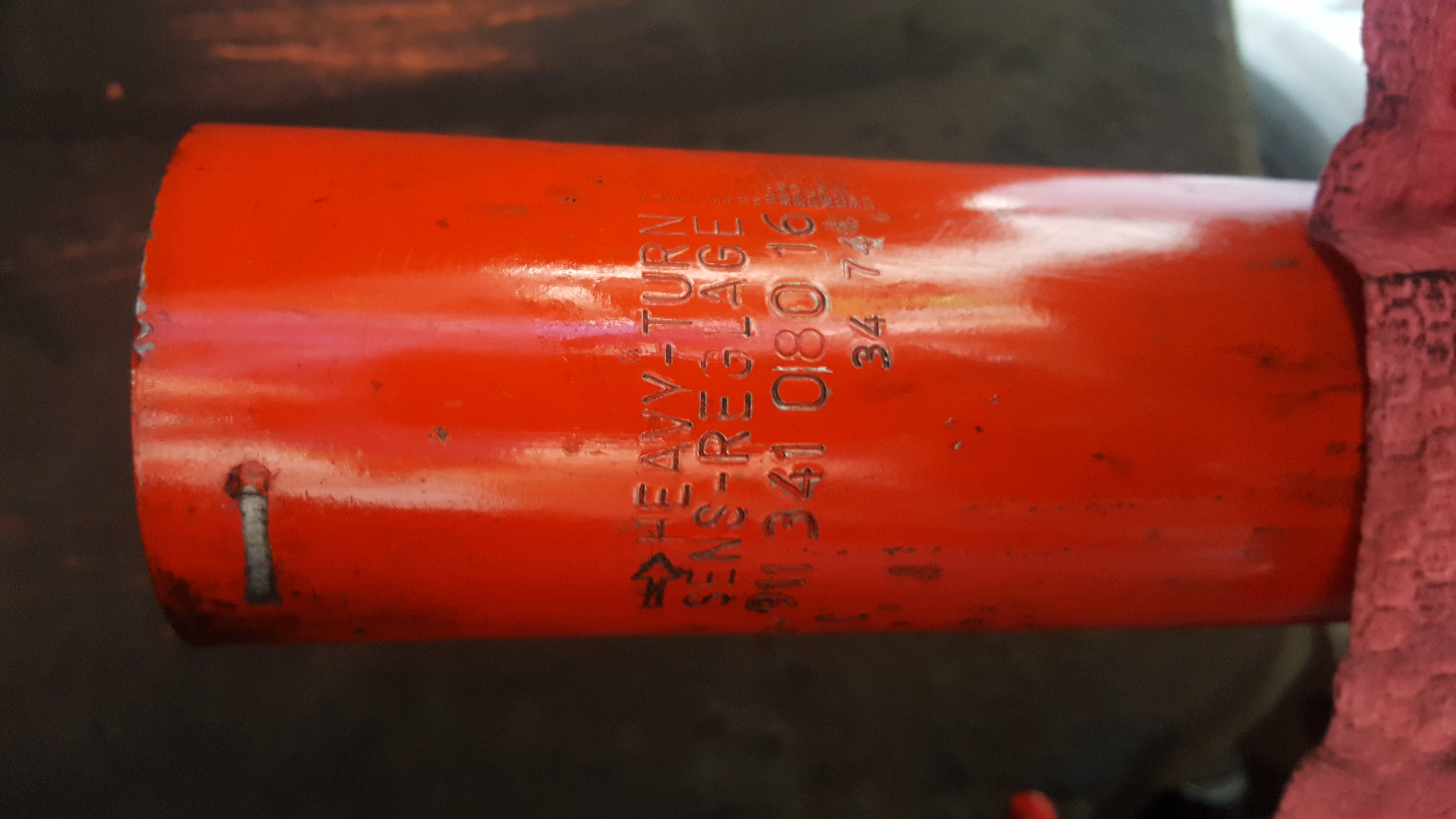

I have never seen that type of Koni insert. The numbers I am seeing says it is 75-up strut. Made week 34 1974. Wondering about spacer in bottom of tube.?
infraredcalvin
Something has to account for that tab at the bottom of the original insert.
framos914
The tab has two sides, I think on the original the shaft gets pushed down manually and catches on something to make ride adjustments. Next I'll take the strut completely out to have a good look in the housing and make there's nothing inside the housing
sixnotfour
your missing some pieces,,ie still in tube..
framos914
QUOTE(sixnotfour @ May 16 2019, 12:09 PM) *
Thanks for that picture, might be that round piece at left is still in the tube. Any Ideas on how to get it out? Hope to avoid removing the whole strut assy.
sixnotfour
QUOTE(framos914 @ May 16 2019, 02:49 PM) *
magnet and thump strut with plastic hammer
framos914
Thanks again, that was it! Got those inserts in. Used a magnet and brought it right out. The mechanic should have tried the magnet.
