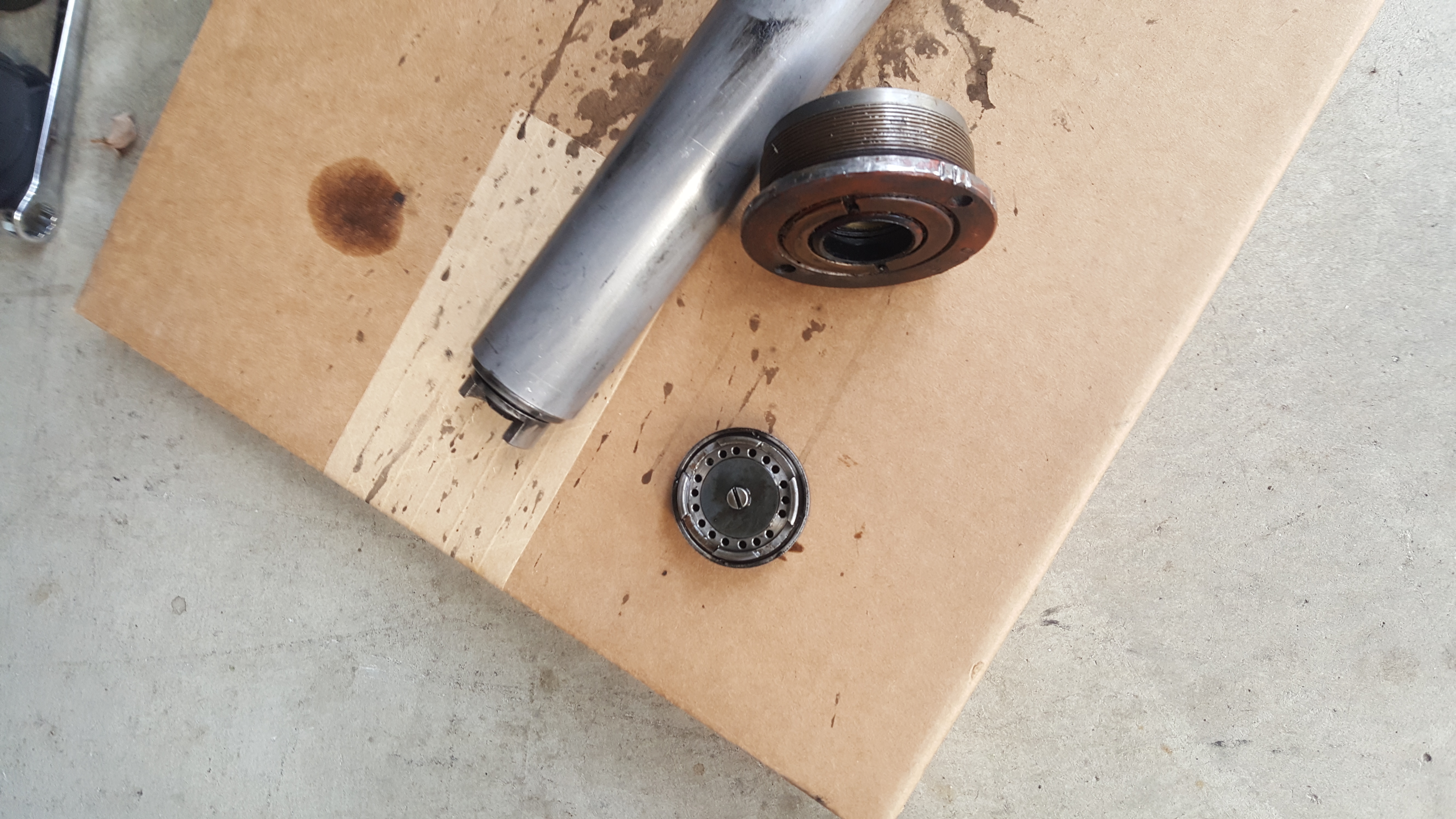

framos914   Passenger side strut   May 16 2019, 12:02 AM
framos914   RE: 911S strut assemblies   May 16 2019, 12:03 AM
framos914   Old insert   May 16 2019, 12:05 AM
framos914   New 861942 insert   May 16 2019, 12:11 AM
914Sixer   I have never seen that type of Koni insert. The n...   May 16 2019, 06:12 AM
infraredcalvin   Something has to account for that tab at the botto...   May 16 2019, 07:50 AM
framos914   The tab has two sides, I think on the original the...   May 16 2019, 10:23 AM
sixnotfour   your missing some pieces,,ie still in tube..   May 16 2019, 01:09 PM
framos914   your missing some pieces,,ie still in tube.. Tha...   May 16 2019, 02:49 PM
sixnotfour   your missing some pieces,,ie still in tube.. Th...   May 16 2019, 03:18 PM
framos914   Thanks again, that was it! Got those inserts...   May 16 2019, 09:57 PM
