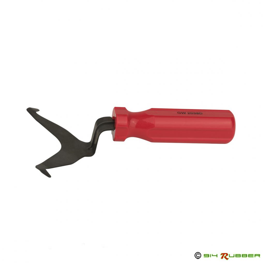

We do stock the trim removal tool if you need it and the new improved version of the clips.

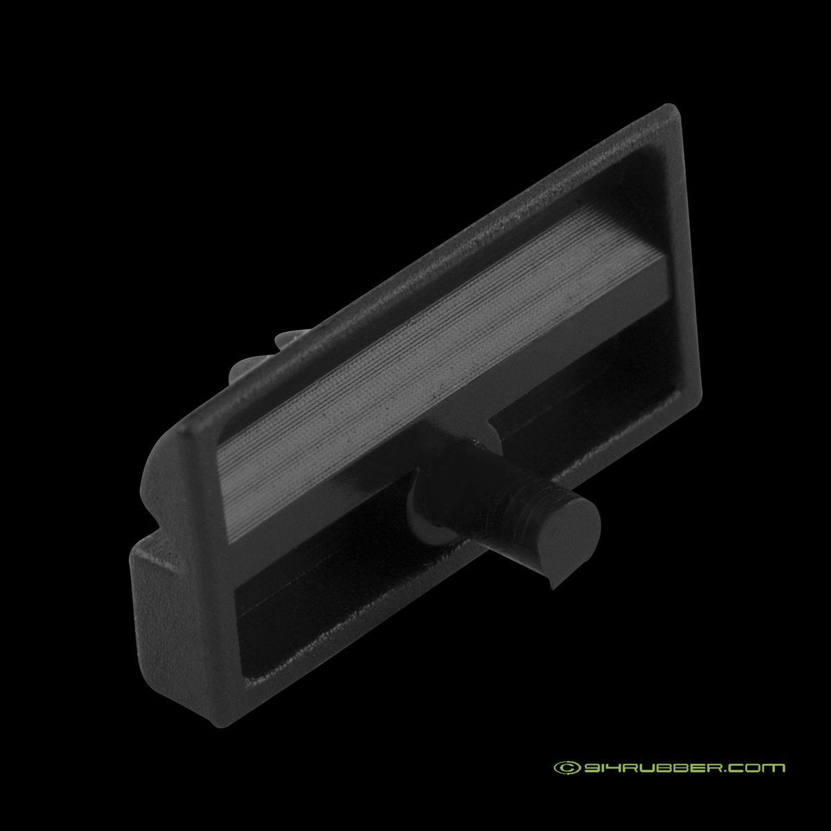

I've been working on my windshield and received the new trim clips from 914Rubber, they are really great.

Thanks we did make some improvements to hopefully make them last longer as well as a sllight design change. (IMG:style_emoticons/default/biggrin.gif)
