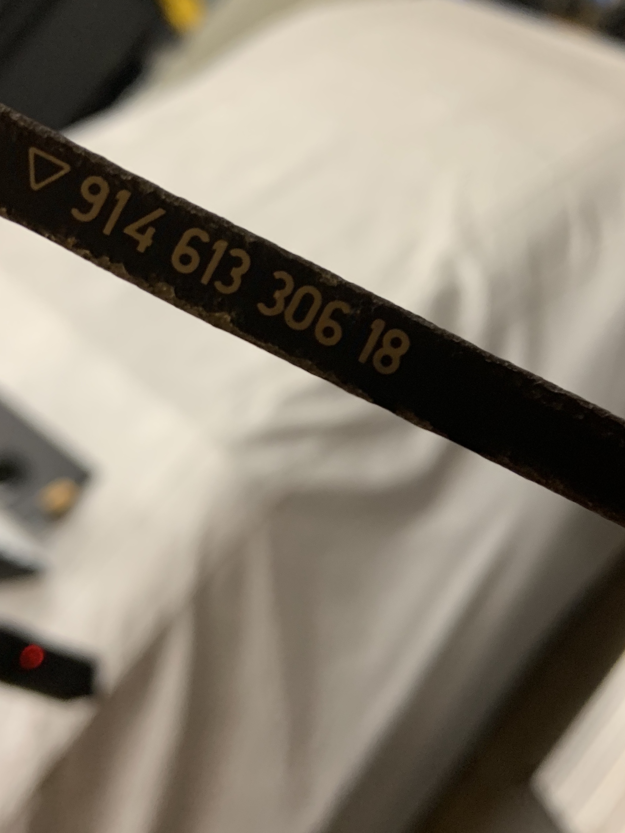

Yeah, I saw that...tryign to figure out if the one on there is the correct one or not....Here is a pic of the bottom with a part number...crazy thing is that part number shows up as ignition switch in most places i look...not a wiper switch...so not sure if it's the correct switch or not...
914 613 306 18
914Sixer
post May 16 2019, 03:34 PM
Posts: 9,488
Joined: 17-January 05
From: San Angelo Texas
Member No.: 3,457
NLA switch for a long time. 75 VW Rabbit will interchange. They are rare also. I backdated my column to a 74 and used the 75 ignition switch. Easy swap.

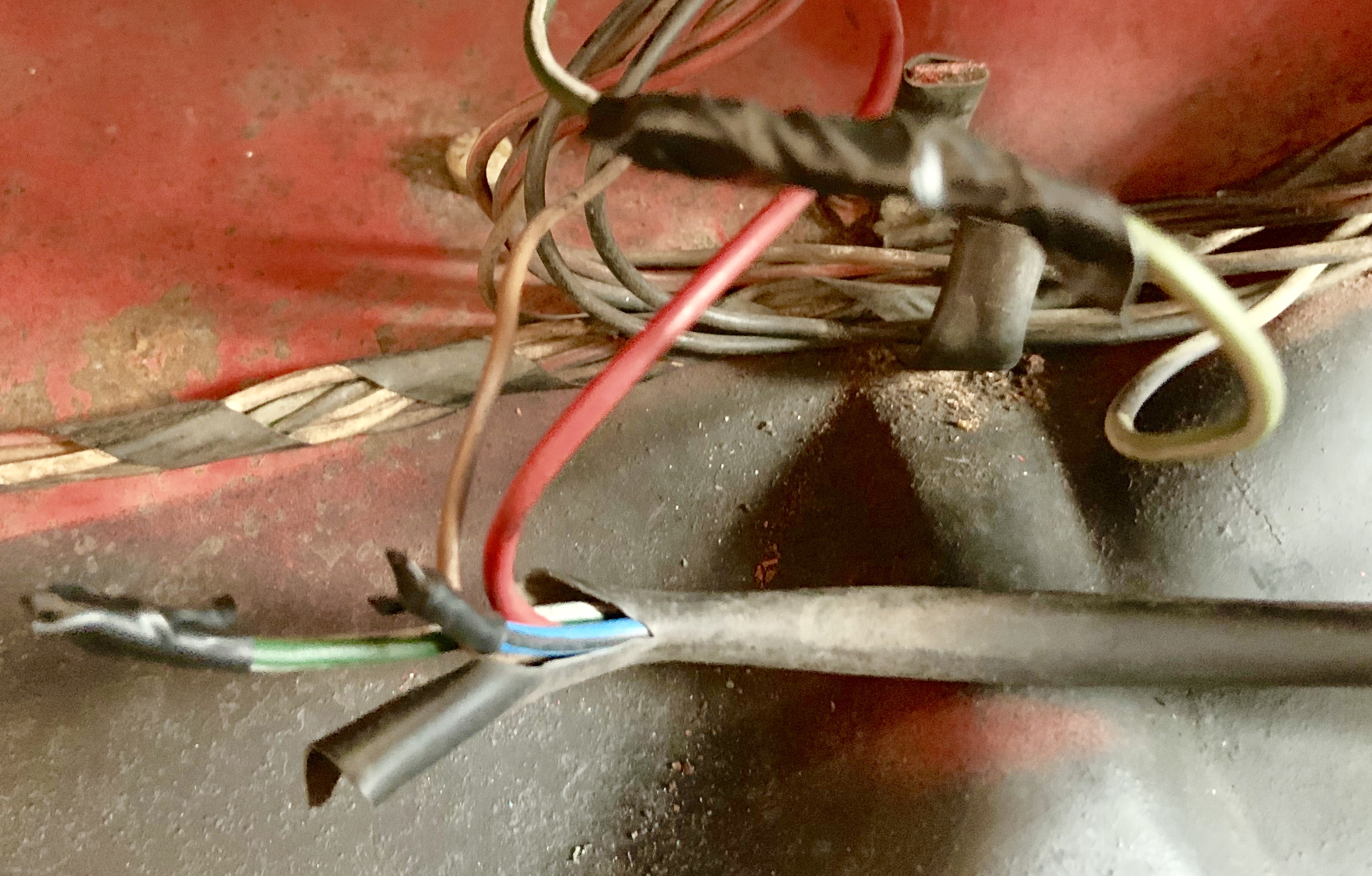

Finally got it all sorted - never got to the final reason the intermittent would stay on when in off position. I don’t care about intermittent so....
I capped off the green and blue/black coming from relay.
Then took the green from wire harness to green on the motor
I now have
OFF in lower positions
And low and high in the upper.
Didn’t have to buy anything (IMG:style_emoticons/default/smile.gif)
