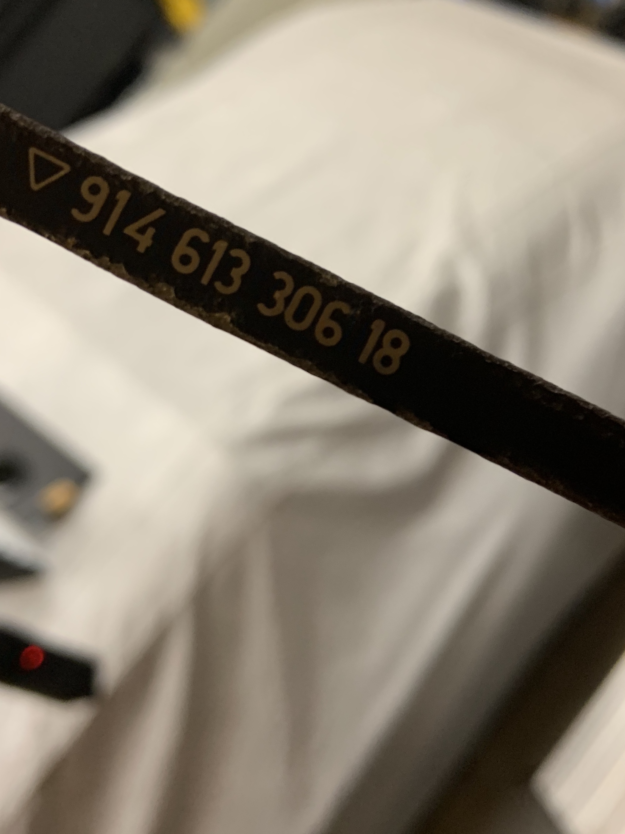

Yeah, I saw that...tryign to figure out if the one on there is the correct one or not....Here is a pic of the bottom with a part number...crazy thing is that part number shows up as ignition switch in most places i look...not a wiper switch...so not sure if it's the correct switch or not...
914 613 306 18
914Sixer
NLA switch for a long time. 75 VW Rabbit will interchange. They are rare also. I backdated my column to a 74 and used the 75 ignition switch. Easy swap.
