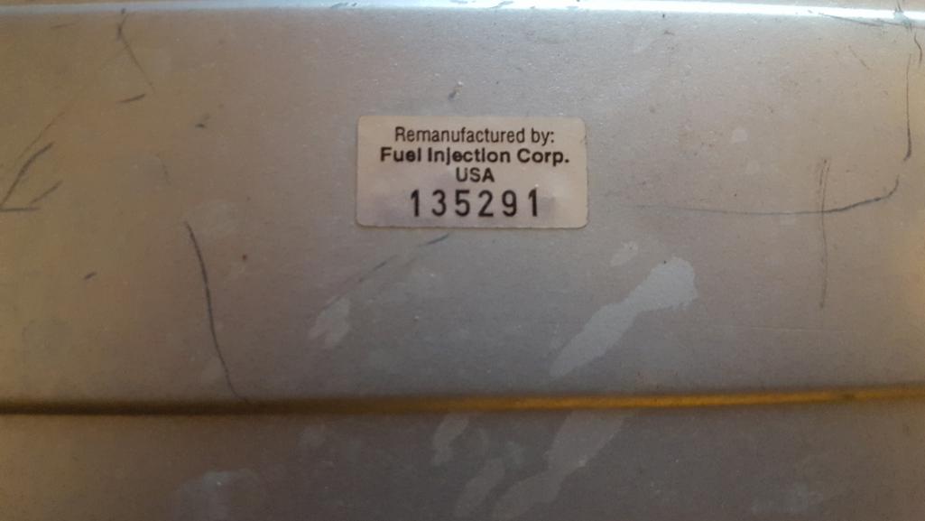

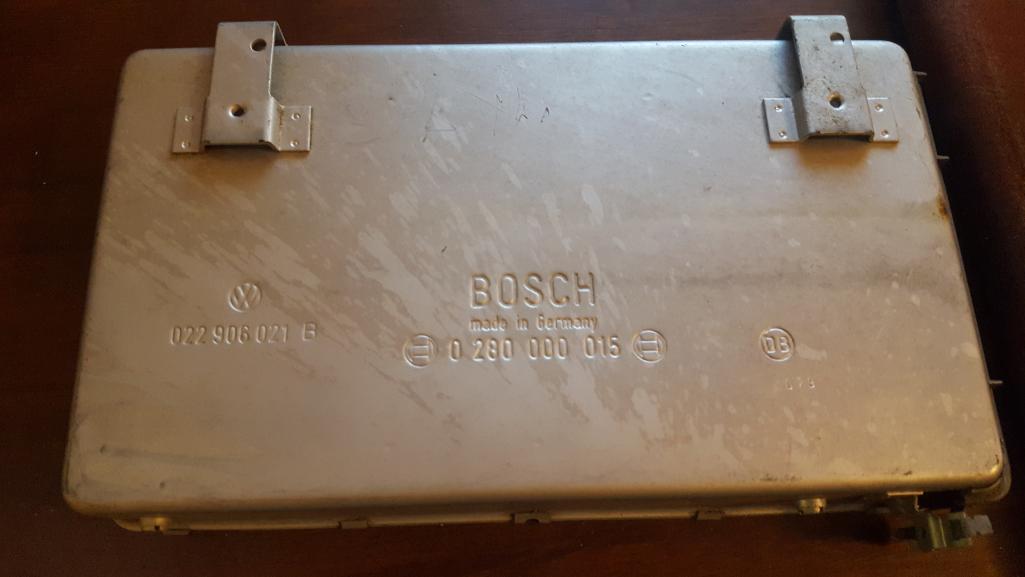

yellowporky
post May 19 2019, 12:12 PM
Posts: 437
Joined: 18-October 09
From: Martinez, Ca.
Member No.: 10,948
http://www.914world.com/bbs2/index.php?sho...=313564&hl=
I have one for sale on this board that is the correct part # for your car and was refurbished by fuel injection corp in Tracy Ca.
Chris
