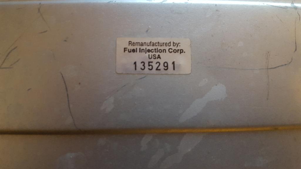

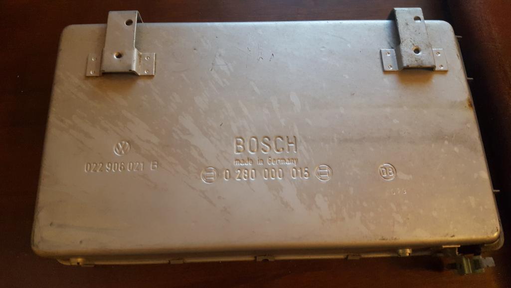

I have one for sale on this board that is the correct part # for your car and was refurbished by fuel injection corp in Tracy Ca.
