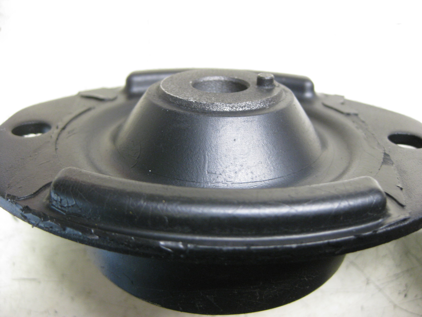

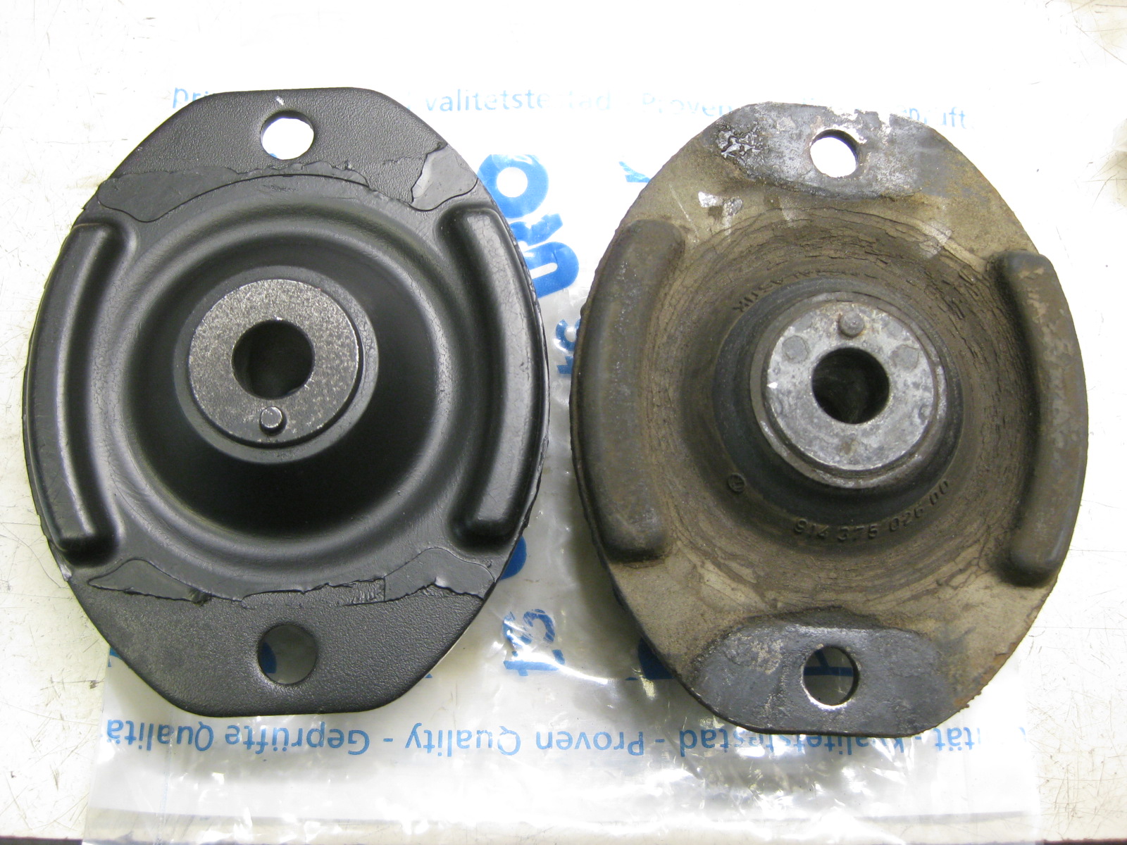

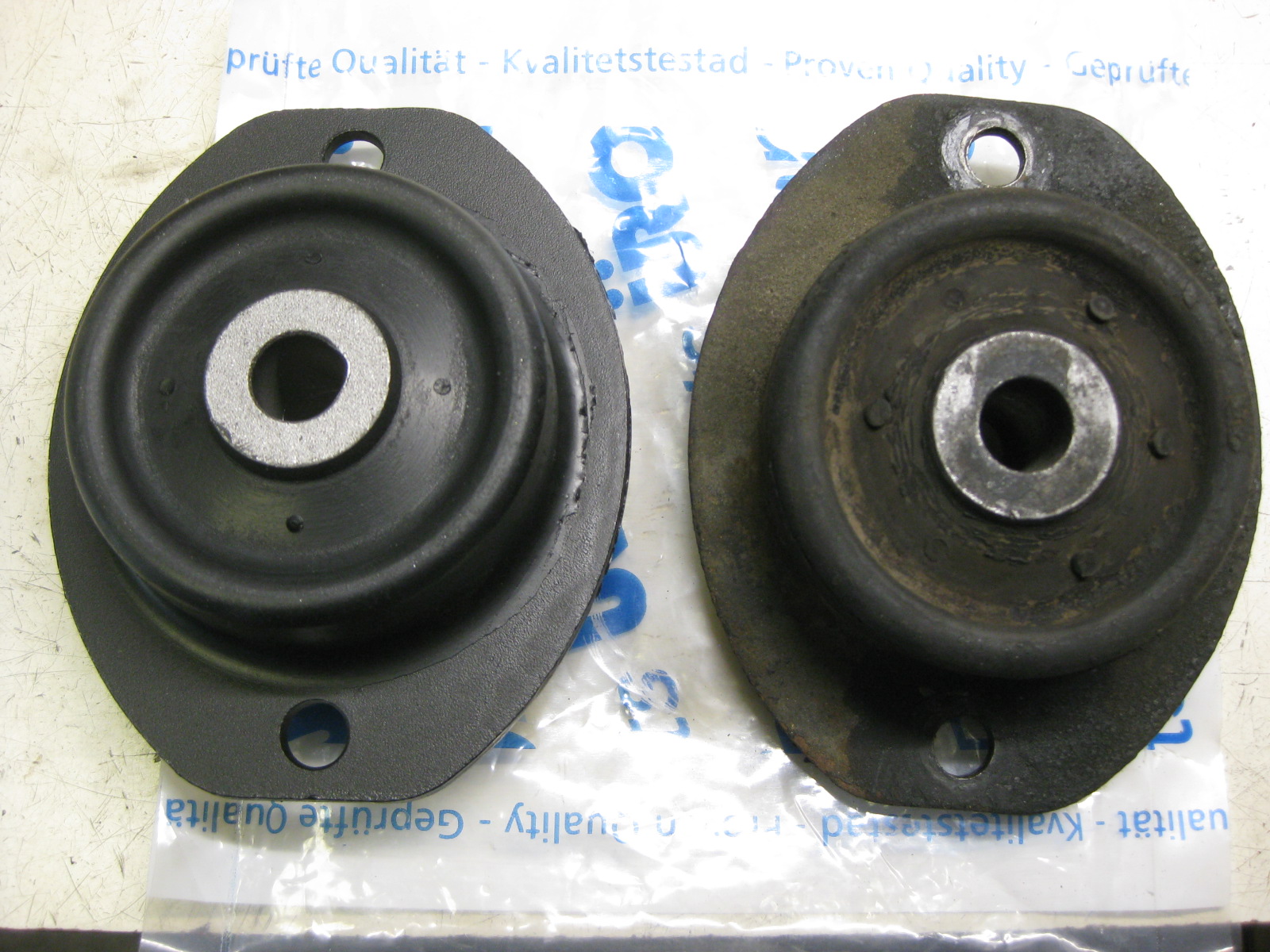

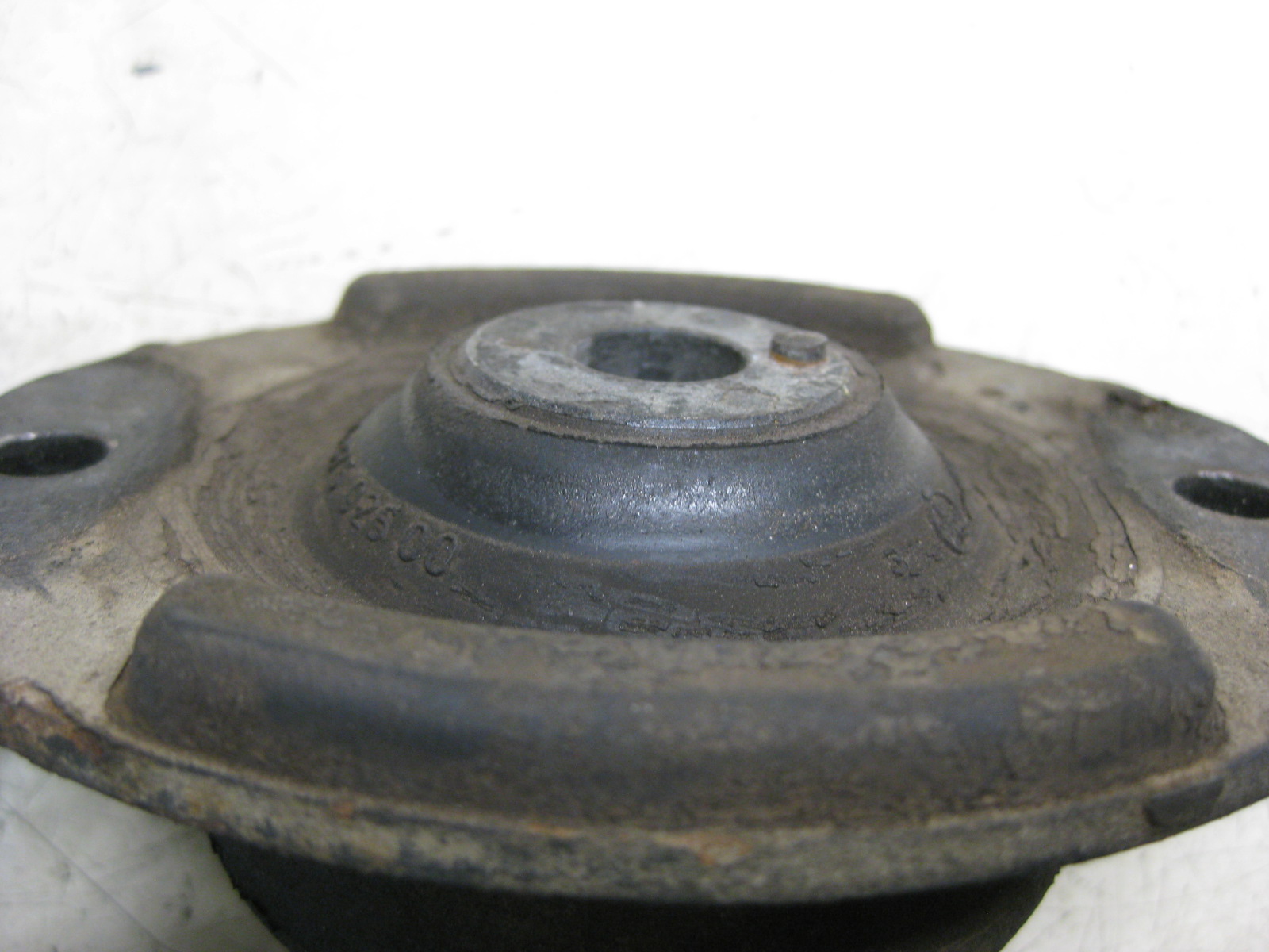

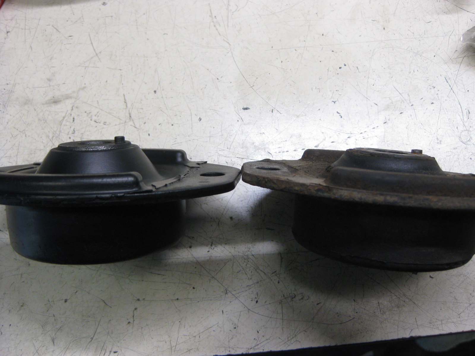

John,
I recently installed on my original 914-6 the URO 914-6 trans mounts and just haven't felt like dropping the engine to install the URO front mount yet.
Both the front and trans mounts are nice reproductions of the original parts.
I'm pleased with the quality of the parts and the price.
Time will tell on the wear properties....
Here are a few pics of the URO trans mount compared to the OEM one.
It's obvious that the old one has compressed over the years.

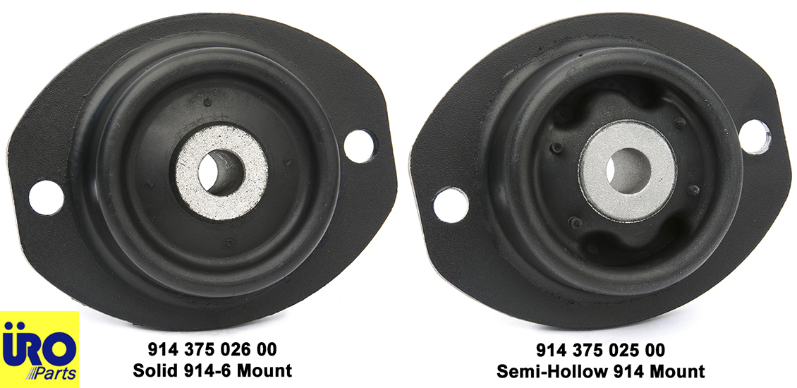

The reproduction trans mount is a 914 6 item...no voids and different part number.
Just curious, do they make a 4cyl. too ?

Yes, they make the -4 mount. Why buy it when the solid -6 mount is the same price? Weakness of the 4-mount was the holes in the rubber.

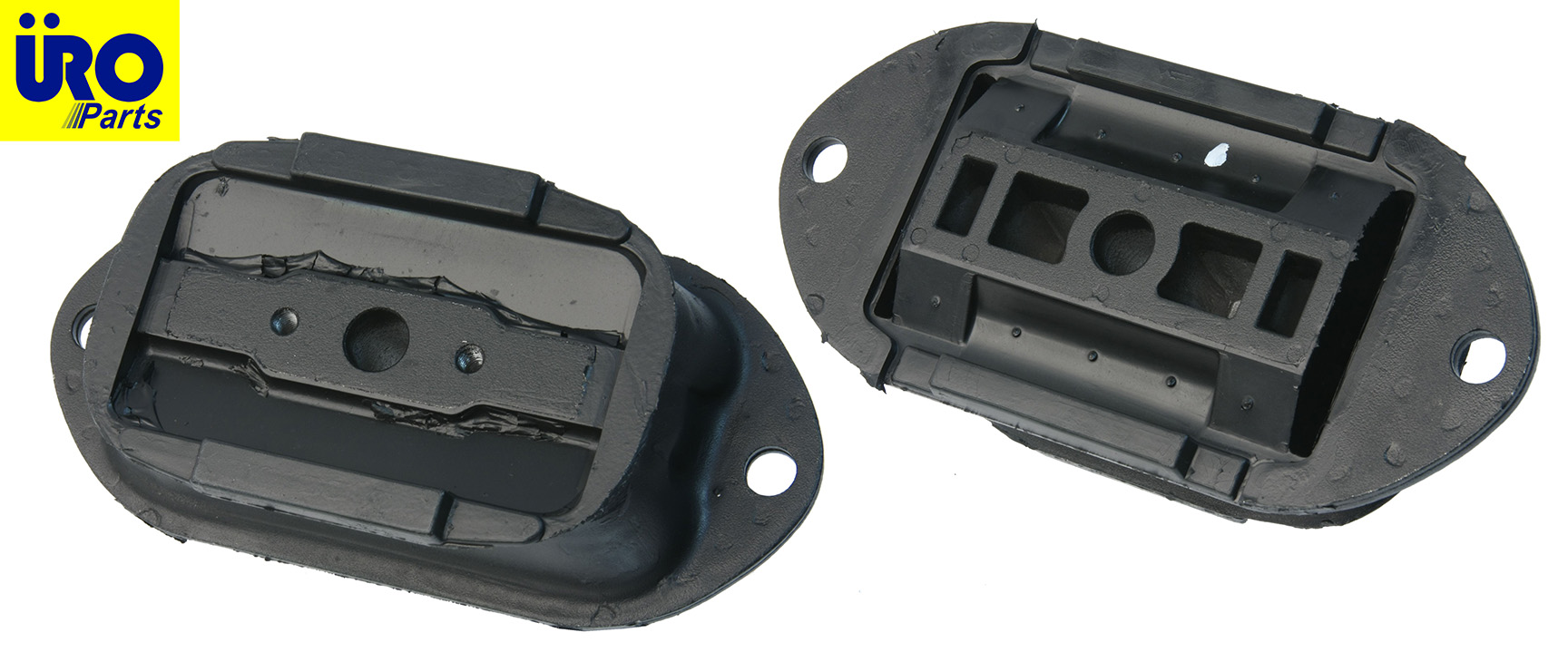

Back to the topic; URO has two versions of this engine mount, one with OE durometer rubber (914 375 049 00) and a Heavy Duty "Club Sport" Version (914 375 049 00HD) that's 30% stiffer.

Mark I asked the question purely out of curiosity.
The 6 mount is certainly the better replacement choice.

We do offer both types, but there really isn't much reason to use the semi-hollow 4-cylinder mount, unless the driver desires the smoothest possible operation.
