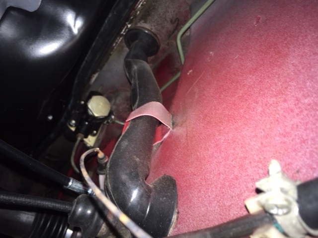

The 914Rubber snorkel is patterned after a six which does have a longer snorkel. My work around was to put what I call the "reverse foreskin fold" into the end to shorten it. Hey, you started it! (IMG:style_emoticons/default/lol-2.gif)
http://www.914world.com/bbs2/index.php?showtopic=321374
(IMG:http://www.914world.com/bbs2/uploads/post-20845-1514318731.jpg)

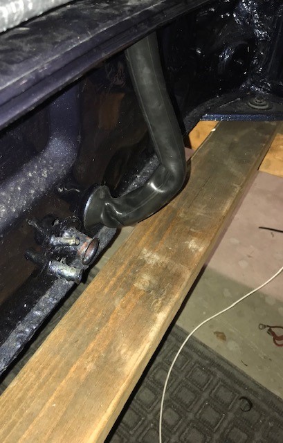

Yes the hole is an issue on the later car's (IMG:style_emoticons/default/mad.gif) .. This is my car.. Attached Image

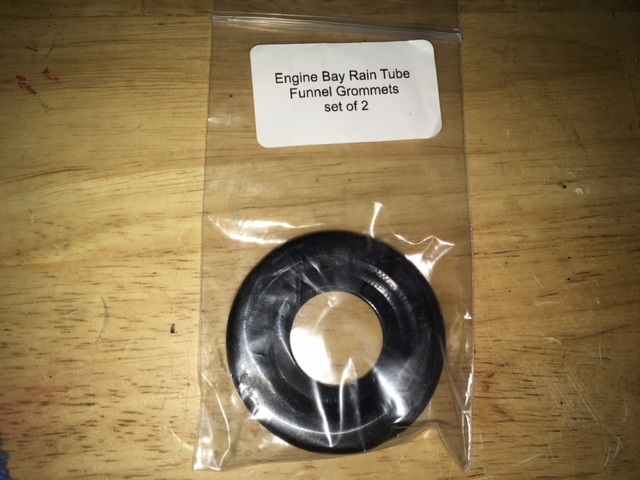

I had the same issue. Get a rain tube grommet from 914rubber and fit it in the slot at the top of the snorkel. It fits the hole perfectly. You'll have to revisit it a few times because the edge of the small grommet will want to work it's way out of the slot around the snorkel. It's a nice tight fit once in place and looks great!
