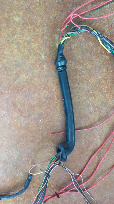

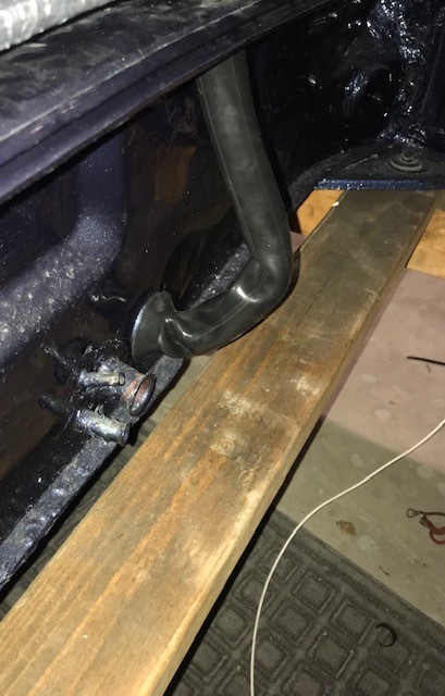

Installed the harness and added the snorkel but it's bent. It's just too long to fit properly. I got it from 914rubber.
Anyone else have an issue with their snorkel being too long? 134.gif Ok let the jokes rip but, tell me how to fix this please. It looks hideous!

The 914Rubber snorkel is patterned after a six which does have a longer snorkel. My work around was to put what I call the "reverse foreskin fold" into the end to shorten it. Hey, you started it! lol-2.gif

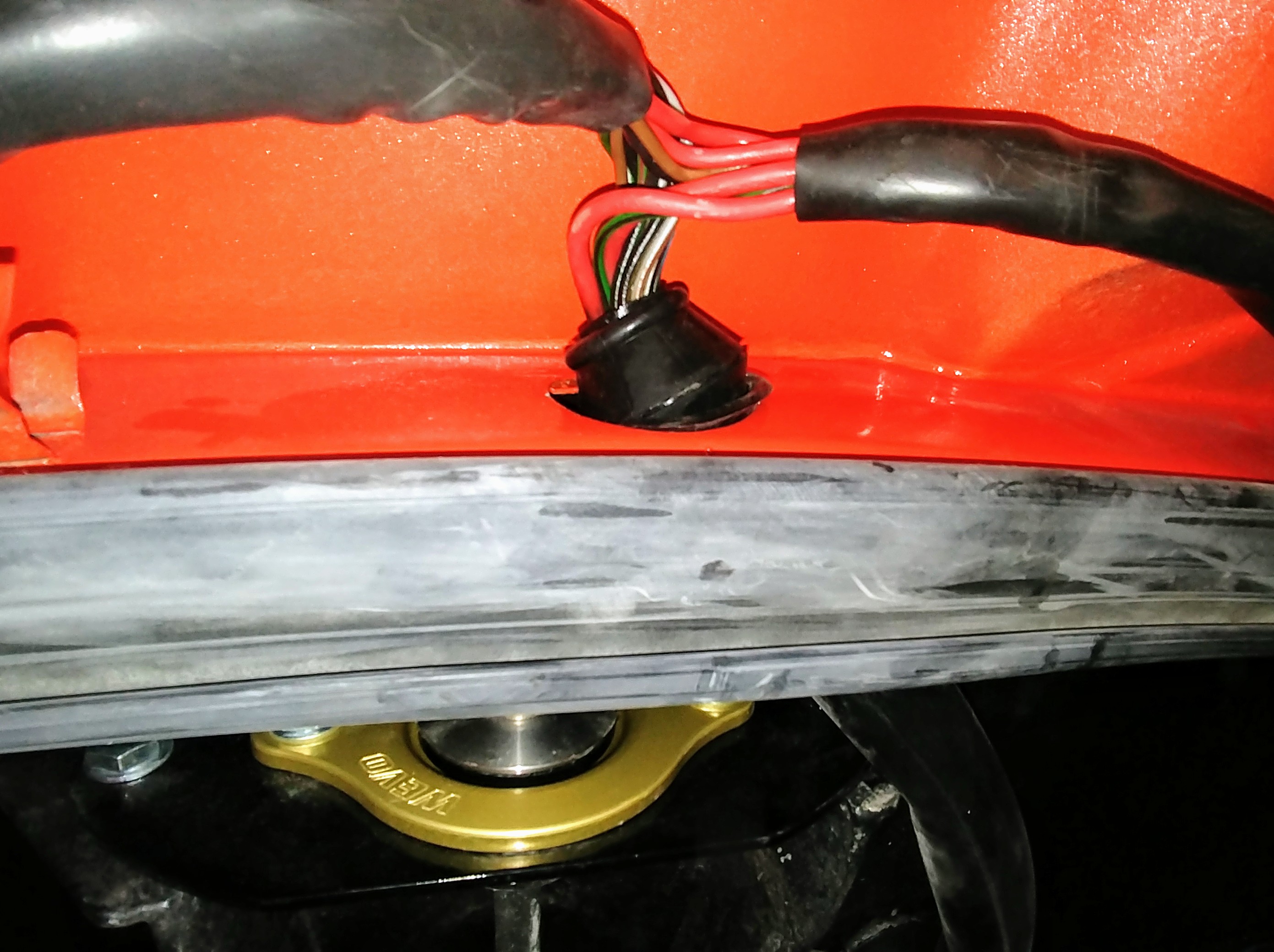

Yes the hole is an issue on the later car's mad.gif .. This is my car.. Click to view attachment

So @bbrock What your saying is a reverse circumcision? Are there Mohel's that specialize in this?
I think that is the route I will attempt. The only other fix I could come up with would be to cut it and try to glue it back together. Your idea is probably safer.

Saigon cut and used a black waterproof tape (not electrical). Didn’t look stock but looked secure.

I had the same issue. Get a rain tube grommet from 914rubber and fit it in the slot at the top of the snorkel. It fits the hole perfectly. You'll have to revisit it a few times because the edge of the small grommet will want to work it's way out of the slot around the snorkel. It's a nice tight fit once in place and looks great!

I ran into the opposite problem, my snorkel was too big to fit the hole in the shelf.
I did not realize there were different sizes and spent quite a bit of time trying to get it in.
After researching i ordered a new snorkel from 914rubber and it is a little long so I just curved it a little, does look the greatest but it works.

Curving is the technique to use you can loose an inch.
