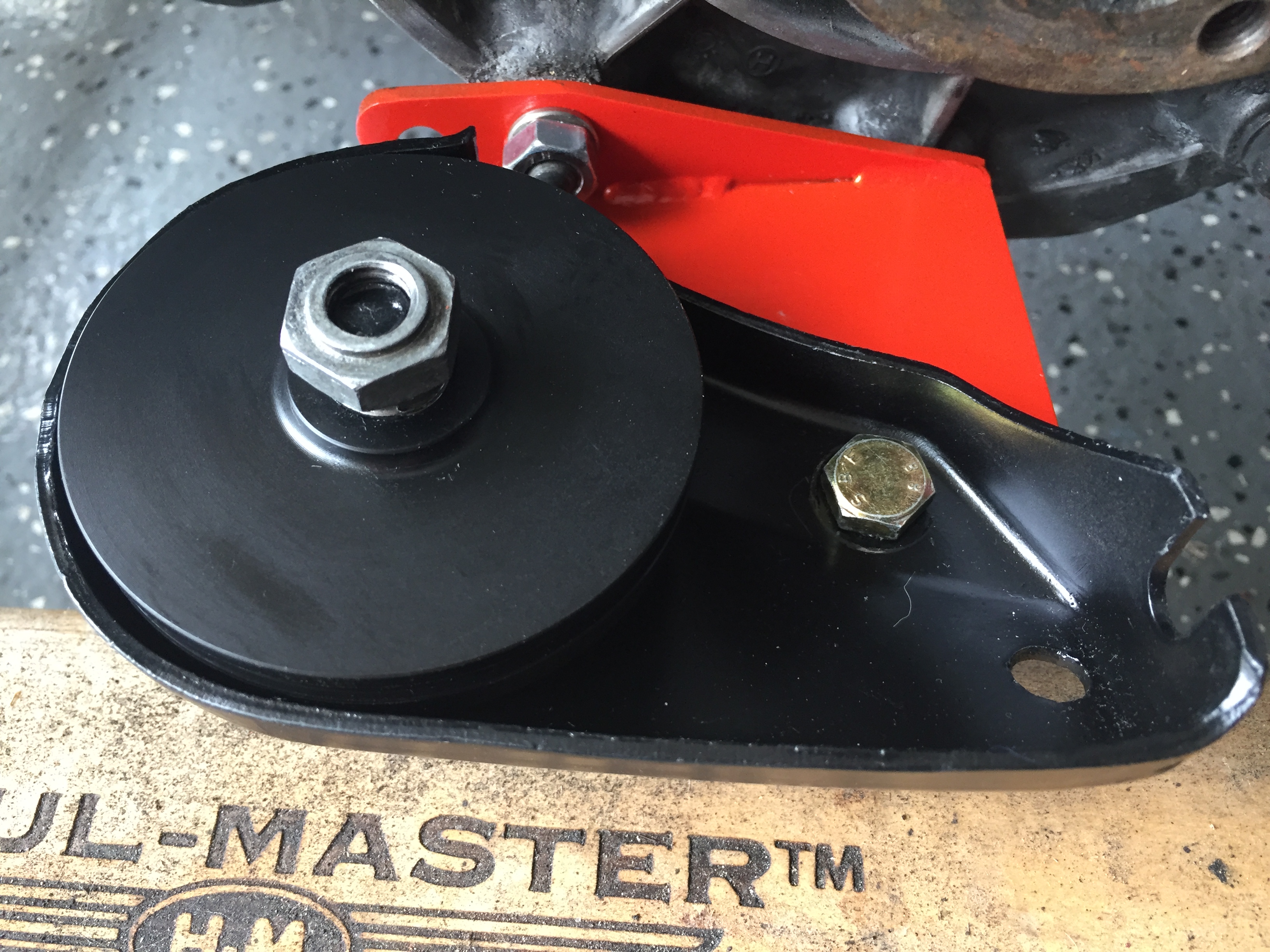

While the guys are giving you the deal on cables, I thought I would add in a link to Tangerines Clutch Pulley Adaptor. It takes some of the stress out of the cable as well.
http://www.tangerineracing.com/transmission.htm
Chris will tell you, "Relocates the clutch pulley to a horizontal position for better ground clearance and improved cable routing to clear exhaust header systems. Two sets of mounting holes allow adjustment for clutch cables that are too long, a common problem."
Hope this helps a little as well. Grant

Chris at Tangerine makes great stuff, I have this part on my car! And, I used the Patrick Delrin pulley.

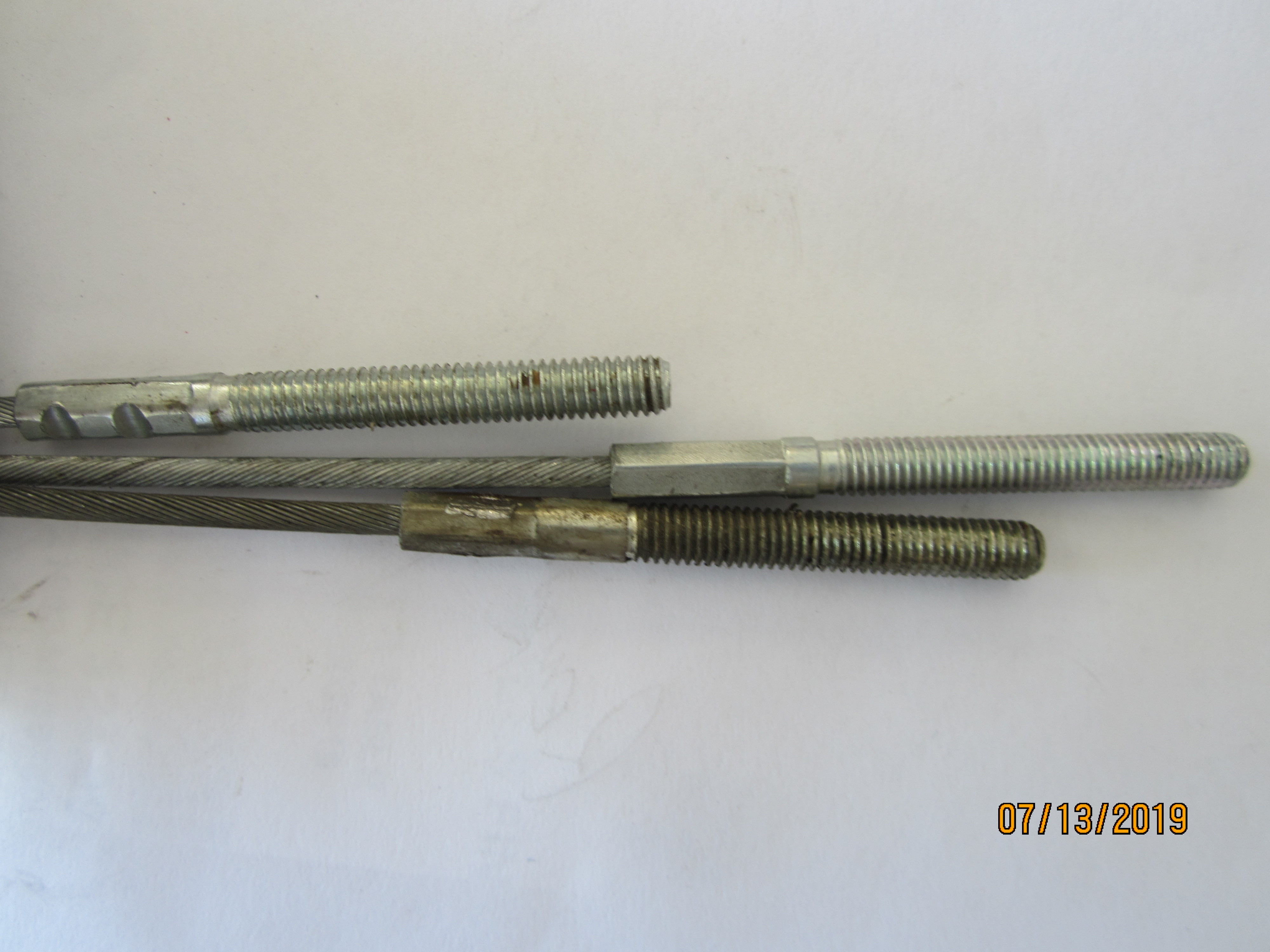

OK. My new 914-6 GEMO clutch cable arrived yesterday and I promptly removed the old one from my 1976-4. Have not yet installed the GEMO. It is marked "Made in Germany" so that is somewhat reassuring.
My "original" cable may not be original to my car as it does not have a plastic sheath for the cable portion that runs through the tunnel. Cables for the 914-4 should have this plastic sheath.
I also found an NOS, 914-4 Cofle cable among my spare parts so I am including measurements for it, too. This cable does have the plastic sheath.
The metal cable diameter for all three clutch cables is 0.11 in.
The black sheath for the GEMO cable, including metal ends, is 1.12 in. shorter than the other two cables.
Regarding overall length, the GEMO is 1.43 in. shorter than the removed cable and 2.43 in. shorter than the Cofle cable.

I measured some NOS cables I had, the 6 cables were slightly larger in diameter.
