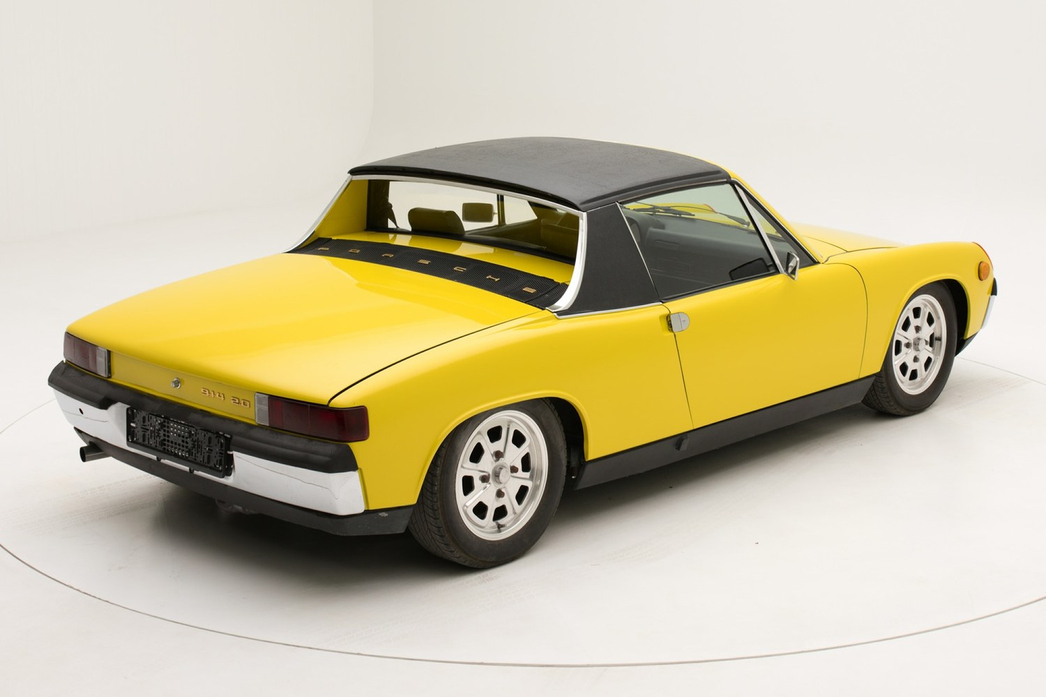

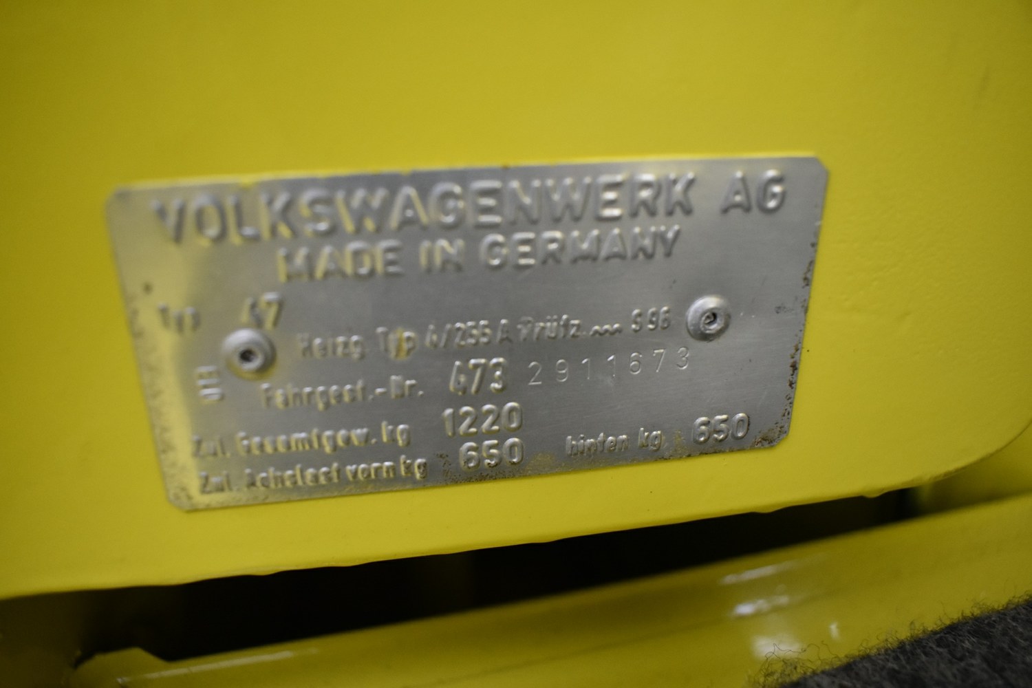

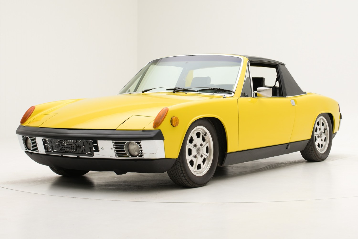

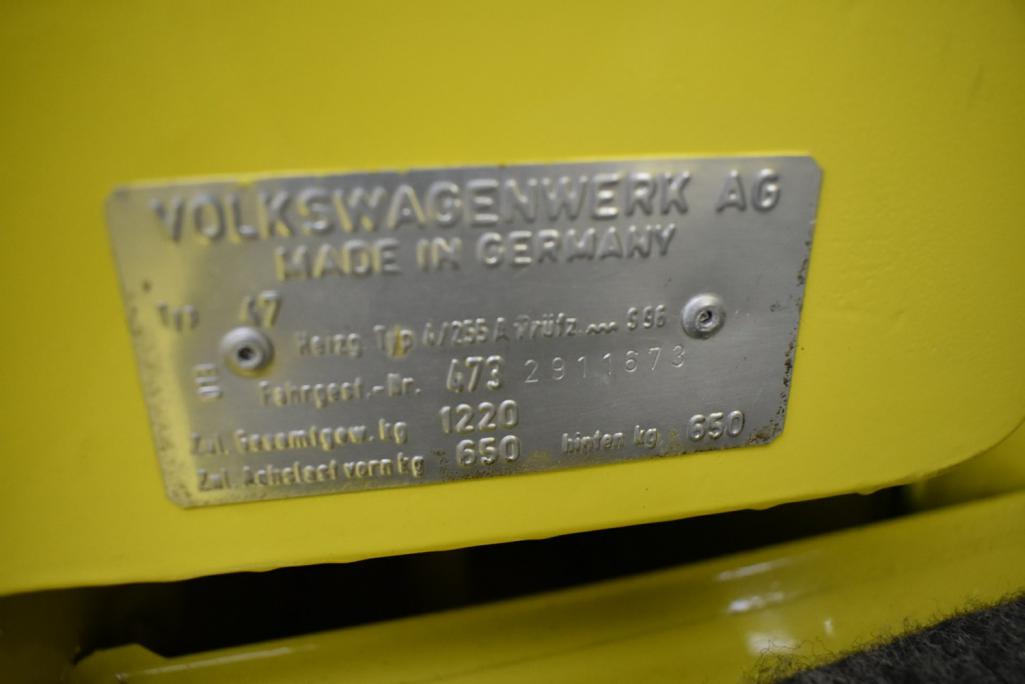

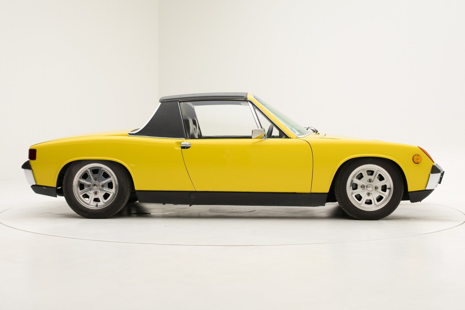

There is a yellow 1973 2.0 at auction over here. Car is ex usa and found the vin in the database. Vin nr (4732911673) was registered by a member here but I noticed that his last post dates february 2019. I've sent him an email but sofar no reply.
Looked through his posts but not sure if he speaks about the same car.

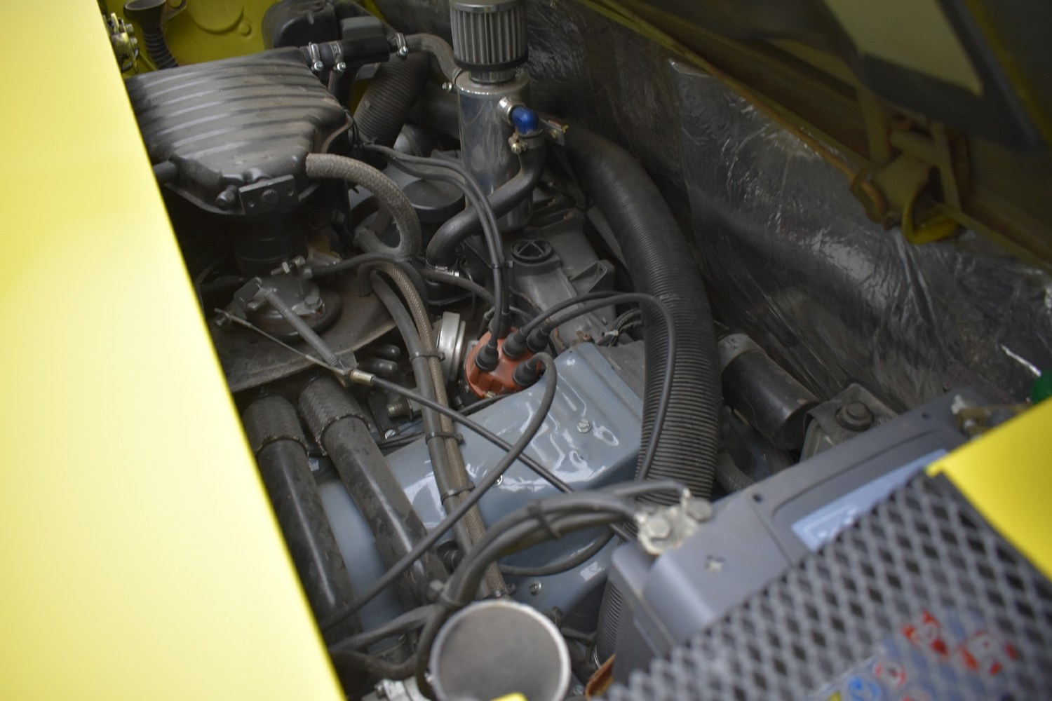

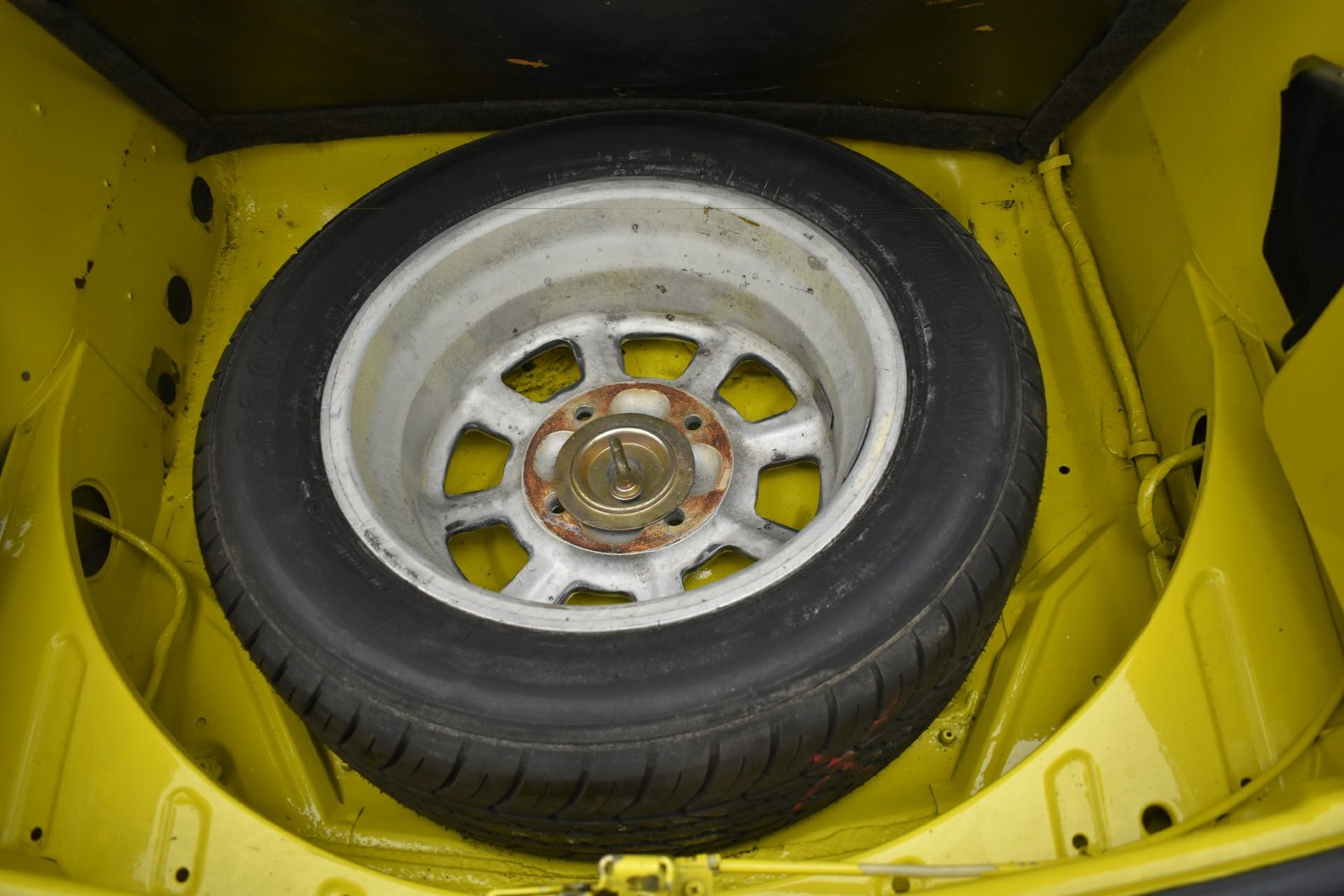

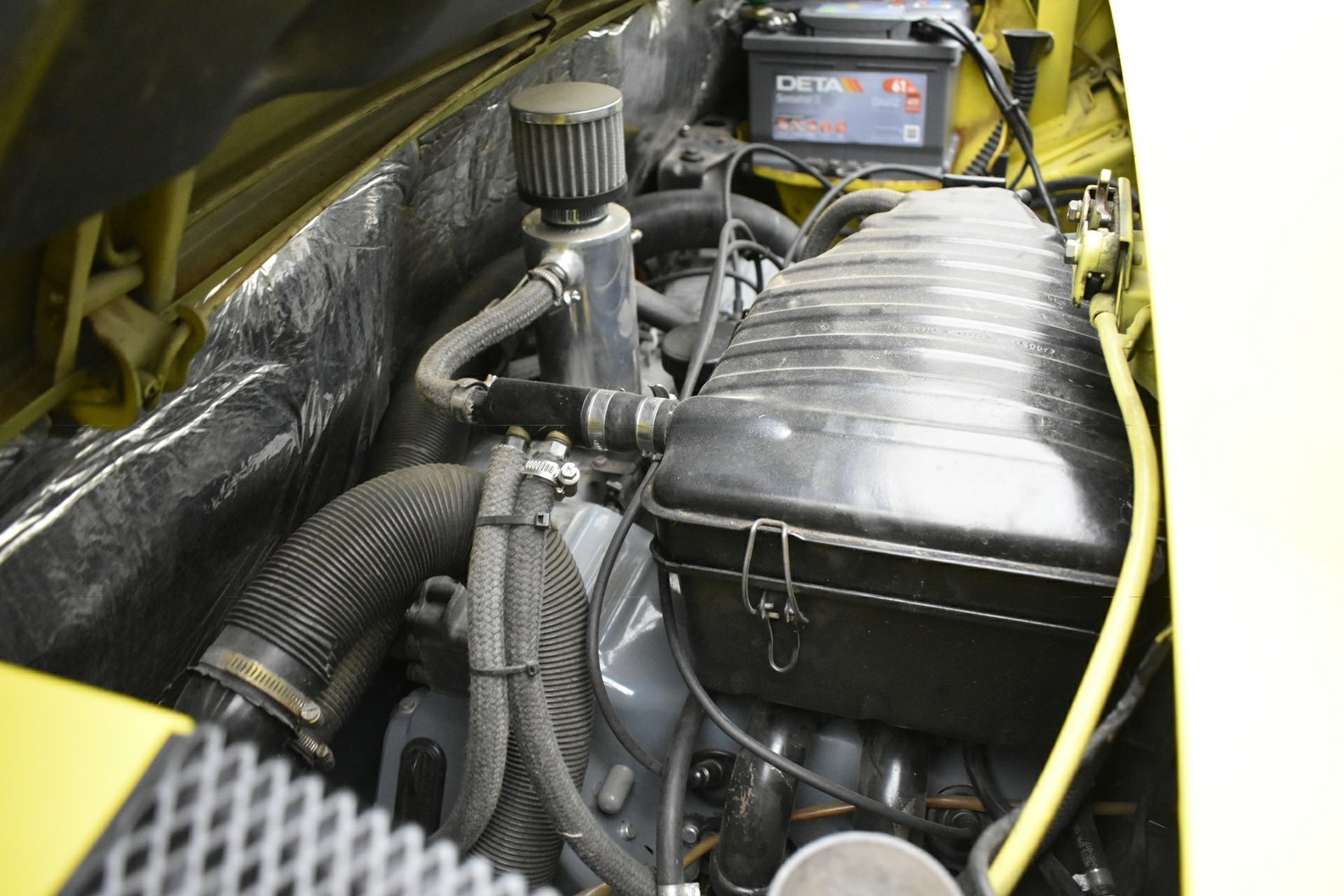

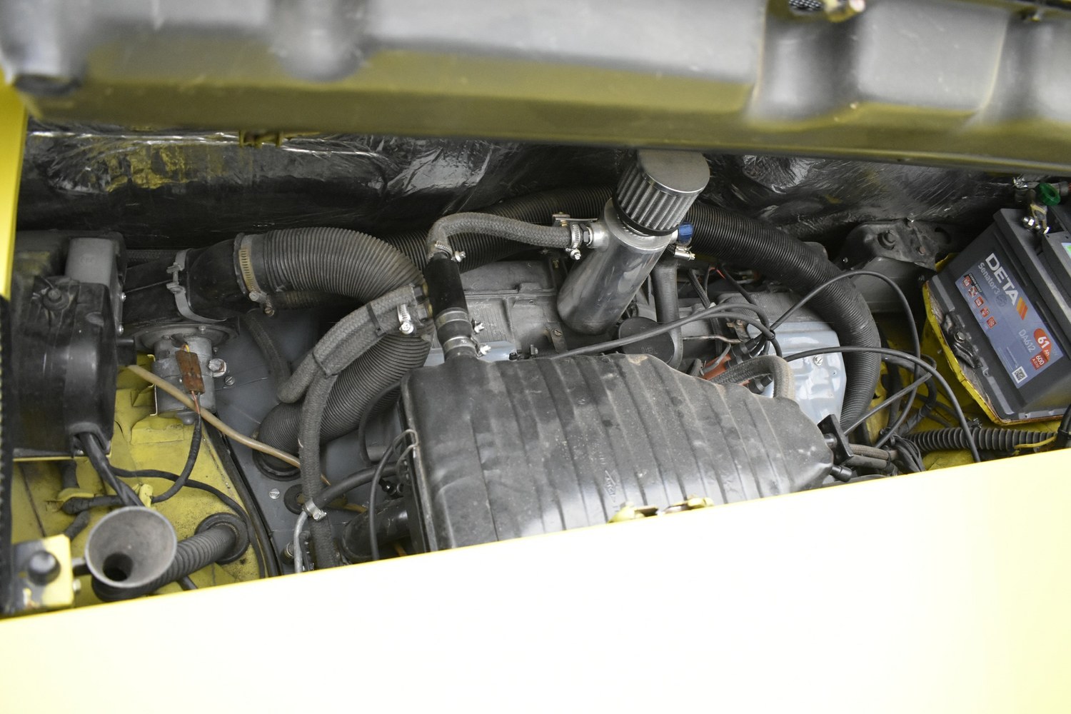

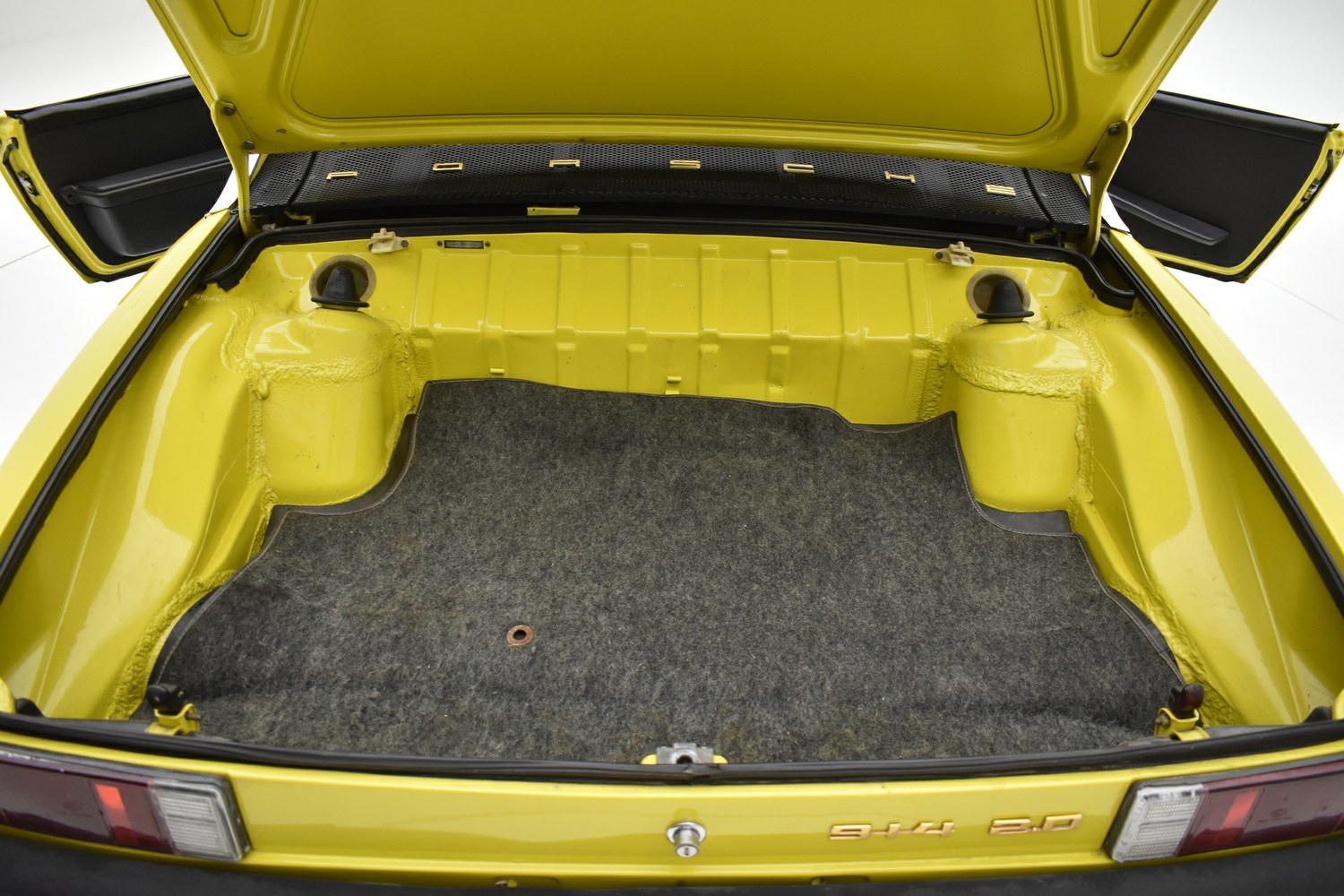

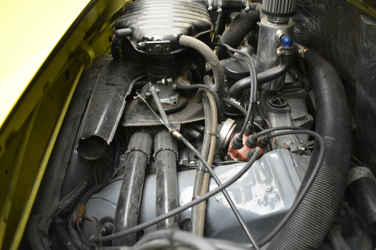

Car looks good in the pictures but I would like to receive comments from you specialists. Any idea what the "filter" is on the engine ? Car has chrome bumpers which I like. Car looks repainted (overspray on cables, shocktowers etc)... Noticed 3 holes in the frunk...is this fm an airco ? Did not post the colorcode tag as this is fairly unreadable. I can see the car in the flesh on 13/8 and auction closes 20/8.

falcor75   It feels like those pictures has been heavily fixe...   Aug 6 2019, 05:55 AM
rick 918-S   Painted the wire harness in the frunk. :barf:   Aug 6 2019, 06:10 AM
gereed75   Hard to say much from these pix as they do not sho...   Aug 6 2019, 06:15 AM
mepstein   Unless it’s cheap, I would never buy a car off p...   Aug 6 2019, 06:50 AM

JeffBowlsby   Is that an espresso machine by the oil filler towe...   Aug 6 2019, 07:41 AM
cwpeden   Looks like he sold it in 2014: http://www.914worl...   Aug 6 2019, 07:47 AM
dax1969   Looks like he sold it in 2014: http://www.914wor...   Aug 6 2019, 08:46 AM
jim_hoyland   Looks like he sold it in 2014: [url=http://www.9...   Aug 6 2019, 09:25 AM
jim_hoyland   Added to VIN database...   Aug 6 2019, 08:52 AM

Mikey914   Looks like a great "project" car. You wi...   Aug 6 2019, 10:04 AM
Carl La Fong   Looks like a great "project" car. You w...   Aug 6 2019, 10:21 AM
rhodyguy   Very crappy respray. Not bothered to even remove t...   Aug 6 2019, 12:29 PM

mb911   8000 euros seems like allot but prices are on the ...   Aug 6 2019, 03:10 PM
sixnotfour   @dax1969 here is his email: or was John E-mail...   Aug 6 2019, 03:28 PM
dax1969   [b]@[url=http://www.914world.com/bbs2/index.php?s...   Aug 7 2019, 03:05 AM

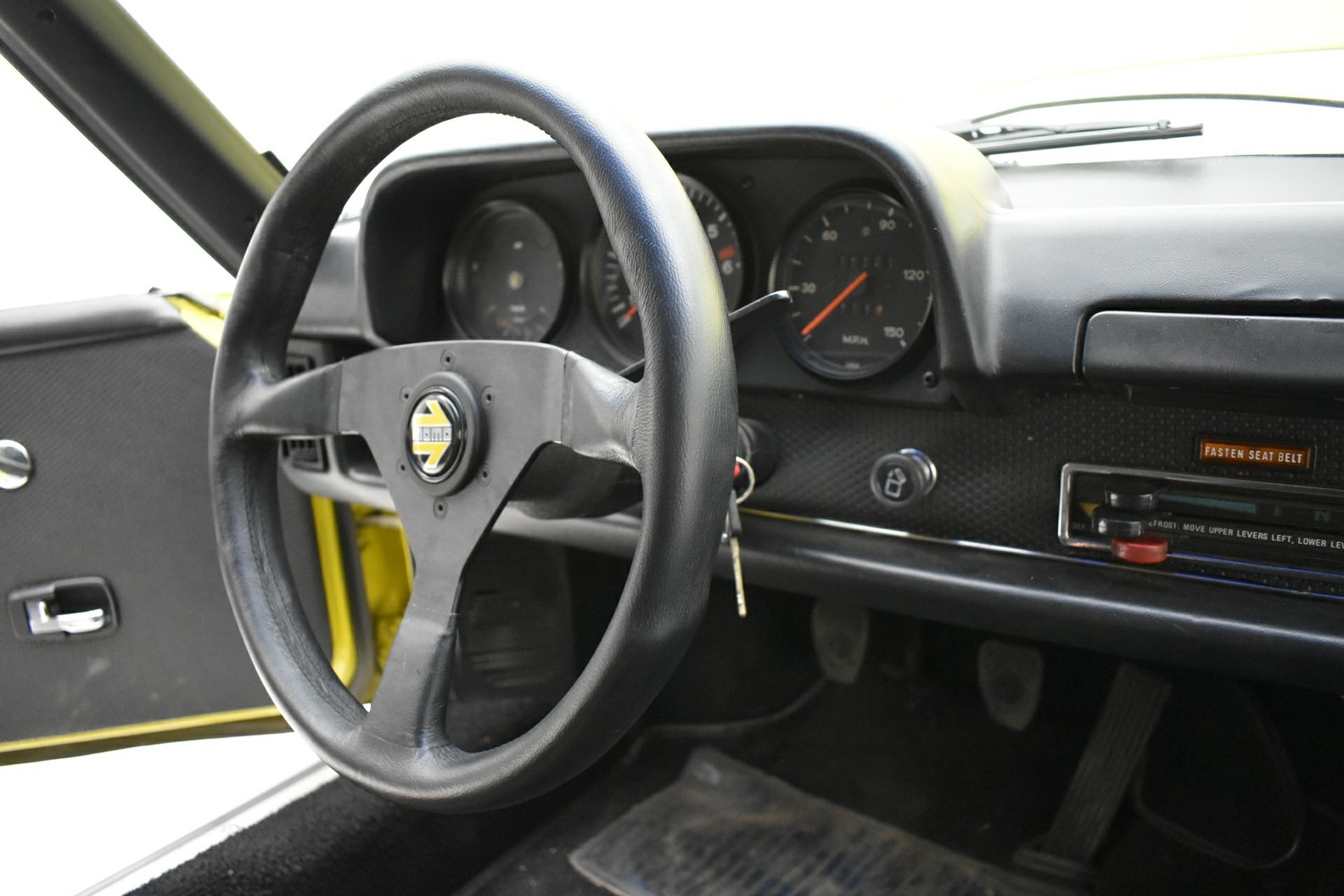

Dave_Darling   Lot of weird stuff on that car... The gold emblem...   Aug 6 2019, 03:28 PM

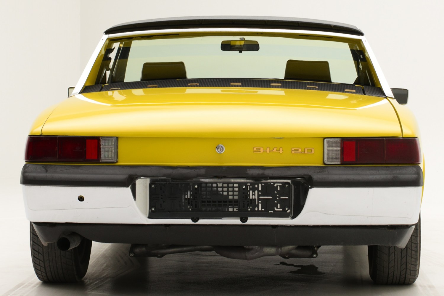

Valy   The rear passenger side wheel looks different then...   Aug 6 2019, 09:22 PM
SirAndy   Do i see a oil puddle under the car? :unsure:   Aug 6 2019, 09:28 PM
