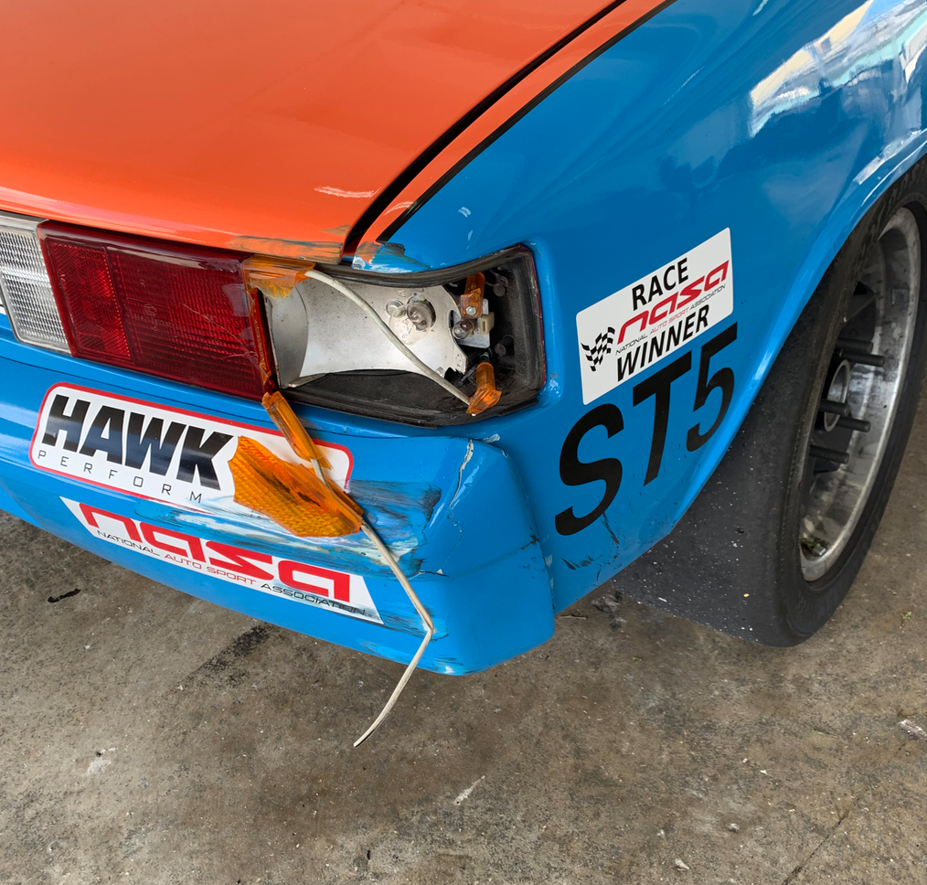

Thinking this will buff out. (IMG:style_emoticons/default/smash.gif)

Not too bad! Sound worse on the video.

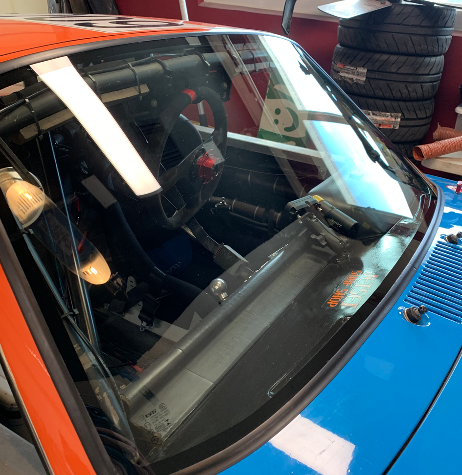

New windshield installed. Thanks to 914Rubber for the new seal. (IMG:style_emoticons/default/beerchug.gif)

Add some metal tabs. Not only do they work, they look cool too ...

Was the one that flew out put in with butyle or urethane?

Not sure what was used last time. It wasn't in there very good. The guys that installed it this time used urethane.
Will be making some tabs too.
