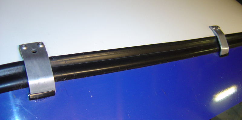

pete000
post Aug 29 2019, 12:02 PM
Post #25
Posts: 1,887
Joined: 23-August 10
From: Bradenton Florida
Member No.: 12,094
That's why the race cars use hold down clips !
