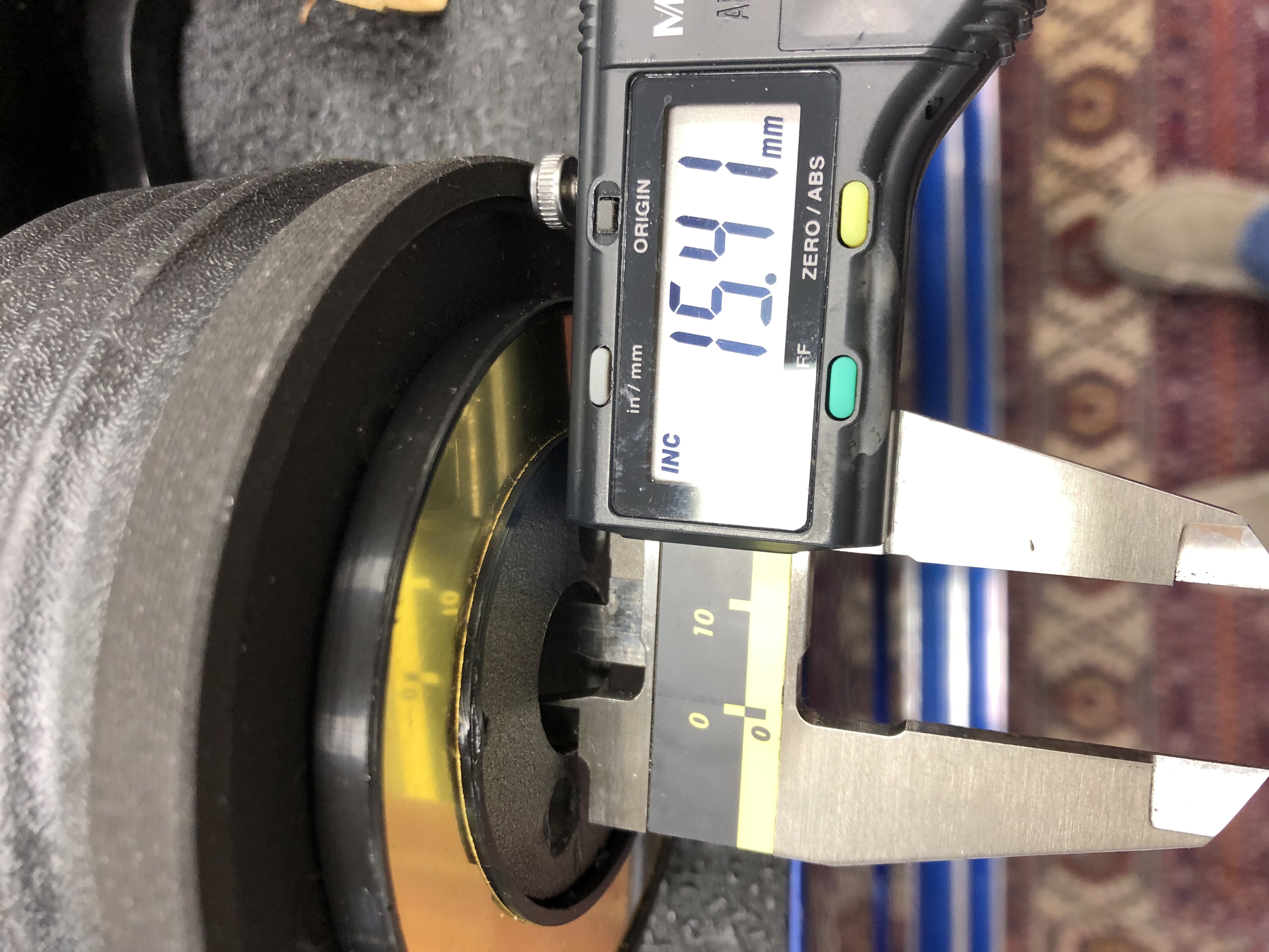

Having already received one Momo solid hub that wouldn't go on the steering shaft, on the recommendation of a gent who I buy tools and custom Porsche parts from I tried Amazon for what was purported to be a MOMO 8002 solid hub.
What showed up from "LTB Autosports" turned out NOT TO BE a solid hub as advertised.
Anyone can plainly see from the measurements this one wouldn't ever work regardless of configuation.
Before I raise the white flag I'm open to suggestions. Jimmy Tidwell made some of these at one time but as the market was covered he prefers to make things you cannot easily buy.
OTOH, Ive got a half dozen cool period wheels looking for a car. (IMG:style_emoticons/default/chowtime.gif)
Thanks
Tom
PS: Box is marked 89-97 Mazda Miata but also has a MOMO 8002 sticker "for Porsche" on it.

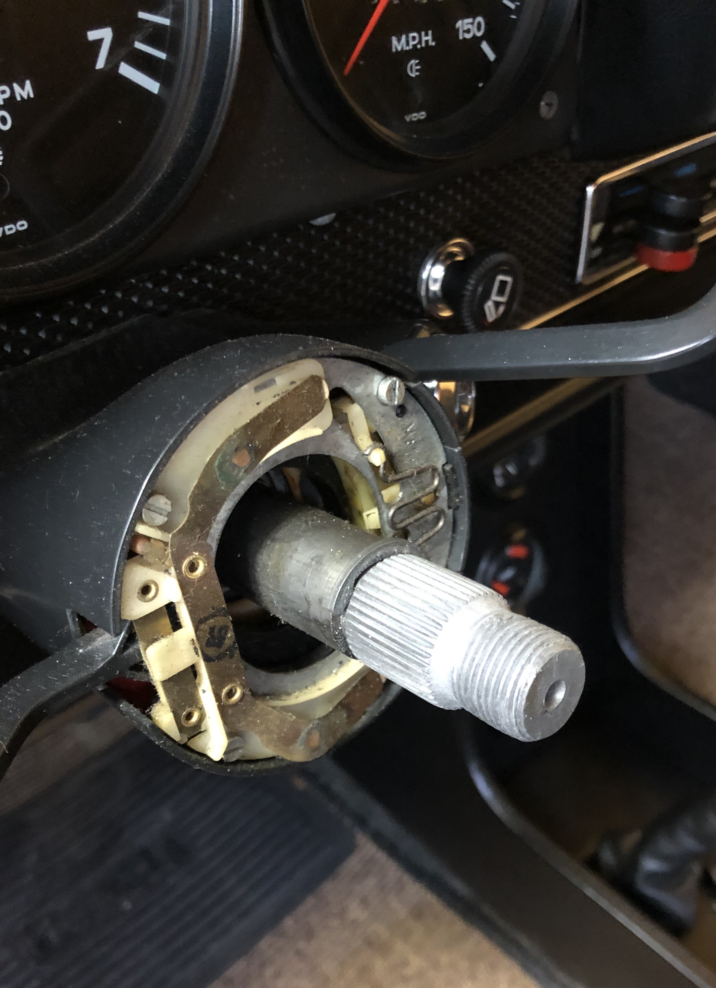

There are 2 different hubs for 914.
Post a pic of the back of your stock steering wheel splines.
If there's a taper before the splines it's a late unit, no taper is early.
I have a used momo solid hub for late if that's the one you end up needing.

Here you go:
Thanks!
Tom

First....what year is your 914?
Looking at this same problem myself right now. I have a 1971 914-4.
The solid adapter shown in post #4 looks like what you need.
Different adapters have completely different "architecture" on the side of the hub away from where the steering wheel mounts.
Some stick out and one is recessed (8002).
I'll bet you need the solid/recessed one (8002) that is shown in post #4, 3rd and 4th pics.
That's what I need for my car.
You will need to swap over the cancelling ring from the backside of your stock steering wheel to the back of the Momo adapter.
A horn button retainer is not on the adapter....it is just the center of the steering wheel itself.

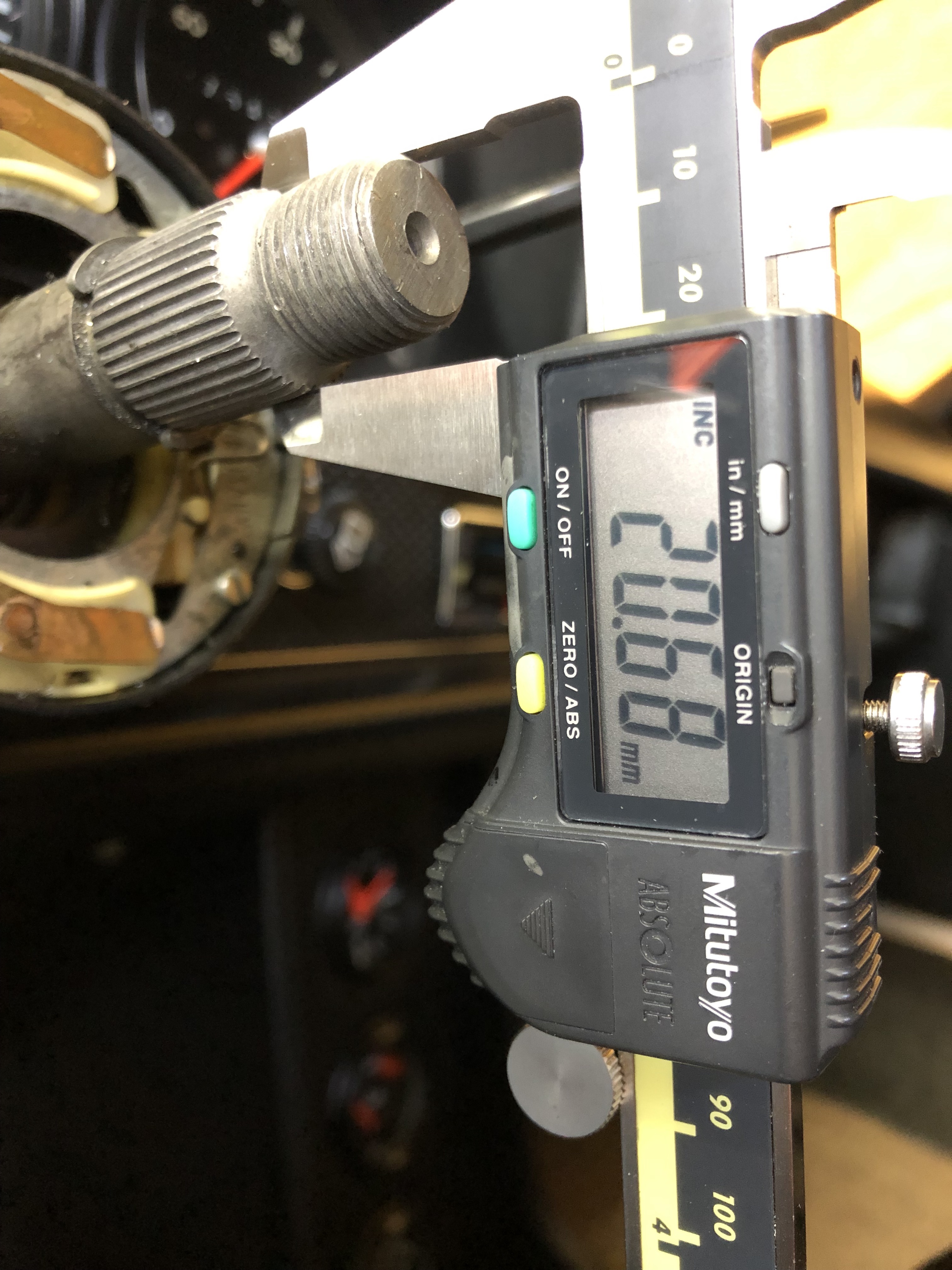

This looks identical to my shaft on my 71 914-4.
Except I don't see the black plastic square "thingy" with the copper horn contact ring that sits on top of it.
I'll have the 8002 hub in about a week with any luck and see if everything mounts up correctly and report back here.
