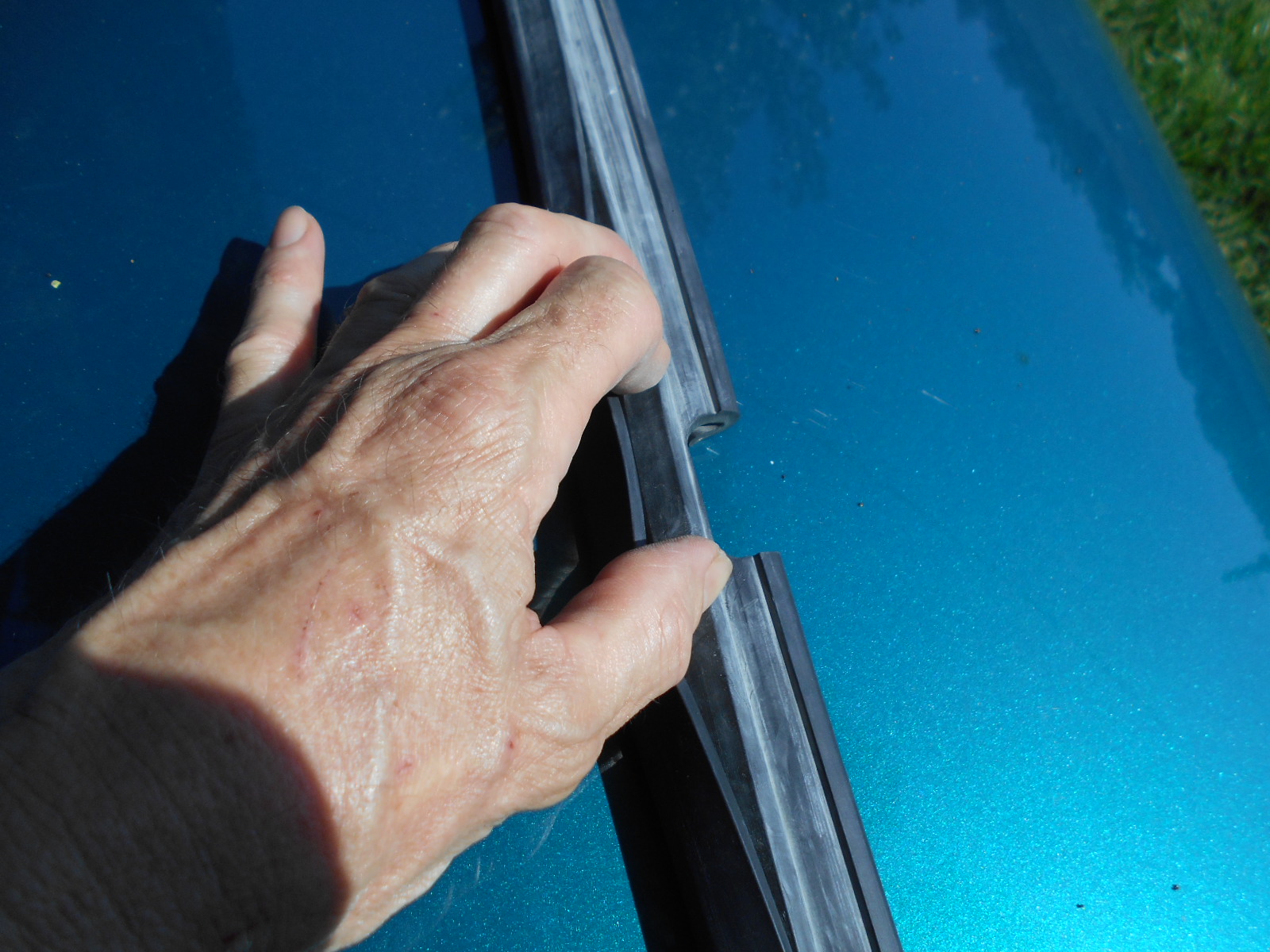

Seems hard getting the front lower targa top seal to fit in.
Any thoughts, ideas, or suggestions to help.

I've got it started, since I got that squarish part started in.
Since you've probably done lots of these, do I trim the ends square to fit in the corners?
With that center piece in the middle, there isn't much more than 1/8" in between, and looks like I am going to have to cut deeper into that notch to allow it to fit down in that narrow groove, or will it prove anything to remove that block, put the seal in, and then reinstall that center block?

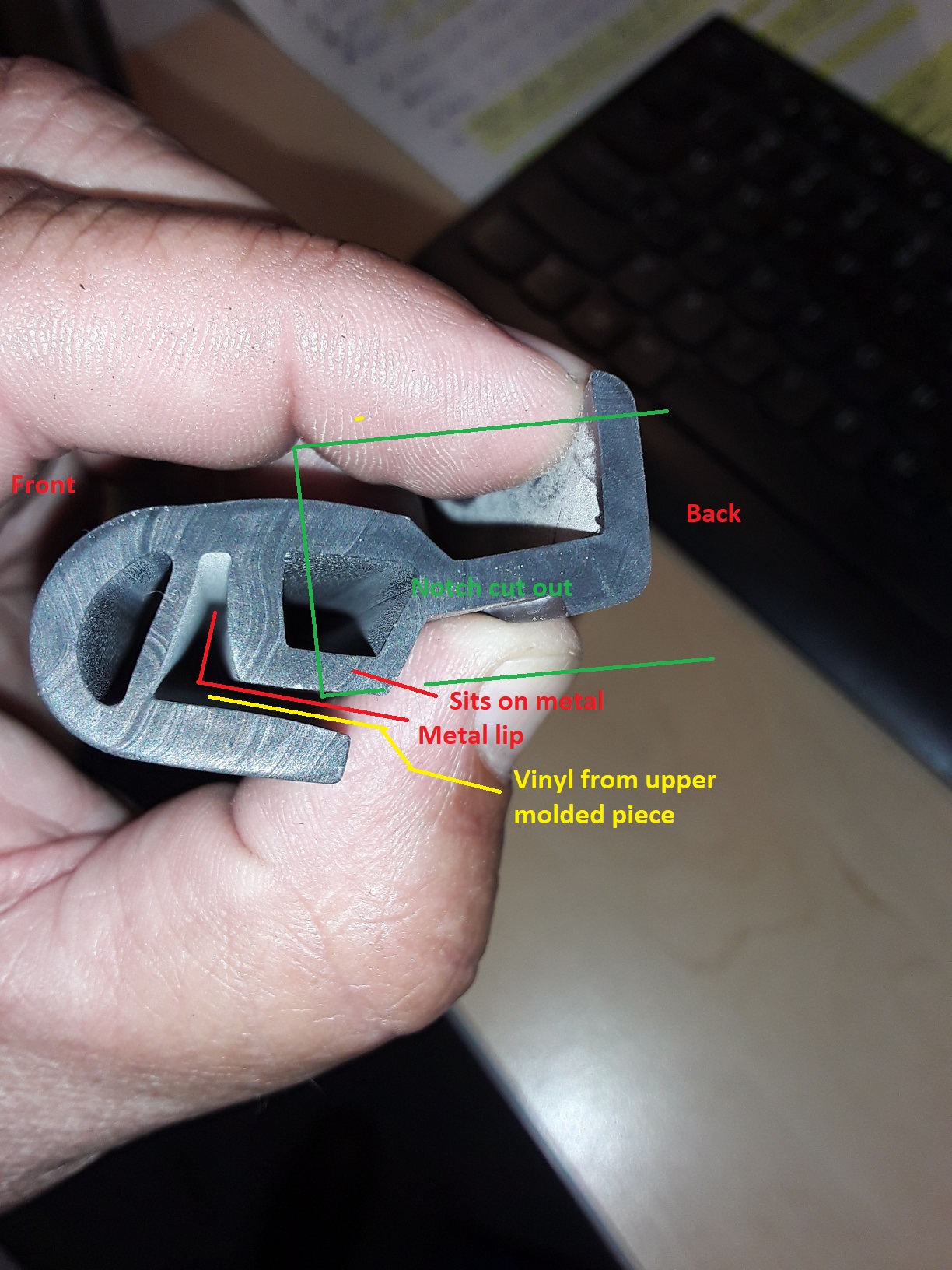

By the way the "head" has a flap at the bottom that goes over the textured vinyl upper that the visor clips go into.
It hides the edge by going over it.

@Mikey914 - can you run through this part again - I don't quite understand. I just received your targa seal kit and it's on the short list for install. Just trying to get it in my head before I make the attempt.
QUOTE(Mikey914 @ Aug 17 2019, 08:27 PM) *

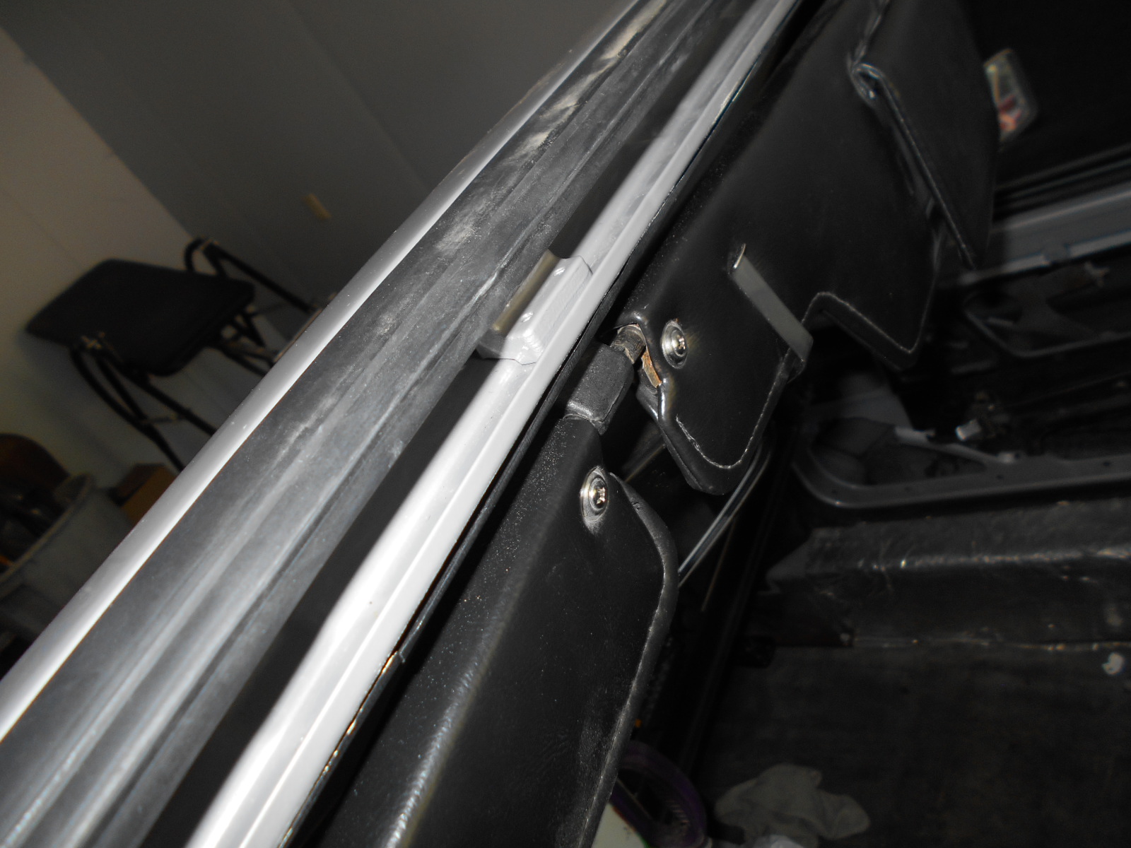

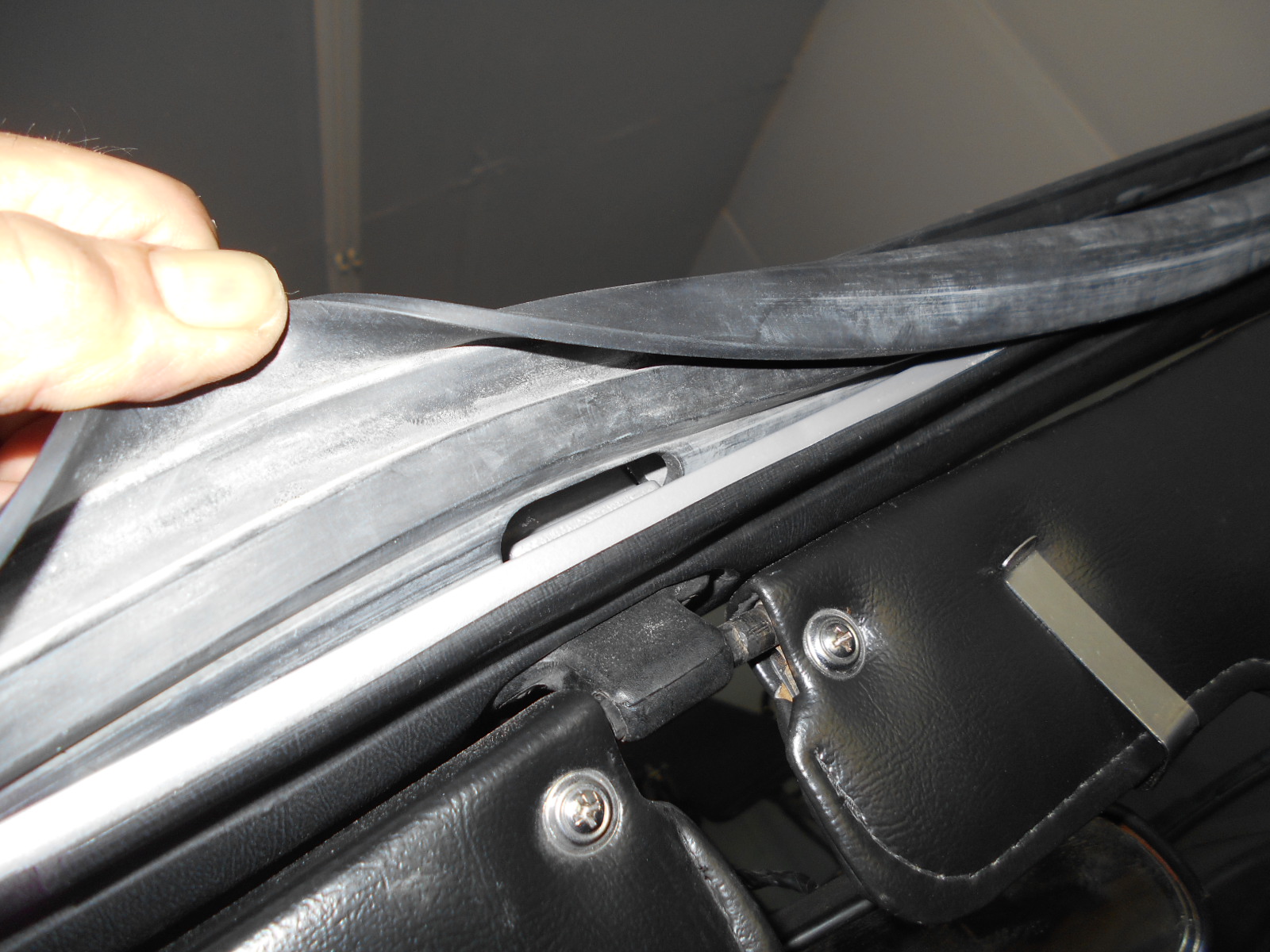

I think he is talking about that bottom lip you just pull over that texture skin on the moulding so that it hides it.
Most likely you will have to carve deeper into that notch so that that square part will go by that center piece in order to fit down. At least that is what I had to do.

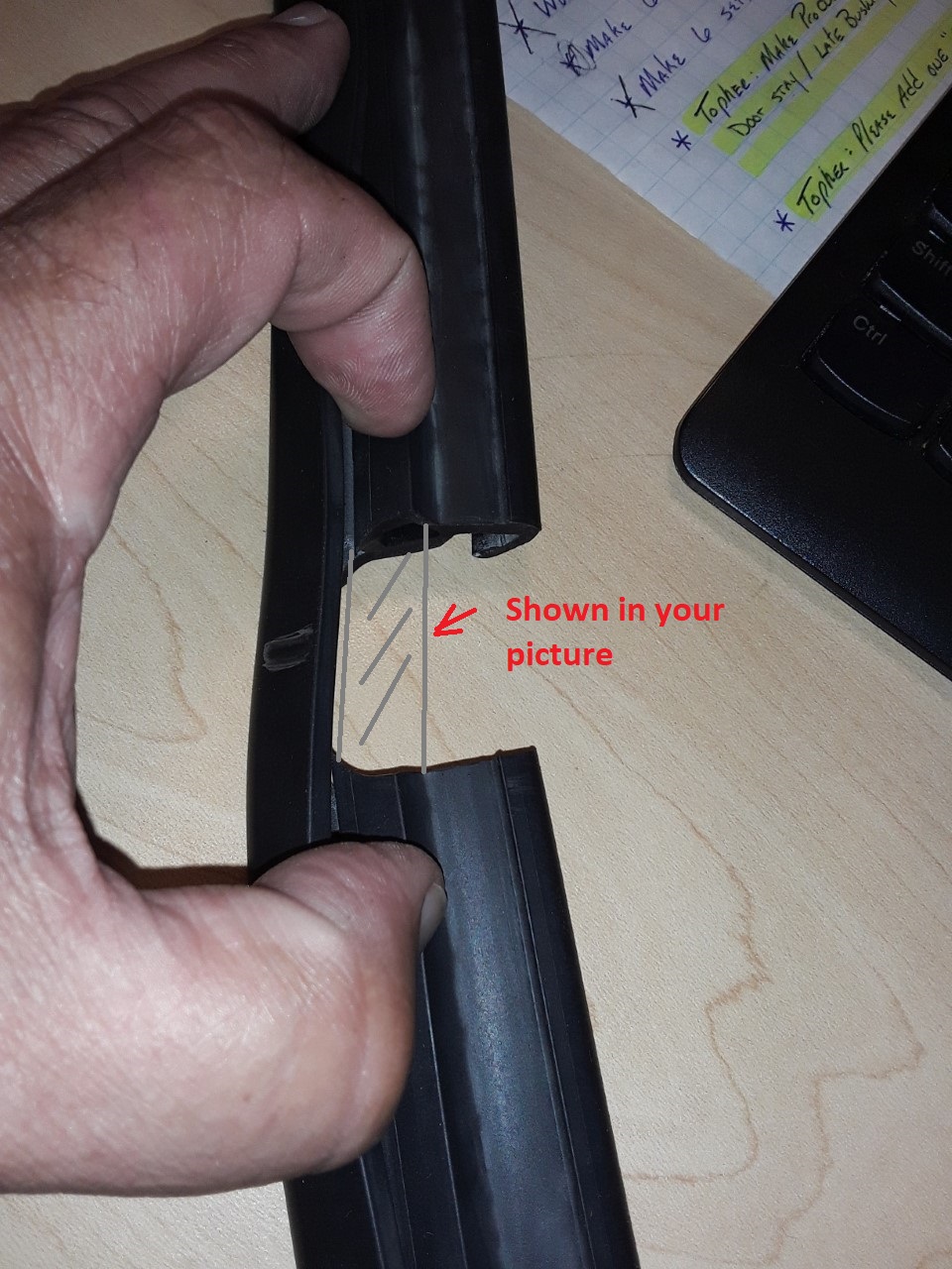

I'm emabrassed, but I can clearly see the notch is cut backwards PM me your name and I will have to have another set to you. (IMG:style_emoticons/default/headbang.gif)
Mikey914
post Aug 19 2019, 03:43 PM
The rubber man
Posts: 12,785
Joined: 27-December 04
From: Hillsboro, OR
Member No.: 3,348
Well duplicated the picture looks like it is cut correctly, just not as deep as we normally cut them.
It should look like this

This will make it clear as mud
