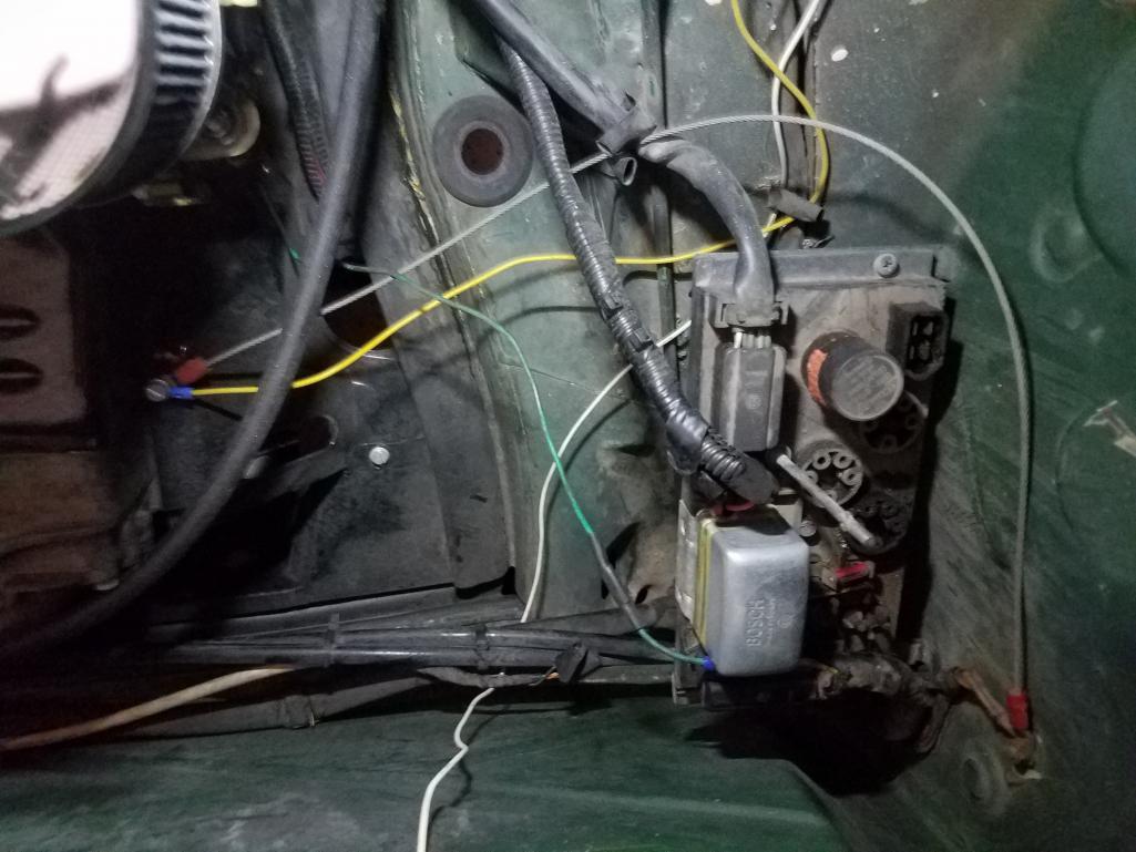

When I was checking the car, I was really happy with the lack of rust and good condition mechanically. the one area I neglected to check as well as I should have was the wiring. Some PO(S) did some seriously substandard wiring work.
Nothing that can't be fixed but it is still annoying.
The silver cable with the red ends in this picture is just a stainless steel cable. It is being used as the ground strap.
The white and yellow wires are a home built wire setup for the license plate lights.
The green wire goes to the starter.

needs a transmission to trunk floor ground strap (factory), and ground will be good,,, 1 down

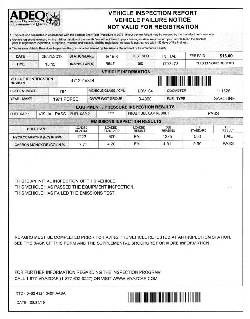

Emissions result from Saturday

Running rich... CO is rich/lean indicator and high HC indicates misfire / unburned fuel.

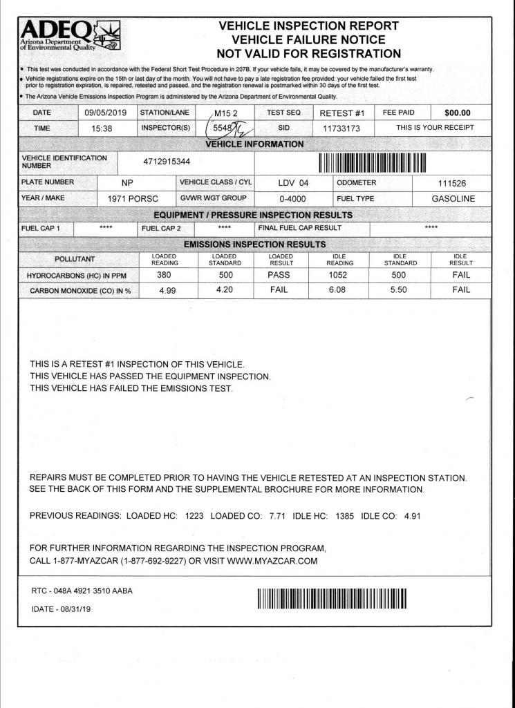

Improved in some areas, got worse in others.
I am still getting back fires especially during deceleration.

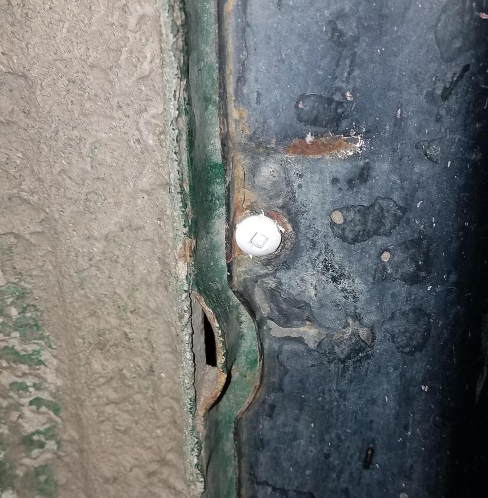

I would like to petition the Arizona Department of Game and Fish to start a bounty program on previous owners who do stupid $h!+.
Square head screw???

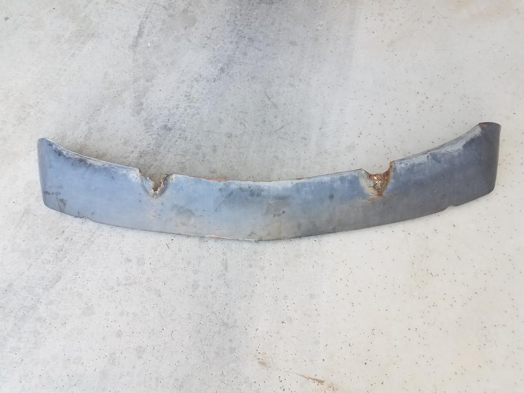

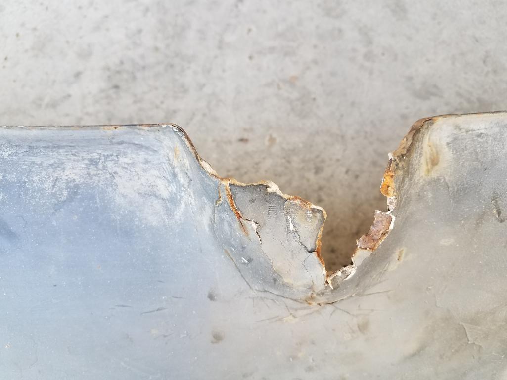

I don't know if it was the same PO but someone tried to patch the front valance.
They used body filler to put in a second layer of sheet metal behind the rusty damaged section of the valance.
I am debating what to do with this valance. Is it worth the effort to cut out the bad parts and weld in a properly formed replacement section?
Should I fix it or replace it with something more aggressive.
AZBanks
post Sep 6 2019, 11:28 AM
Post #39
Posts: 1,086
Joined: 7-December 05
From: New River, AZ
Member No.: 5,245
Worst side of the valance.
AZBanks
Post #40
Posts: 1,086
From: New River, AZ
Member No.: 5,245

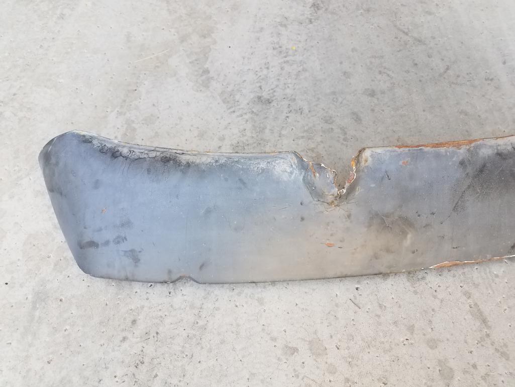

Close up after I removed most of the body filler and badly rusted metal.
