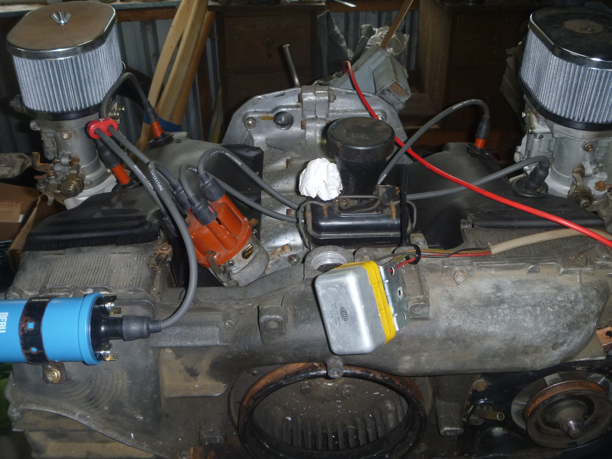

As above,stripped and serviced one of a pair today specs are ;
30mm vents, 52 idles, mains are 122, carbs dated 1984 in great condition, Air correctors and pump jet are as they should be. Think it will be ok for startup after rebuild but also thinking those mains are a little small ? Motor is 1.8 high compression ,stock carb cam and Euro 2.0 bus heads flycut with larger valves. TIA. |

MarkV Mains don't seem super small mine came with 12... Aug 28 2019, 12:14 AM
porschetub Yes thanks ,think now the mains may be ok-ish cons... Aug 28 2019, 11:44 PM
MarkV Mine came with 28mm vents and the 34's I put o... Aug 29 2019, 12:02 PM![]() ![]() |
