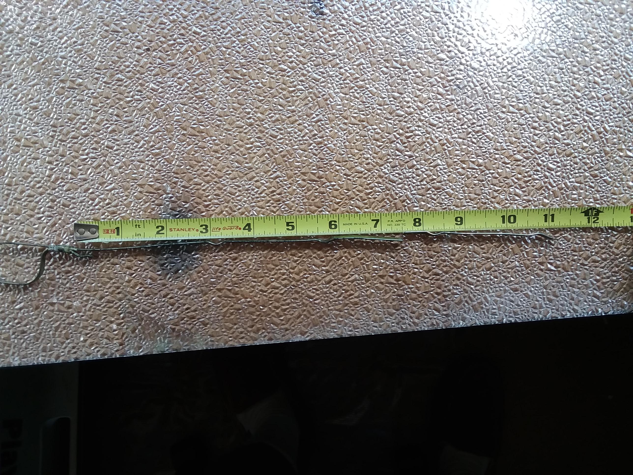

on the -6 over the weekend. (Yes, car was well warmed and idling). FWIW, I find this measuring method a PITA and greatly appreciated the oil level gauge in my 911.
The stick felt funny upon reinsertion so removed it again and lo and behold, a crack ready to break was right at the upper-level dimple. Perhaps wrong, but I'm attributing this latest problem to age and metal fatigue multiple heat cycles. java script:emoticon('<_<','smid_2')
I did a little digging and there are several related threads on topic, but I couldn't find anything that stated you could substitute a similar vintage 911 dipstick, which I imagine should be easier to come by than a genuine -6 part, as long as there's no difference.
Attached picture shows my existing stick with an overall length of approximately 11 1/4 inches as measured from the inside of the stop clip, with the break at 7 1/2 inches, right at the dimple. I believe the "low" mark is right at the bottom of the stick
Knowledgeable feedback greatly appreciated. TIA

Here's a picture of a new one I have from Porsche. They're still available.
(IMG:http://www.914world.com/bbs2/uploads_offsite/i.postimg.cc-6621-1567455290.1.jpg)
ClayPerrine
post Sep 2 2019, 02:26 PM
Posts: 16,545
Joined: 11-September 03
From: Hurst, TX.
Member No.: 1,143
The dipstick for a 70 914-6 is part # 901 107 770 40 (the one in your picture)
The dipsitck for a 70 911 is part # 901 107 770 00
If I remember correctly, they are marked differently.
Your best bet is to find someone with a 911 dipstick and compare it with the 914-6.
Good Luck.

Thanks! I noticed the same 901 part number in other related threads, which made me wonder if it's truly teener-specific.

When I got my /6 a LONG time ago, the dipstick had been brazed at the same location that yours is braking. It is pretty easy to insert it incorrectly into the oil tank which probably had something to do with the repair job.

Thanks much defianty, lalee, and Clay for the responses. Apparently still avail from multiple part sources. OEM looks the way to go, if a bit pricey for a short piece of (presumably) spring steel (IMG:style_emoticons/default/sad.gif)
