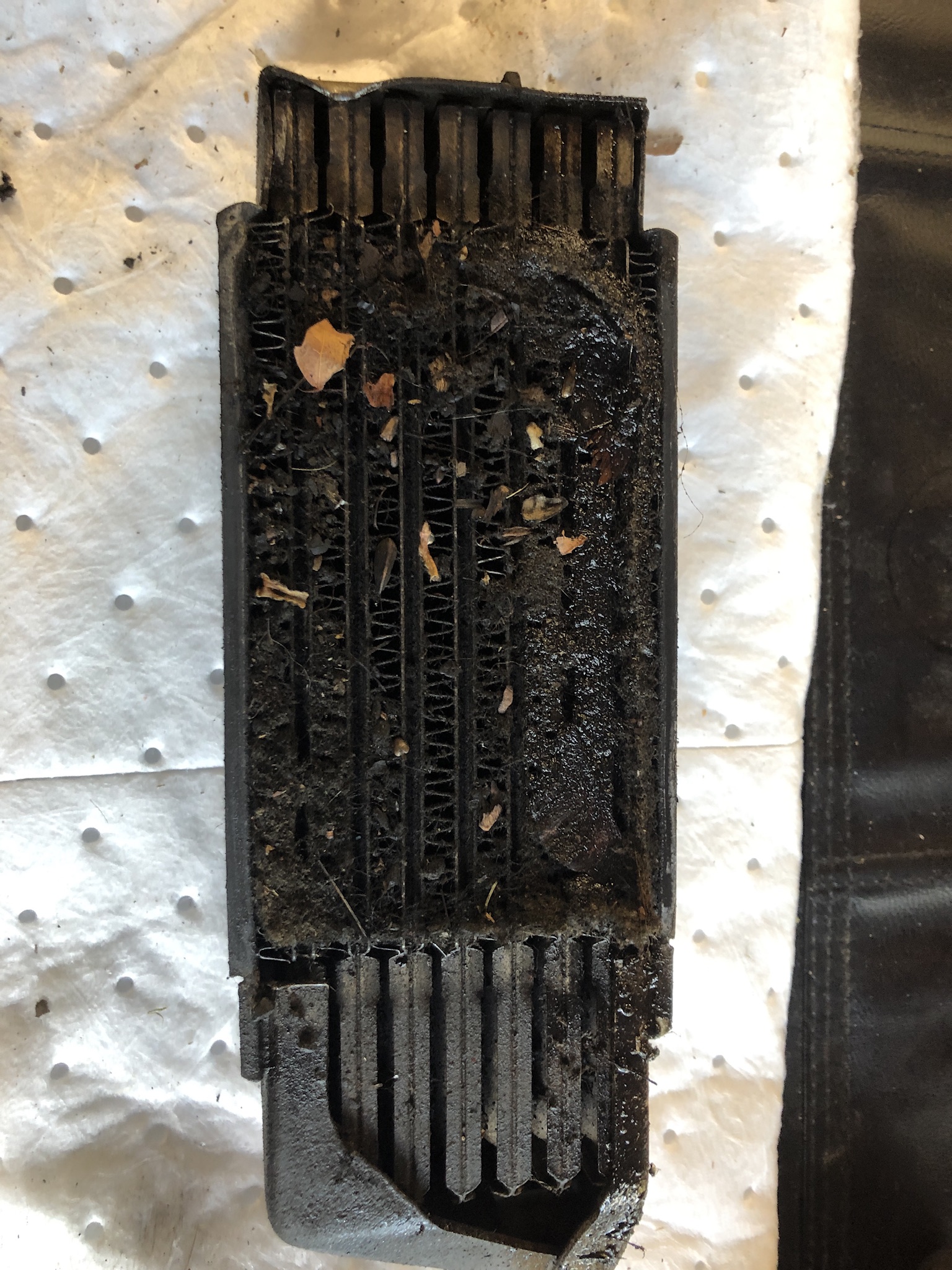

So a quick addendum....when I bought this beauty 3 years ago....the guy said, “she overheats once in a awhile...lol....every time I ran it for more than 2 miles it pegged the temp gauge...needless to say she leaked oil....anyway....here’s the oil cooler! Lol. No oil was getting cooled here! So, that will be my first replacement along with some much needed gasket covers and we’ll go from there...Attached Image

Rock and roll man! My cooler looked like that one too.
I just pulled my motor and replaced all the seals along with a bunch of other stuff while I was in there. Cooler is actually allowed to cool now!
Have fun and keep posting pics!
