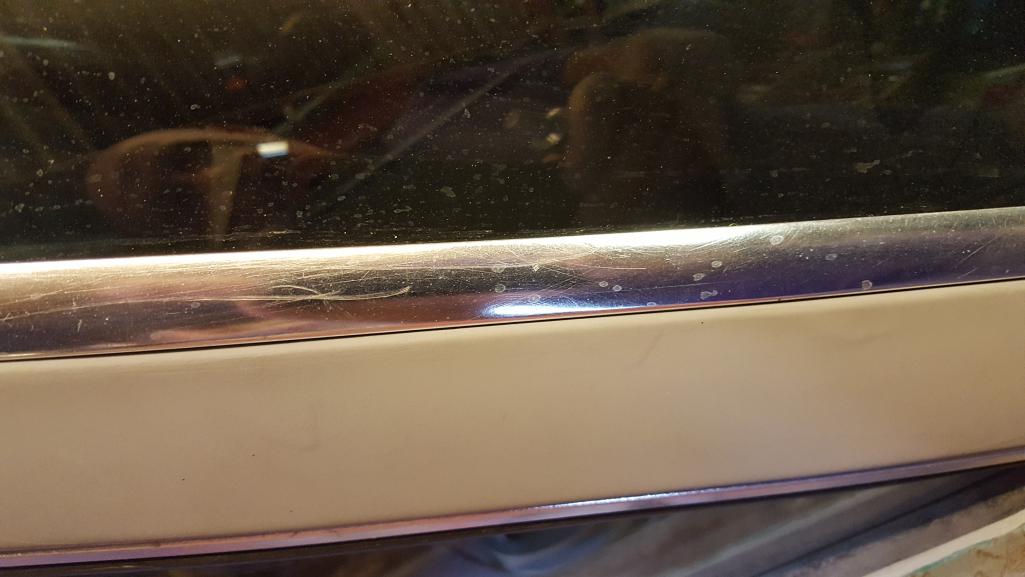

Hi
Could someone advise if the front screen trim is polished stainless steel or chromed please
Mine is scratched and just wondering if is polishable
Thanks

QUOTE(dt4 @ Sep 3 2019, 01:57 PM) *
It's an anodized finish. You can polish it. If you do so, you will remove the anodizing and it will tarnish, requiring that you polish it again and again. It does look a lot more shiny when polished, though.
The only way to return to the original finish is usually to replace the trim with new. I believe it's still available from your local Porsche dealer.
Chris

Clear anodized aluminum
You have to strip the ano before you can polish it

Basically you can wet sand and polish it. If you use a 2 stage wax with a polish sealer it will last outside for quite some time. The trick is not to deform it while polishing. A 1000 or1500 grit would be a good start finishing with a 2000.
If you need new I can help out, but looks salvageable.
That's really useful, thank you.
I'll give it a go.
I am building a list of the parts I need to order from you so if it goes Pete Tong I can add these to the list
