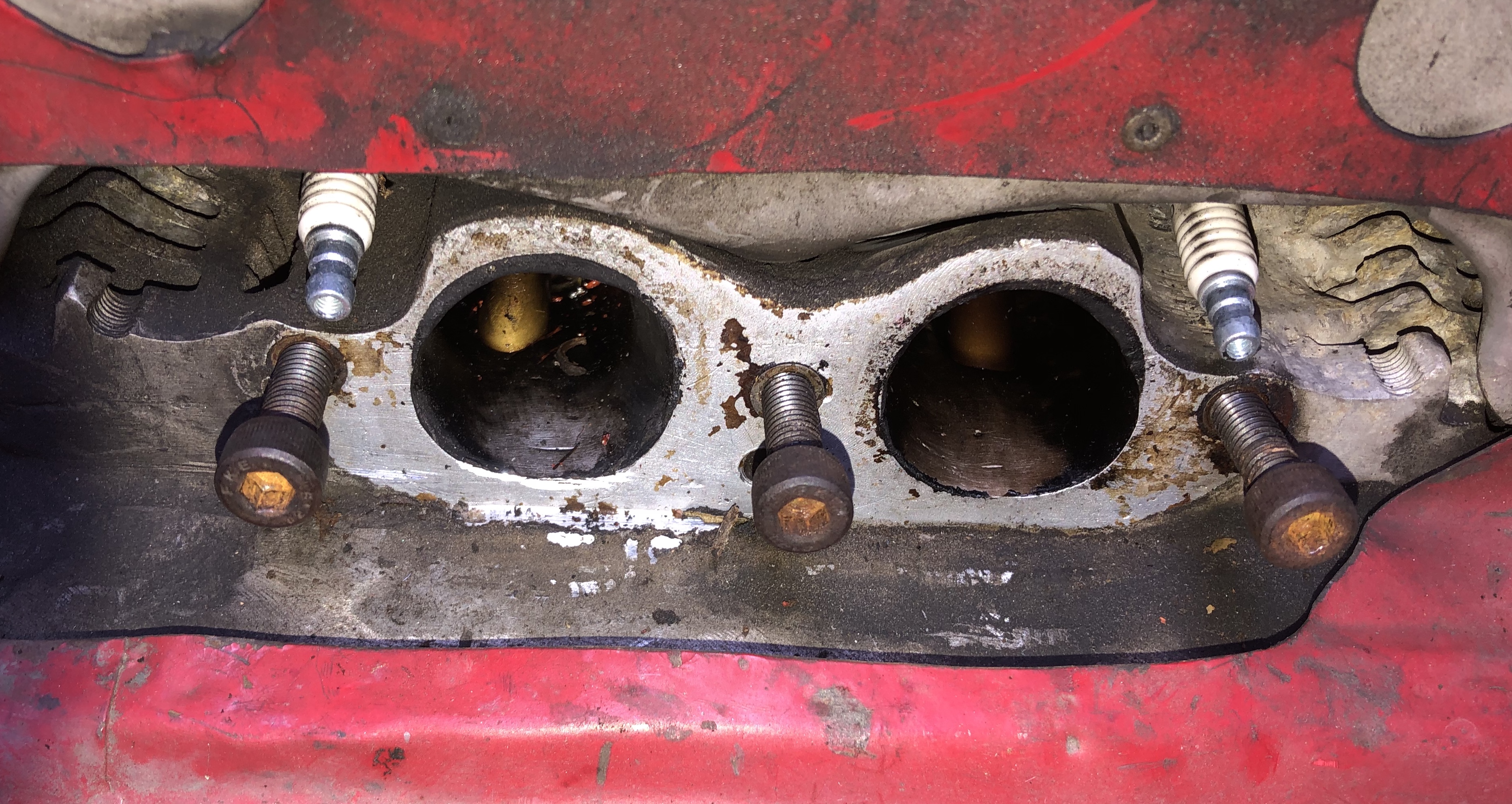

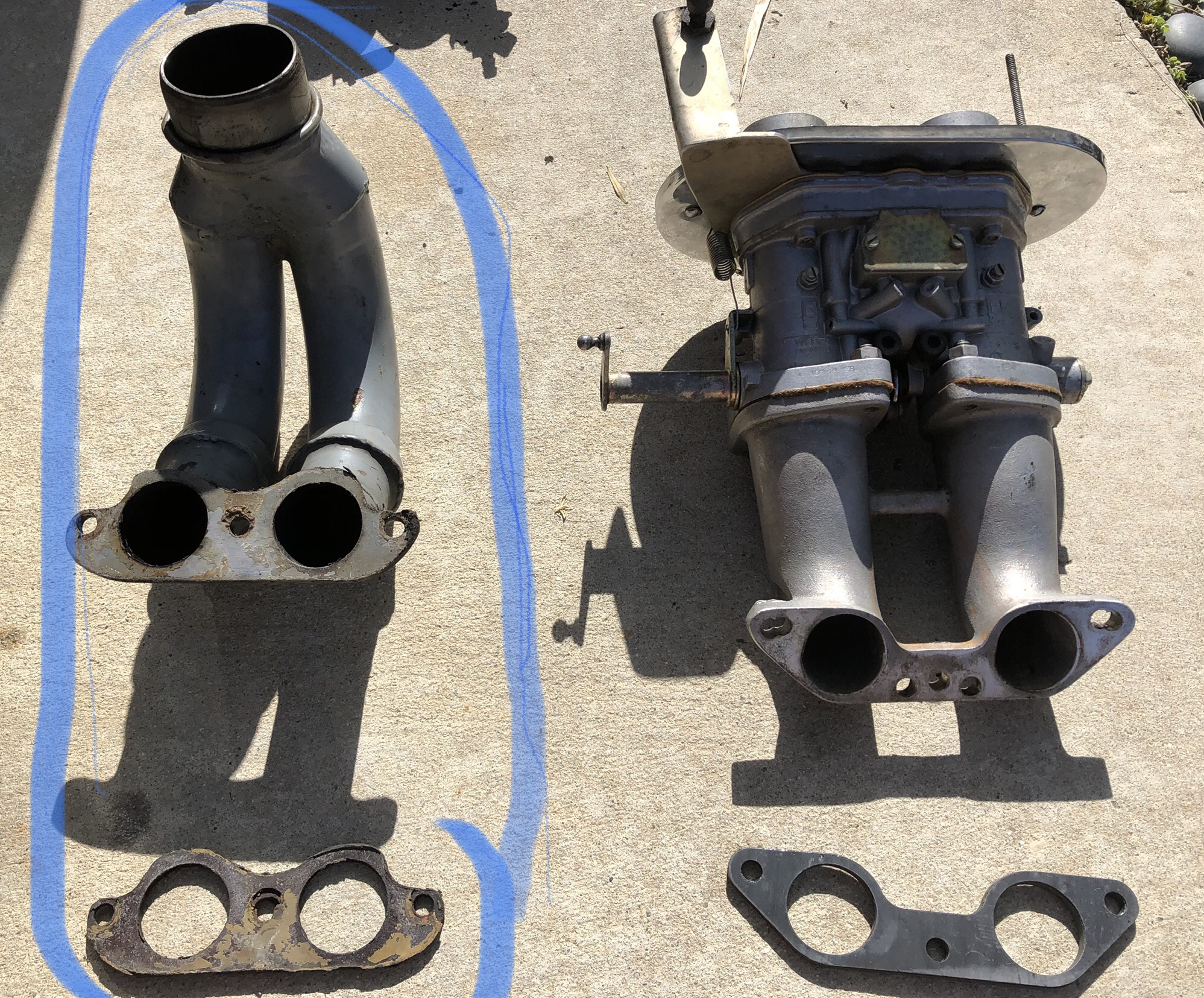

So I pulled the turbo intake and single Weber off the red car yesterday, that was discussed here Removing turbo set up

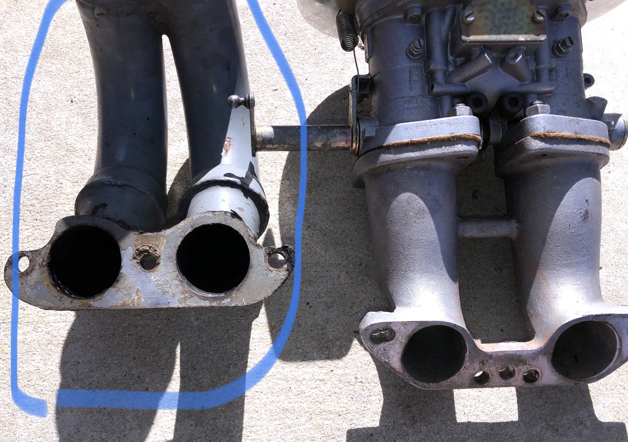

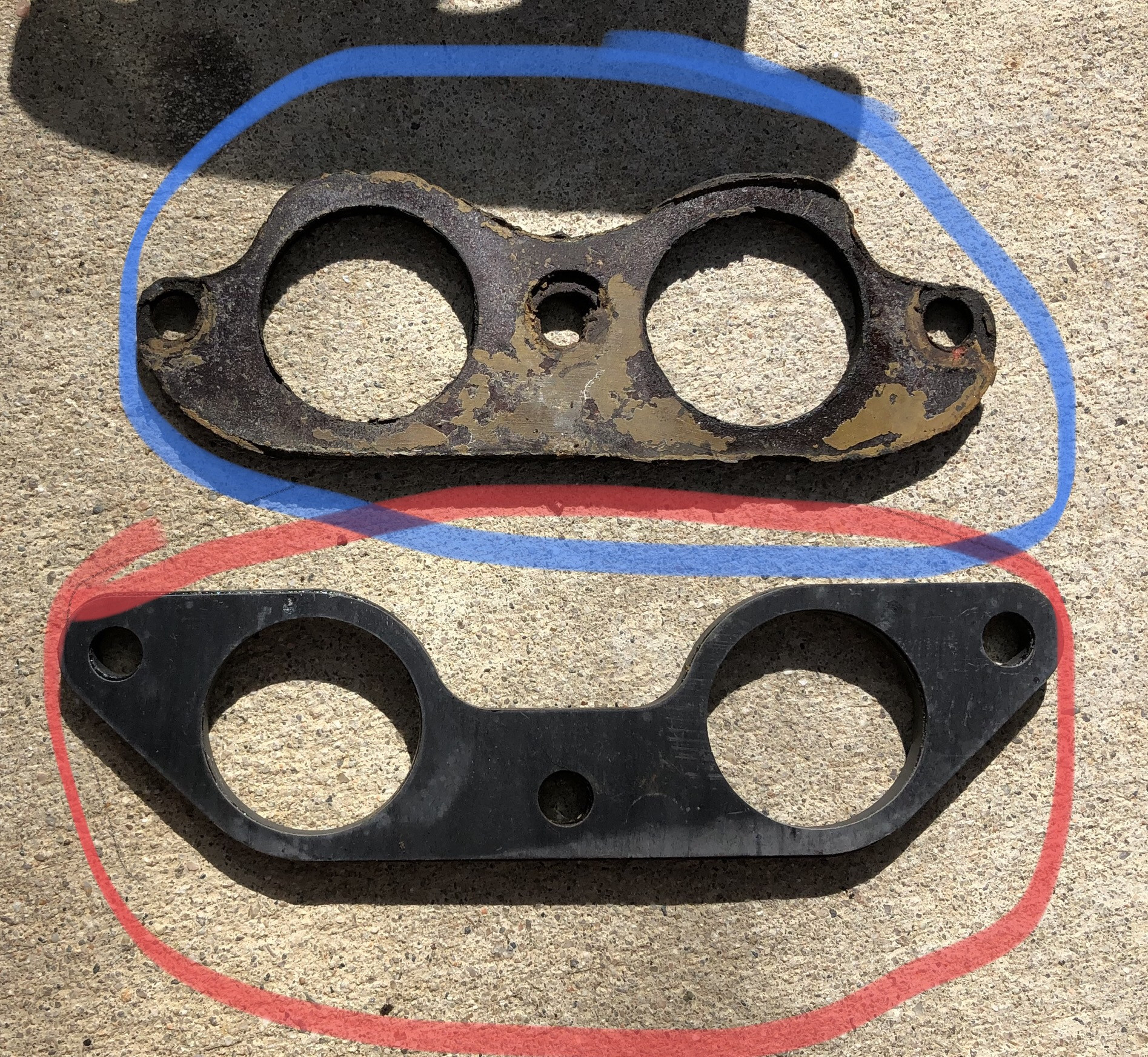

I went to put the dual Weber’s back on and there is no way it will bolt up. The bolt holes and spacing don’t line up. Looks like the heads on there have a significantly larger intake port and bolt spacing is different.
Blue is what I took off.
Red is standard 2.0 intake.
Tdskip

I think the old phenolic spacers may be homemade or induction system specific. No telling what was done to the heads to make the manifolds fit. Try a set of CB tall manifolds and see if they fit.

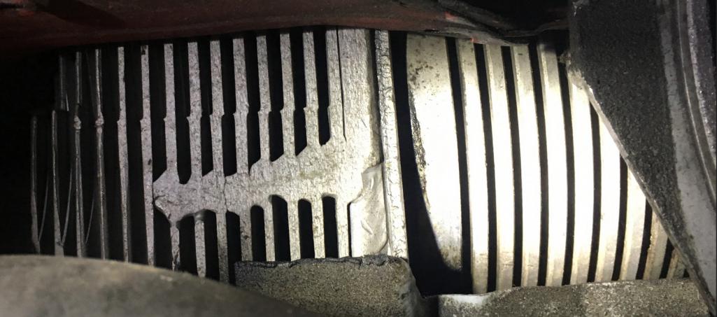

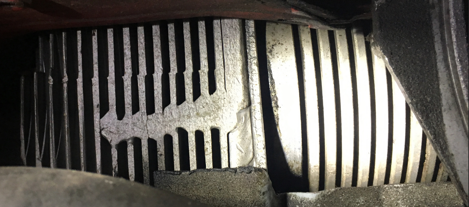

QUOTE(Tbrown4x4 @ Sep 8 2019, 12:49 PM) *
Can you take
A picture of the head? Intake ports, I mean.
Also, your engine tins might have been modified .
Here you go - some funkiness on either side of these ports I hadn’t noticed before (first time taking the fuel system off).

CBs aren't going to work. The fin distortion on the right side behind the 1/2 of a threaded hole is odd. Is that melted aluminum?

Looks like the original spark plug holes in the tin are covered with a piece of metal which is riveted in. There are rivets just above each spark plug as the spark plugs exit the tin right with the intake.

Looking at the image of the heads, it looks like at one time there were 5 studs, or at least the 2 studs on the ends were used at a different time, and is no longer the case?
