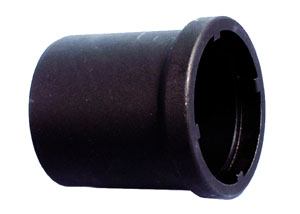

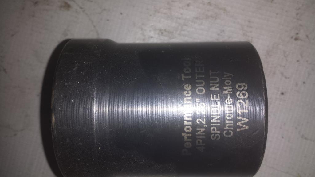

My ball joints are very stubborn. I tried a pipe wrench and they don't budge. Is there a specific tool that goes in the slots on the bottom ring to make removal easier? I haven't given up on the idea of driving to Okteenerfest yet.

Yes there is a special socket for those nuts.
It fits into the four slots, some versions have a ring that seats outside the nut to keep the socket on the nut as you loosen or tighten.
I think there was a member or vendor that was making and selling the socket.

jim_hoyland
post Sep 8 2019, 06:01 PM
Get that VIN ?
Posts: 9,828
Joined: 1-May 03
From: Sunset Beach, CA
Member No.: 643
Like this ?
