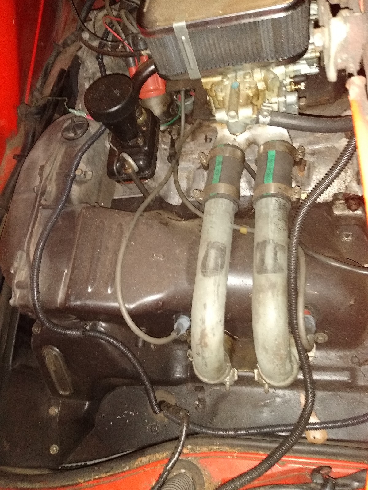

Awesome thank you for taking the time to help me, I'm still getting use to using this site and learning to navigate it. I'm having a hard time posting pictures , I'm not very good with computers or smartphones lol.

engine looks clean. maybe later try to upgrade from single to dual carb.
Did u acquire the car running? the reason I ask, if it was not driven for awhile, maybe just use castrol synthetic 20/50 for now and change the oil again after 1k miles or less before using better/expensive oil like bradpenn or other suggested by other member above.

Yes I acquired the car running, but had not left the PO's garage for the past 3yrs due to the transmission stuck in 3rd gear. That was a easy fix so I wanted to change the fluids before we put some miles on it. I plan to put dual carbs on if during the winter if I can't find the stuff required to put it back to fuel injection.

oh yes about the 3rd gear issue. Maybe you can just use cheaper oil for now and drive it a few hundred miles then change oil again.
I suggest also next is upgrade to dual carb and enjoy the car and for sure there are so much other need more attention fixing the car and while collecting the F.I. parts for future swap. Sometimes it is hard to find a complete old FI parts that will instantly run without any issue after installation. Enjoy driving it while fixing or upgrading some items in the car. Unless you want a long project on jack stand for several years before enjoying it. Well that’s me and just my suggestion.
