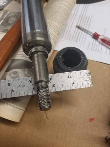

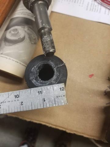

So I ordered the Bilstein inserts for the front. 34-001134. Haynes shows bump stops. I ordered bump stops, but they don't fit. Called Bilstein and they gave me a part number E4-AP2-Z118A01. Unfortunately this is not a good part number even on their website. It was a bad cell connection so I could have gotten part of the number wrong.
The question is are these the wrong part or am I just to wimpy to jam them on? If you have a part number for what I need please let me know.

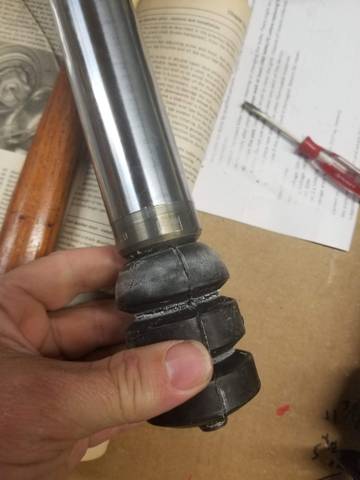

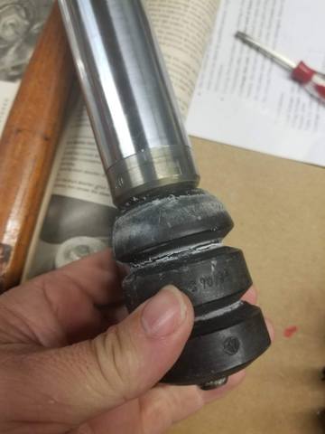

Bilstein, unlike Boge, does not use bump stops under the cylindrical dust cover. They are built into the shock.
@trojanhorsepower
If you have a Bilstein strut with a Bilstein insert on a 86 and up Carrera, you use the bump stop on the botton of the cartridge like the pic.
