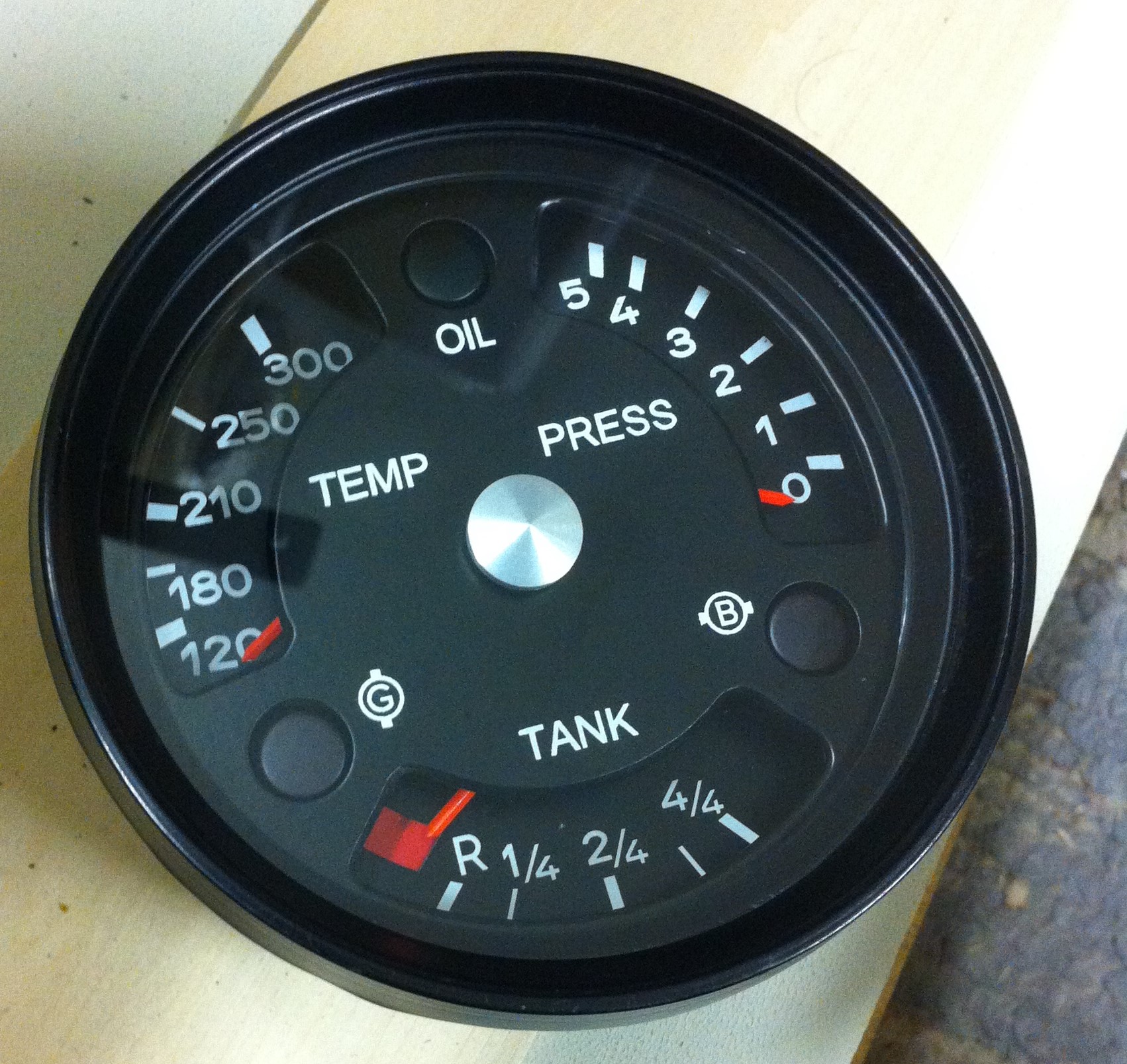

euro911
post Sep 18 2019, 10:36 PM
Posts: 8,944
Joined: 2-December 06
From: So.Cal. & No.AZ (USA)
Member No.: 7,300
Nice job, Stephen !!!
(IMG:http://www.914world.com/bbs2/uploads_offsite/i176.photobucket.com-6621-1497895122.11.jpg)

QUOTE(euro911 @ Sep 18 2019, 11:36 PM) *
You're not kiddin' !! Love it. I have to ask, was that panel powder-coated or rattle canned?
