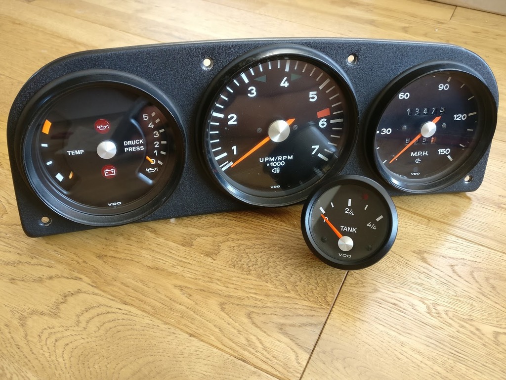

euro911
Nice job, Stephen !!!
IPB Image

QUOTE(euro911 @ Sep 18 2019, 11:36 PM) *
IPB Image
You're not kiddin' !! Love it. I have to ask, was that panel powder-coated or rattle canned?
