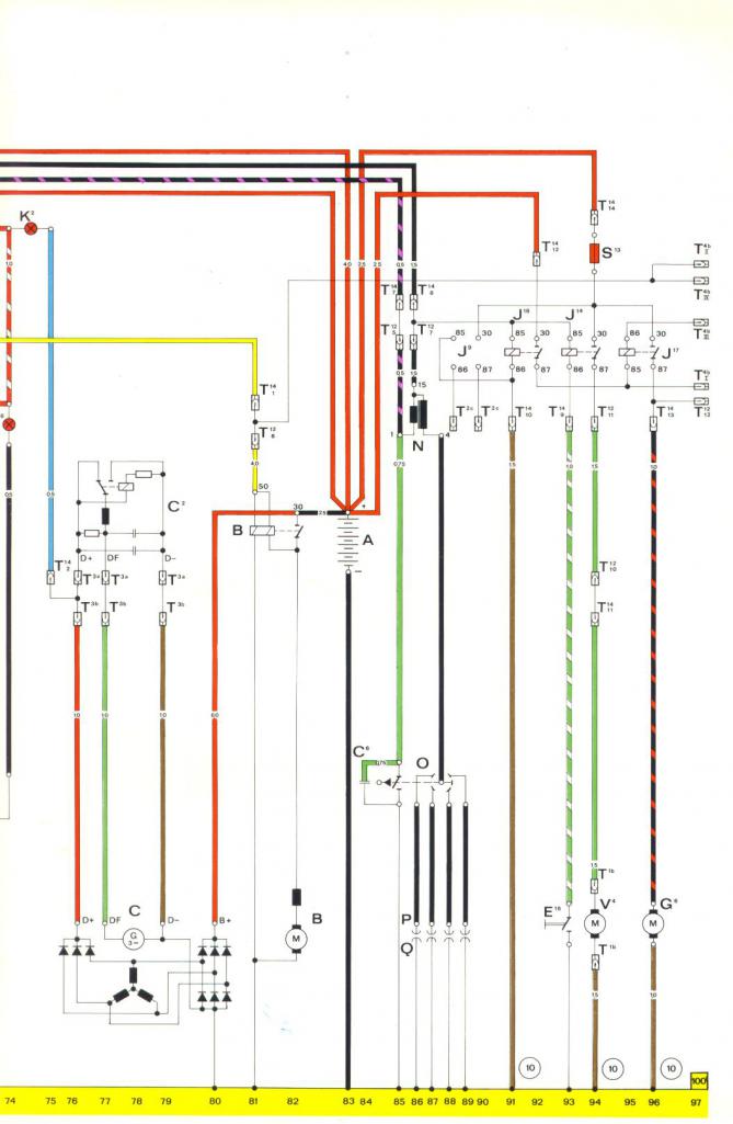

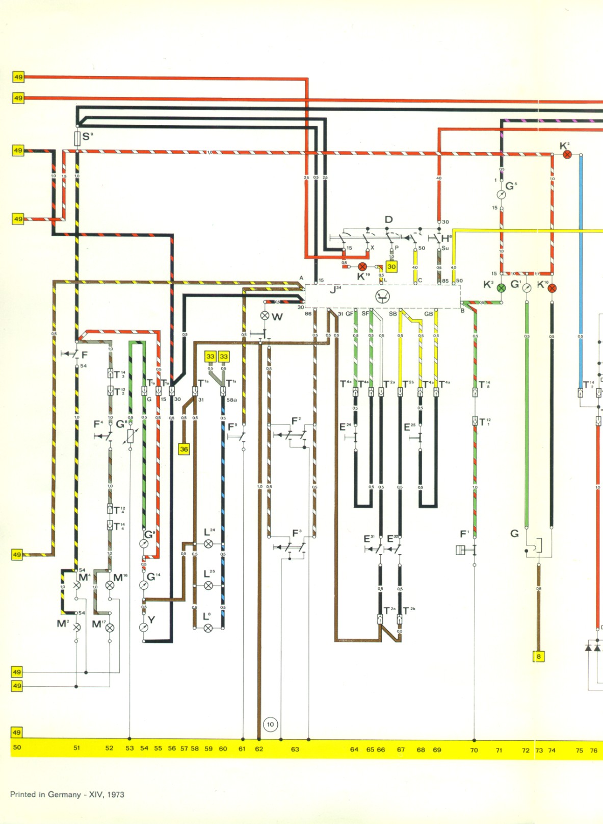

Here is your wiring diagrams.
B is the starter.
T connector is yellow wires on the engine compartment reply plate.
D is the ignition switch.
This is for the '74. Note some cars have a seatbelt interlock switch in that yellow circuit.
If someone has added a starter relay then it'll likely be in teh yellow wire in between the relay plate and the starter solenoid.
You can test your starter by getting underneath, driving wheels off the ground and out of gear, and using a screwdriver to short the battery terminal to the terminal that the yellow wire goes to.
Be safe. Don't kill yourself.

QUOTE(GregAmy @ Sep 25 2019, 12:30 PM) *
B is the starter.
thank you for diagrams . I actually thought it was my starter but then I got a new and put in yesterday and it doing the same thing. Mine is a 72’ 1.7L doesn’t have the seatbelt relays under the passenger seat so I don’t think it has them.

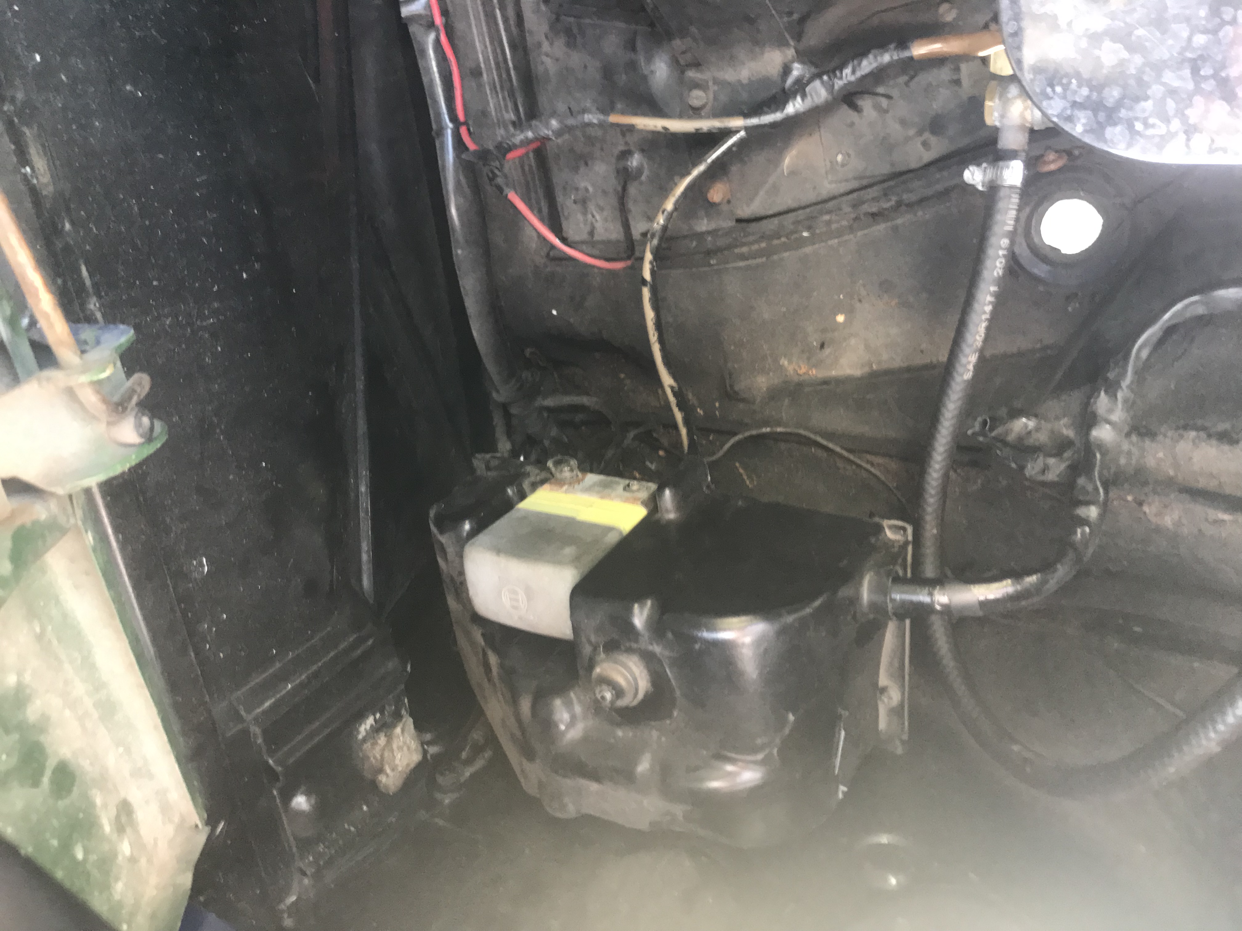

Willisbegood
post Sep 25 2019, 11:41 AM
Posts: 26
Joined: 25-September 19
From: San Antonio Texas
Member No.: 23,495
QUOTE(Willisbegood @ Sep 25 2019, 12:37 PM) *
B is the starter.
would the relay in this picture with the yellow tape on it cause it to not start? It’s the only one in there that I looked at that seemed rusted and corroded
GregAmy
post Sep 25 2019, 11:43 AM
Posts: 2,632
Joined: 22-February 13
From: Middletown CT
Member No.: 15,565
The silver "relay" with the yellow tape is your voltage regulator. So, no.
Test light or VOM, see if you're getting voltage to the yellow wire at the starter when someone turns the key to the "start" position.
