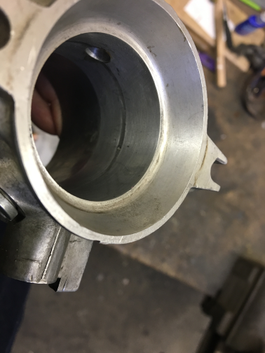

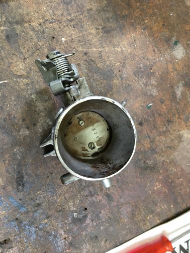

Thanks for the replies and shared info... I already took the TB apart and cleaned is. The bearings and seals seem not bad. See below pic what I believe causes the sticking, a ridge has formed over the years. The butterfly sticks on this ridge (IMHO).
So some kind of honing of the bore and a new butterfly...?

That depends on the amount of wear. The shaft is a steel on aluminum surface without lubrication. For this reason, the shaft bore in the TB wears in an oval condition. This causes the plate to lock in place. After awhile the bore for the plate wears a groove and makes the condition worse. In this case, the large opening needs to be machined and a net plate made to match.
I bore the shaft hole and insert a bushing. It is tricky because it needs to be precision and aligned correctly. Not a DIY project.
