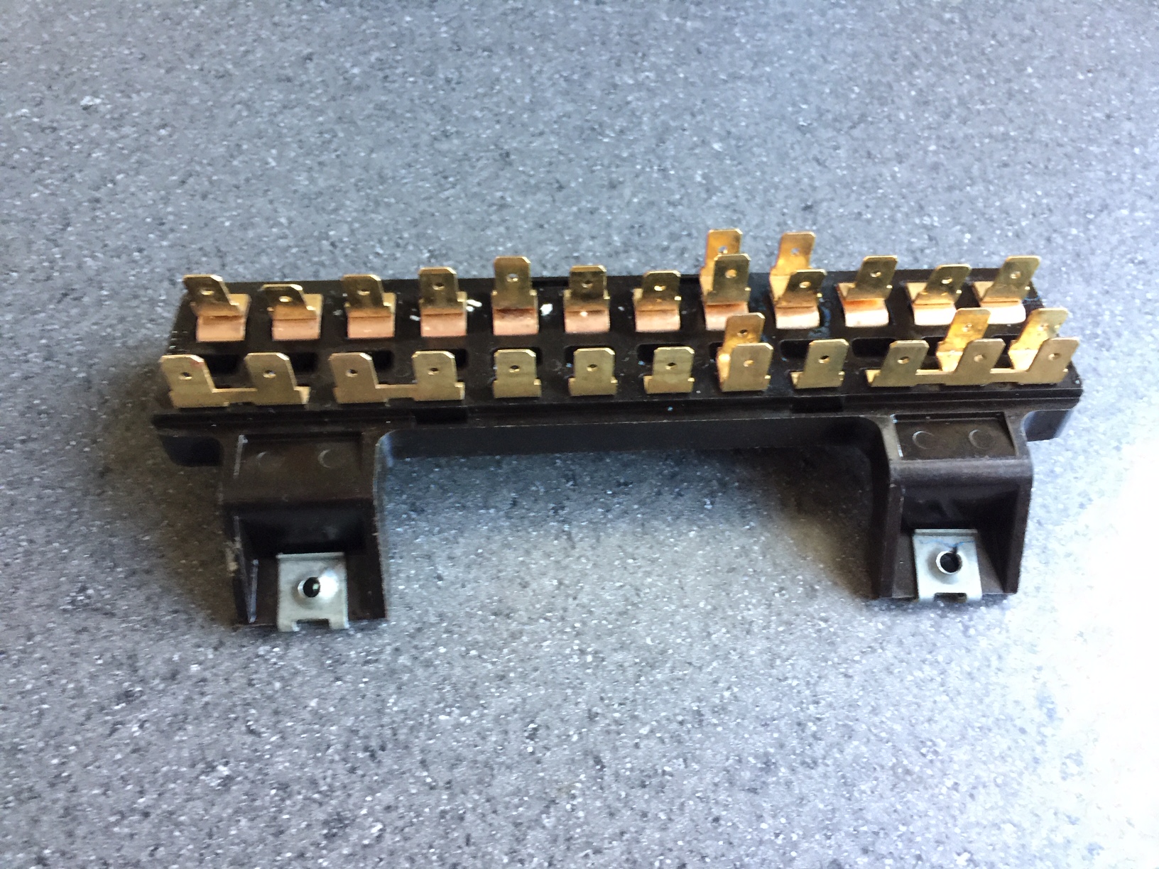

My driver's side headlight is not coming on. I checked voltage, and nothing is coming thru, low or high beam. The passenger side works great. Fog lights also work, turning off automatically when high beams are on.
I checked the headlight relay, and it is hooked up correctly. So my question is, does anyone know which terminals on the relay I should check for voltage in order to isolate the problem? Since the passenger headlight works, I'm thinking is a wiring problem leading to the driver's headlight. |

9**P-car Spinning the fuse was all it took. Brilliant resp... Sep 30 2019, 08:08 PM
mepstein But new fuses. They are cheap. Oct 1 2019, 12:19 AM
Tbrown4x4 And carry spares! Oct 1 2019, 01:30 AM
914Sixer Clean all the terminals on the fuse block Oct 1 2019, 07:11 AM
:agre... Oct 1 2019, 07:33 AM![]() ![]() |
