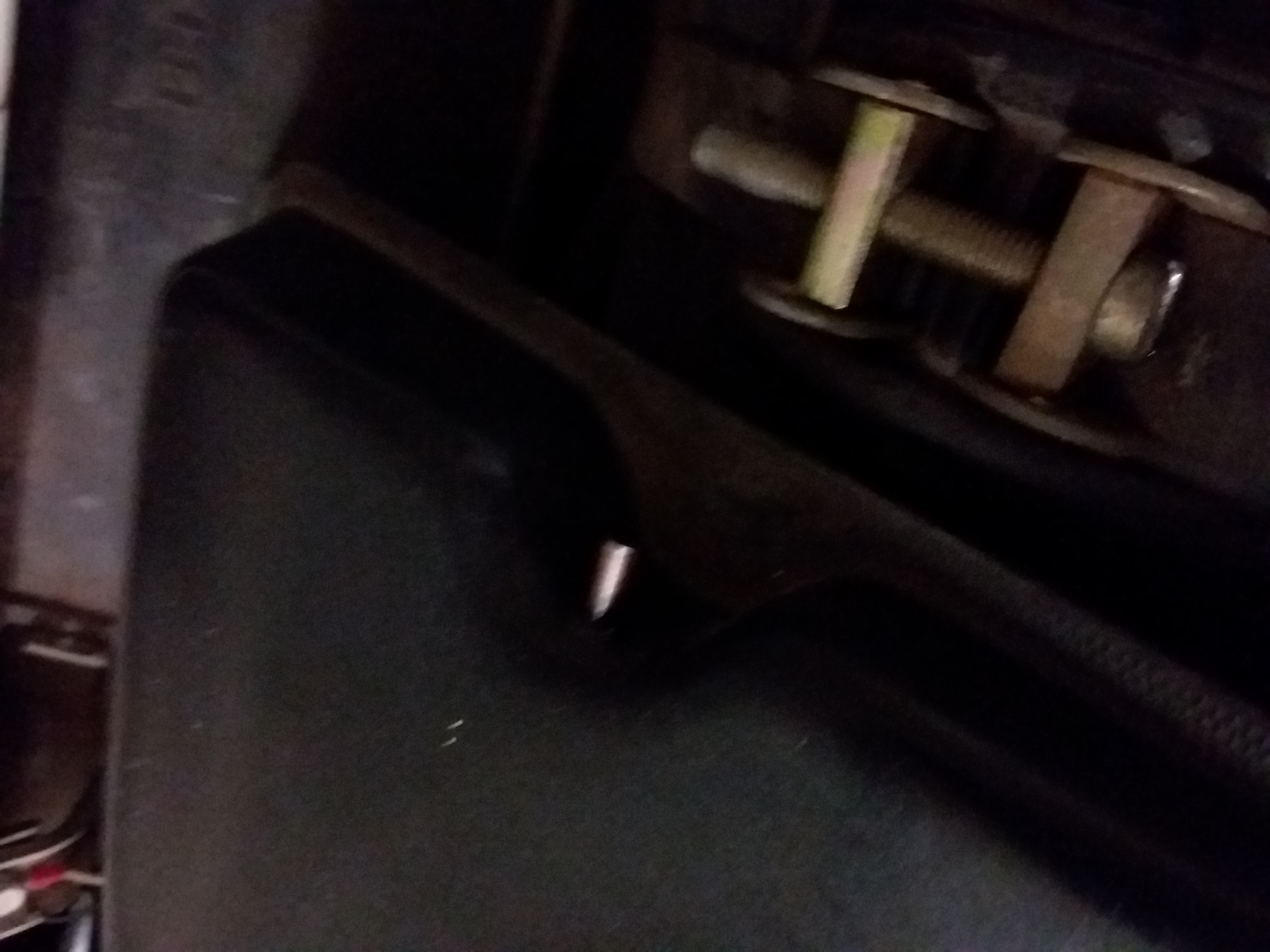

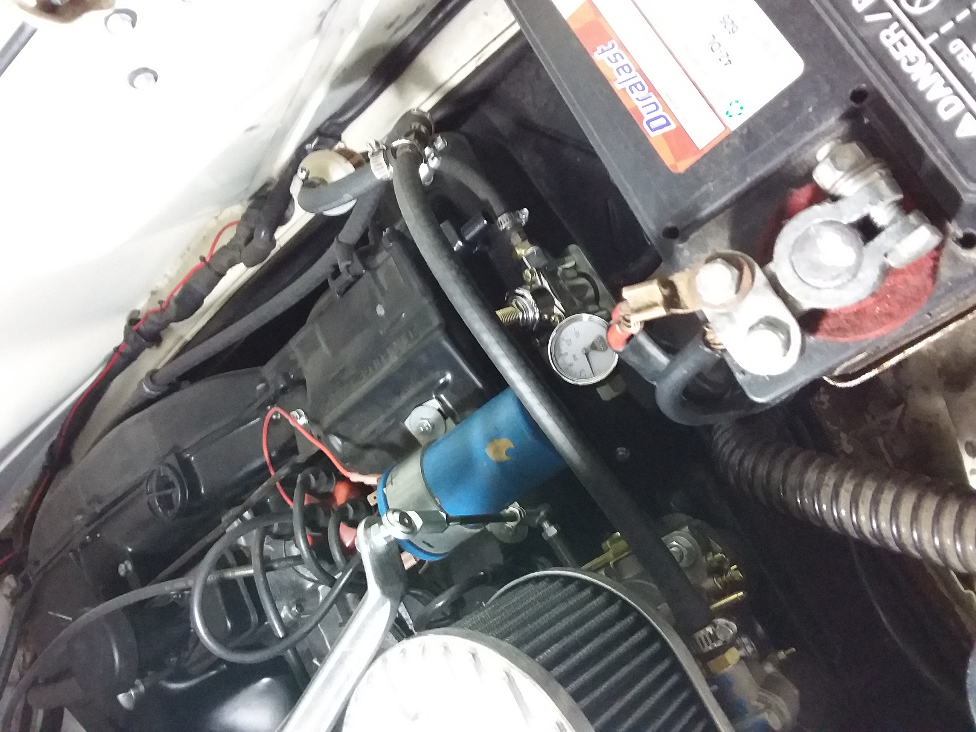

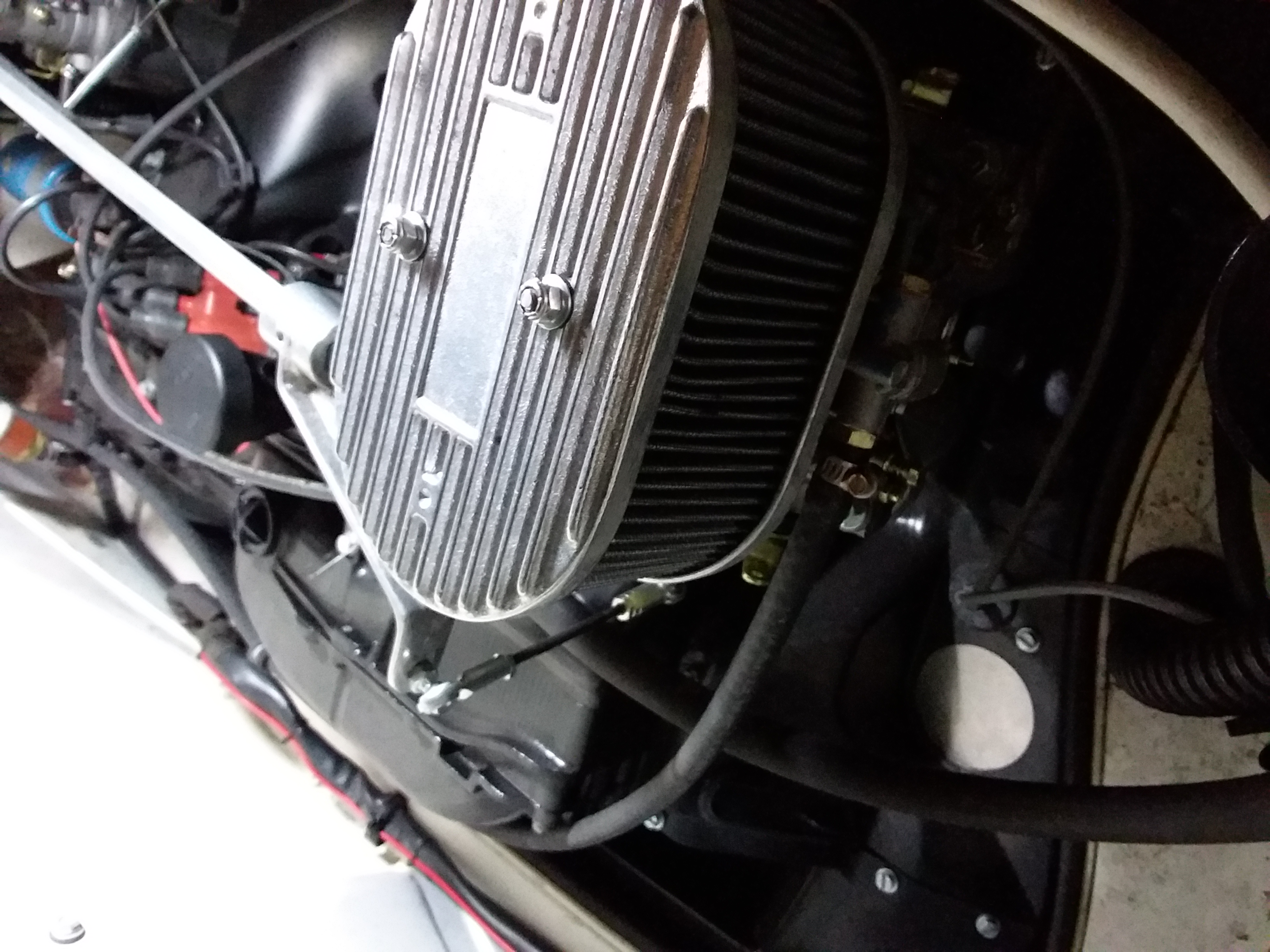

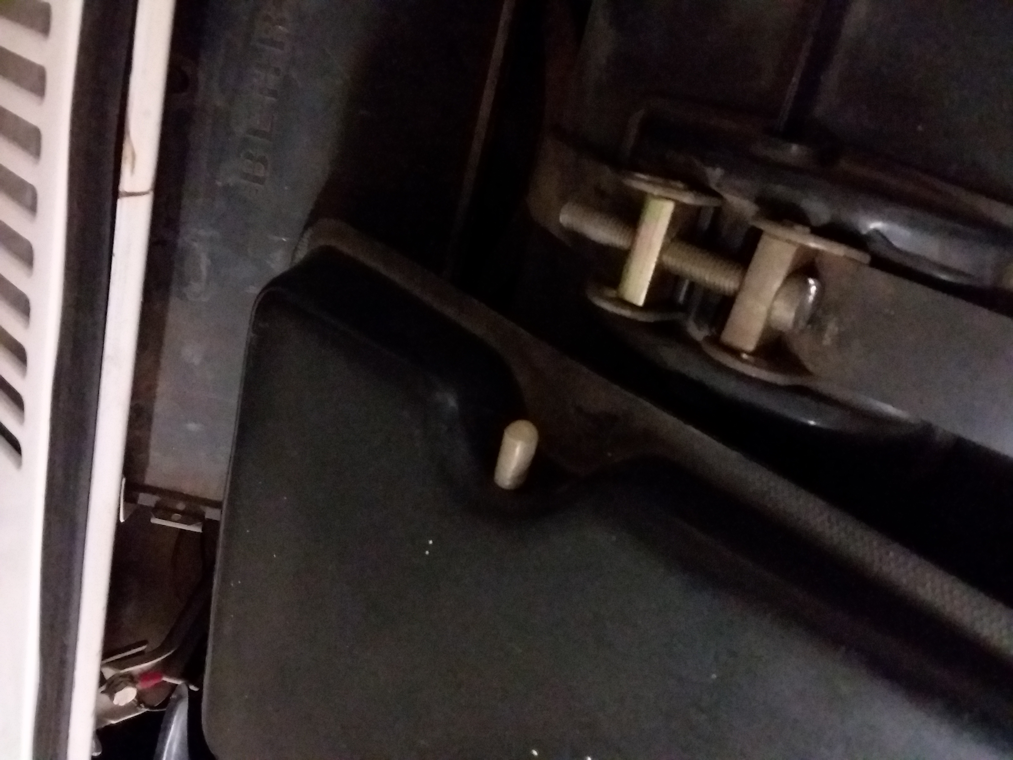

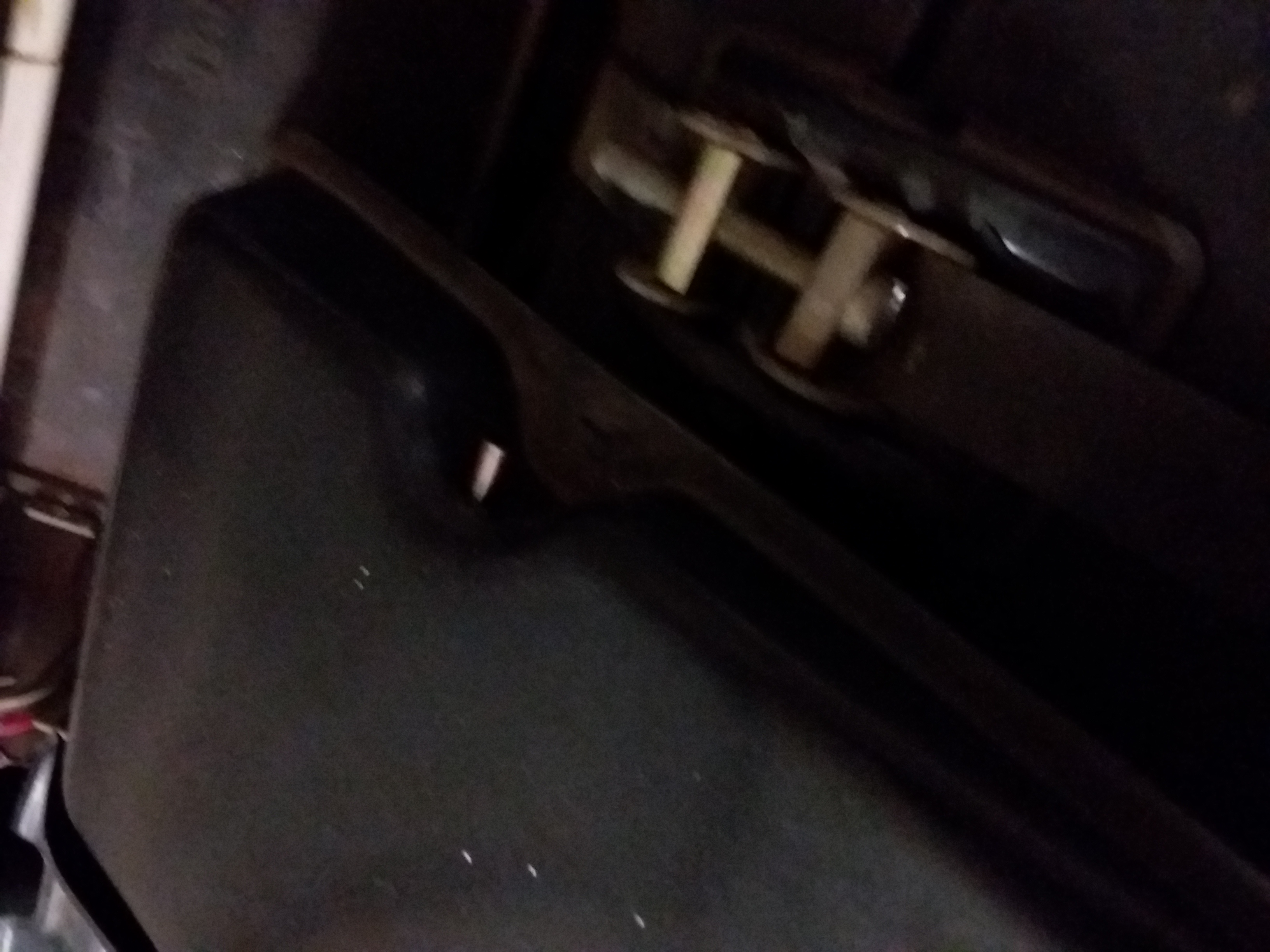

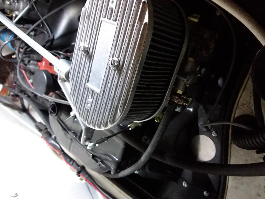

Here's some pictures. 2 pictures show plugged and unplugged on expansion tank. That made it a lot less dripping to butterflies on carbs after a good 50 mile run. The other pics show fuel lines and pressure regulator which is at 3.5 lbs. Attached ImageAttached Image

All the fuel line routings look sensible.
The plug on the expansion tank is an odd clue. It suggests the fuel tank is building pressure after shutdown and putting some slight pressure on the fuel line but honestly I can’t see how that would overcome the float needle valves.
Are you absolutely sure the float levels are adjusted properly?

Have you tried adjusting the fuel pressure to say 3 psi ,looks like you have the regulator screwed right out from what I can see.
You are using the correct model regulator ? the one you want is Holley 1 to 4psi model 12-804
I bought a aftermarket Weber kit some years ago and the carb flooded even @ very low pressure,had a no brand needle and seat so I replaced it with a genuine Weber one and problem solved.
