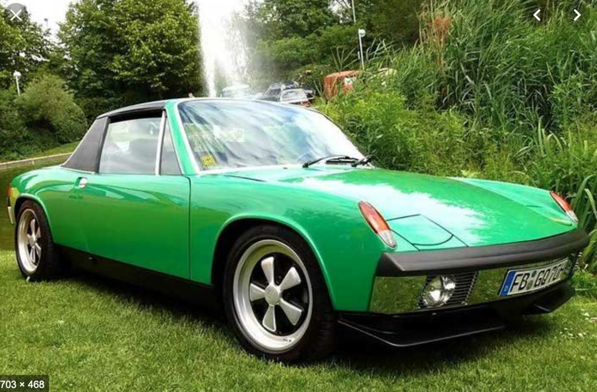

It looks like the rear fenders have been pulled on the green car. Probably 7" on the rear of that one.

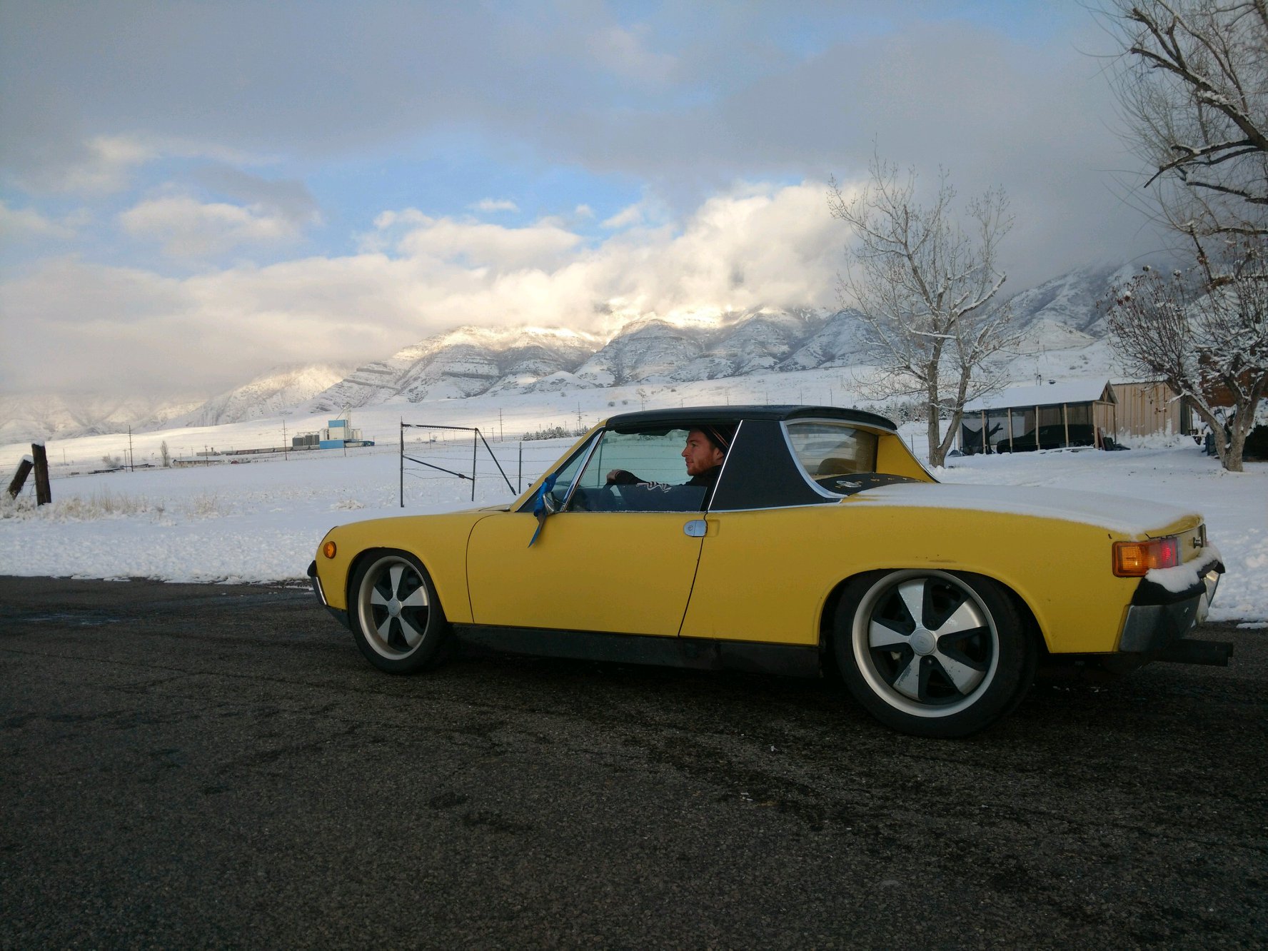

Mine are JBW (John Brown Wheels). An English company but I believe the wheels are made in China...
(IMG:https://live.staticflickr.com/65535/48095019317_3377ce5d62_b.jpg)
15 x 5.5 5" backspacing. Any wider, even messing with the offsets, and you may start to have clearance problems (depending on your tire choice) especially if your car is lower than stock.
(IMG:http://www.914world.com/bbs2/uploads_offsite/live.staticflickr.com-20876-1570202871.1.jpg)
(IMG:http://www.914world.com/bbs2/uploads_offsite/live.staticflickr.com-20876-1570202871.2.jpg)
CIP is running them now on sale for $99 each no tax no shipping charges.
Tires are 195 65 15. That is about the biggest you can fit on a 5.5" wheel safely. A 195 70 15 would be the same height as an original tire so no speedo error, but not as sporty.
You'll also need caps and lug nuts. The black lugs look better (IMHO), but are tougher to find and more expensive.
The redrilled front and rear rotors, redrilled rear hubs, and studs can be done many ways. Watch for sets (or partial sets) here if you are on a budget.

I think this car has 8in 951 wheels in the back. Crisis at Tangerine racing make rear flairs like those.
The car would look very close to that with rolled rears with 7 x16in and 6 x 16in in front. Spend the extra for real Fuchs just in case you want to sell them later you will get all your money back

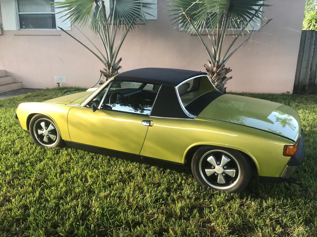

The el cheap-o way is to run adapters which are $100. It will be tight in the back. Buy the 15x5 1/2 empi wheels in chrome. Do not buy the 15x6, as the flower petals dont look right. I have adapters on mine for now but my wheels are OG.

QUOTE(type2man @ Oct 6 2019, 11:59 PM) *
such a cool color.... and in regards to the cheap version - I could be into that as well - so many decisions....
