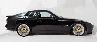

If I get one, BBS wheels will the next purchase. (IMG:style_emoticons/default/smilie_pokal.gif)

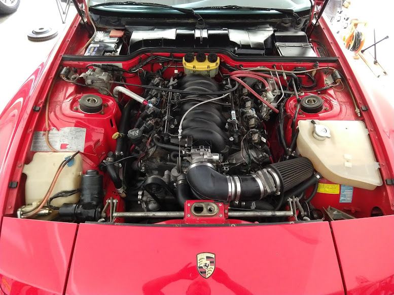

get a V8 (IMG:style_emoticons/default/evilgrin.gif)
