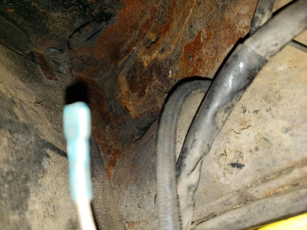

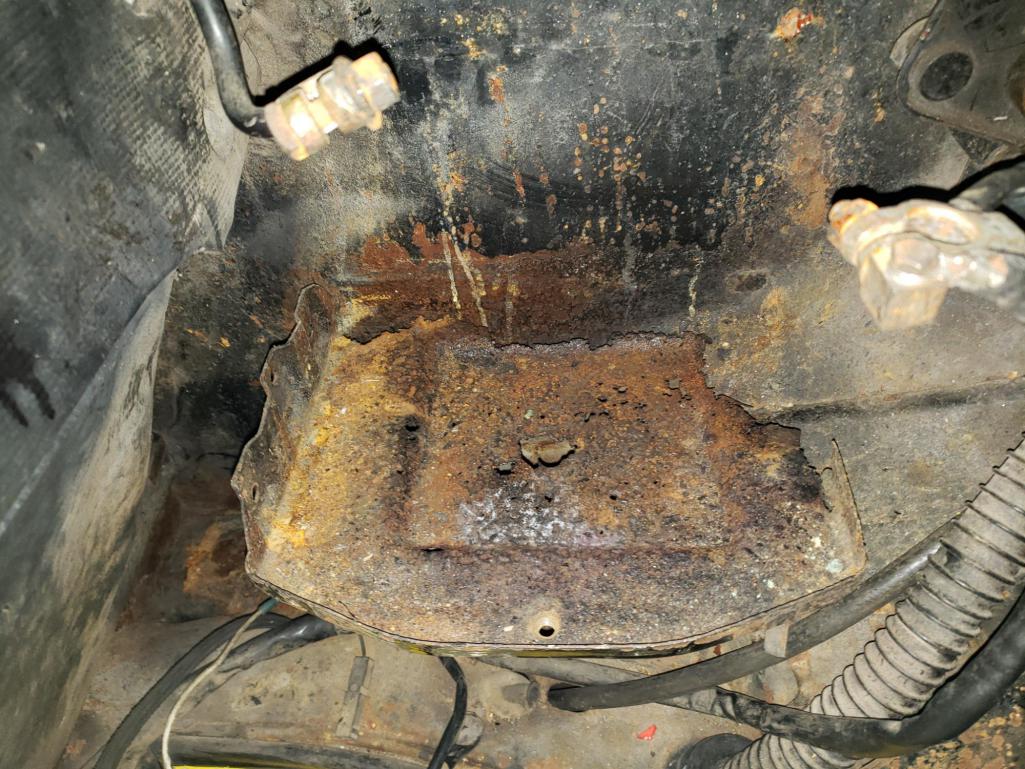

Well there is a little rust hole in the hell hole. Didn't start poking it to see how weak it is around it. So that is a bummer. Battery tray most likely has a hole. Was a metal inset int he bottom of that I also wasn't able to see below the battery. I'll pull the rockers off this week & make sure it isn't a ton worse. The jack post looks & feel solid. There are no holes in the bottom. Both front & rear trunks are in great shape with no rust. I'll try to post some pics of the interior. There is one aftermarket gauge in the center console. Turned the motor over a few times just to see. I'll spray some carb cleaner in the top of the carb. See if I can get it started & see what issue the motor had.
Overall still happy with the purchase. I figured I would find some rust eventually. Seems like I do remember seeing that small hole when I committed to buy it. My memory sucks. LOL!

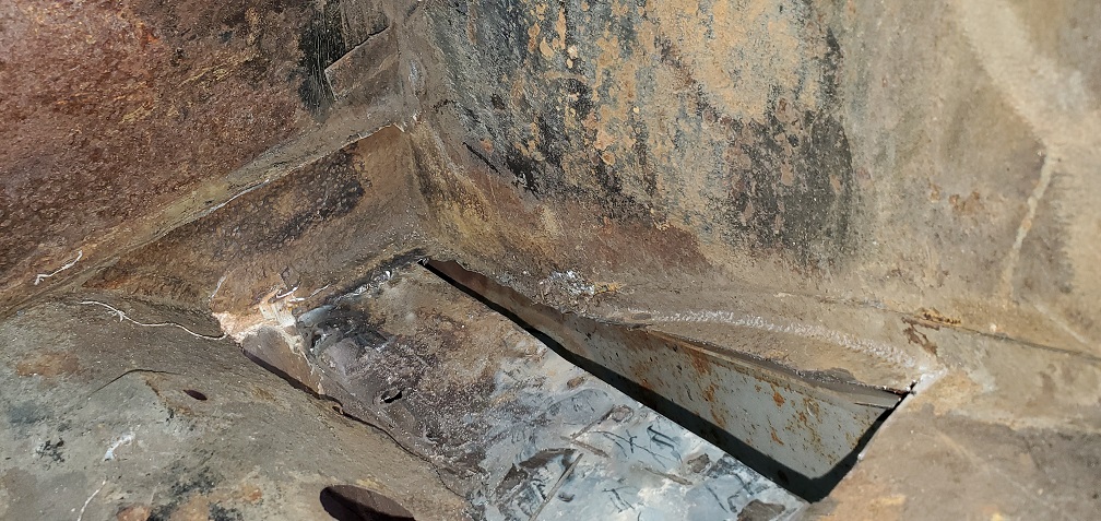

Well battery tray was worse than expected as is the hell hole. Definitely will need some work. Longitude looks good as does the jack point. Still worse than I anticipated but far from catastrophic.

Looks like your going to keep the rust from gain a larger foot hold. Please pull the back wall mat. They could be a nightmare in hiding.

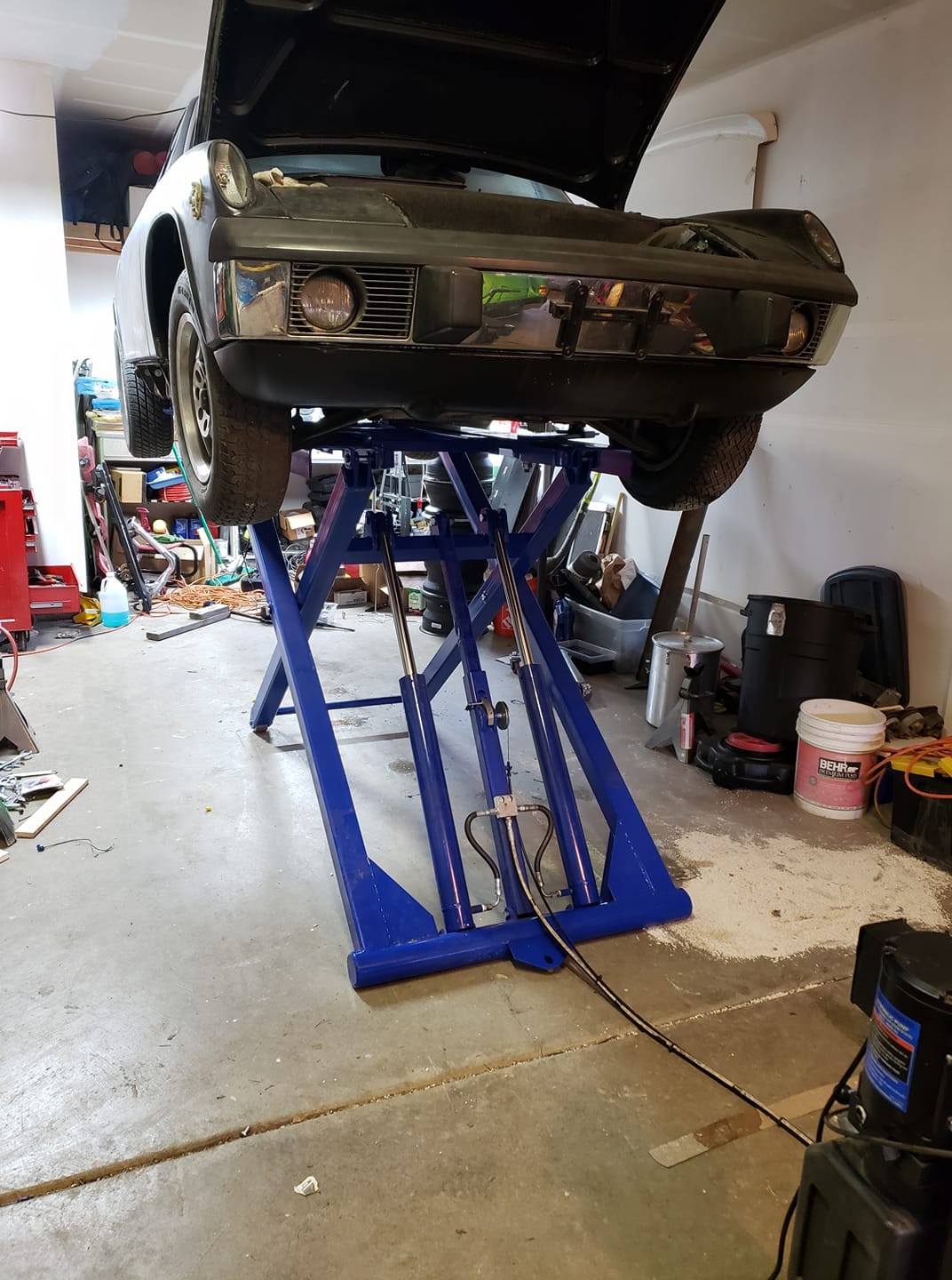

Okay I haven't made any progress the last month. I did manage to pick up a mid-rise scissor lift last week. Finally got it in the garage & under my car. I'll drop the motor tomorrow afternoon if work doesn't screw it up. So glad to have a lift again though. I do need to get a 220 plug added in my garage. It works off 110 but is a struggle

JRust - I thank God everyday for making a residential mid-rise scissor lift (mine is a BendPak). It makes being in the garage working on the cars a true joy. Laying on the ground is for the young guys, that's for sure. My knees and back just could not take it anymore.

Absolutely. I had a bend pak previously. Didn't lift quite a high as this one. WAs a bit smaller end to end so guess that makes sense. I got this one off FB for 1k. It's a harbor freight one but I like it overall I think. I need to see once I get the 220 hooked up. It struggled off 110

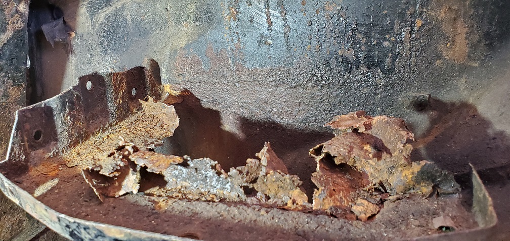

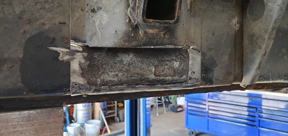

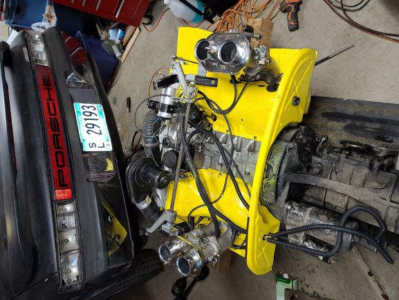

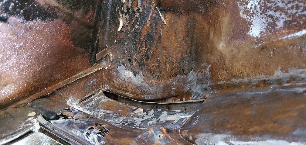

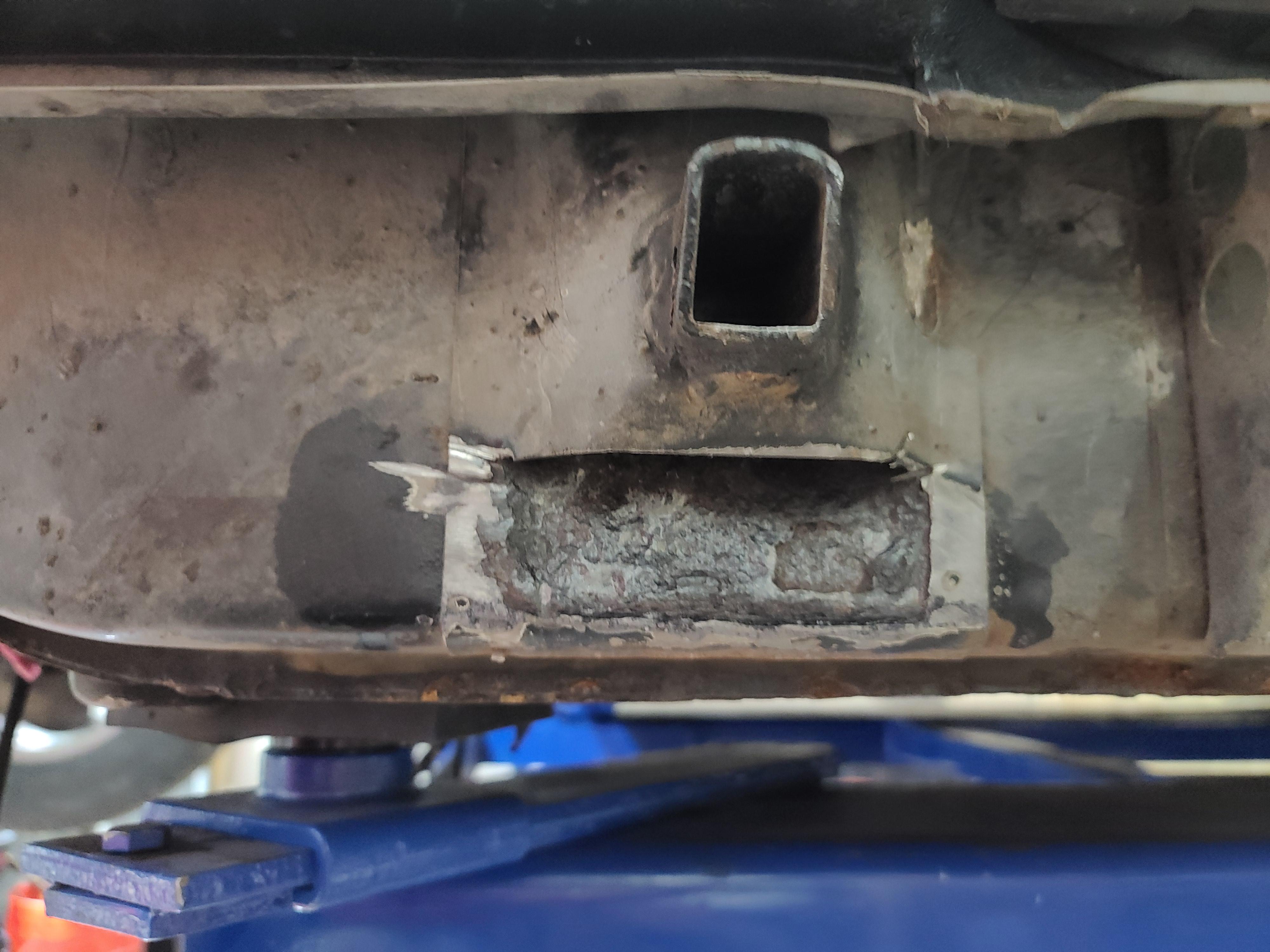

Finally got a bit of time today. Got the drivetrain dropped without a problem. Hell hole had a small hole. Was fairly thin by the firewall & I pulled out the thin stuff. It's about an inch wide & 3" long. Also my jack post itself was solid but the mount had near the bottom. I cut out the outer portion & definitely some rust through. Figure I need to cut into the long a bit to take out the rusted section. Really is solid above. Really debating completely stripping this car to bare metal. Just hate to do it. The bottom of the car is in great shape. Other than the bit of hell hole. I've got just a bit in the front trunk channel the seal sits in. It will clean up though.
I really was hoping to just shoot the outside of the car & maybe the trunks. Didn't want to remove the interior at all as it is so nice. Seems like removing them sometimes i get cracks that were never there before. Door jams are all good as well. Anyway take a look at the carnage

Yeah did that & I am good. Also the firewall is good. Engine pad out & there was just a bit of surface rust on passenger side in engine bay. Probably more glue from the pad than actual rust. Cleaned up fine. The wall by battery tray is still really solid. Just the hell hole which certainly could be worse. It's worse than I can see inside I am sure but I think it will be smaller patches to fix. Not a big section of the longitude.

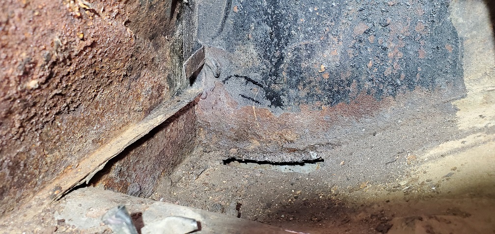

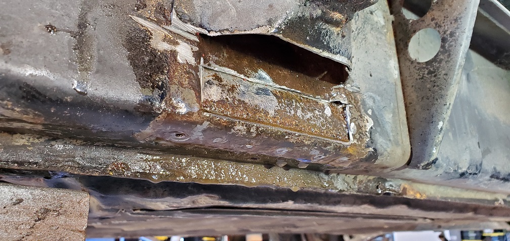

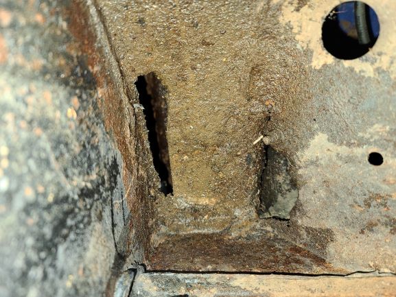

I concur with Jamie this is the best virgin hell hole I've ever seen. Yesterday I thought
it had been done before. But once I could get in close. What I thought was a cold weld
was a wad of seam sealer. (IMG:style_emoticons/default/biggrin.gif)
BEFORE :
AFTER CUT OUT :
DOWN INTO LONG :
AFTER MORE TRIMMING AND SERIOUS DOSE OF OSPHO :
