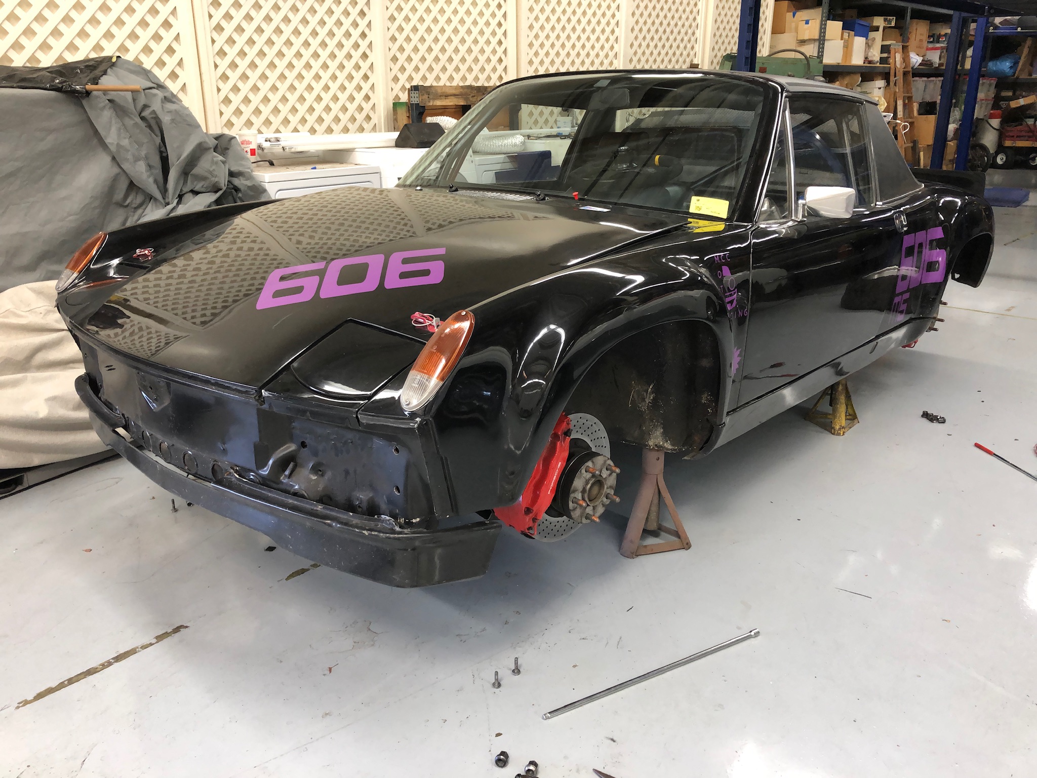

Only got 1/2 day in the car today, I have an appt to take it to Aase Motors in mid June, so I wanted to look at some of the other issues plaguing the car.
Font bumper off and brakes bled.... bumper is too tight to body work, hood overlaps the edge, so I gotta put some spacers or find some dog bones to offset. Front left didn’t bleed, looks like I’m rebuilding a giant caliper... that appears to be the hanging noise I heard on track.

Wow! Those brakes are huge!
